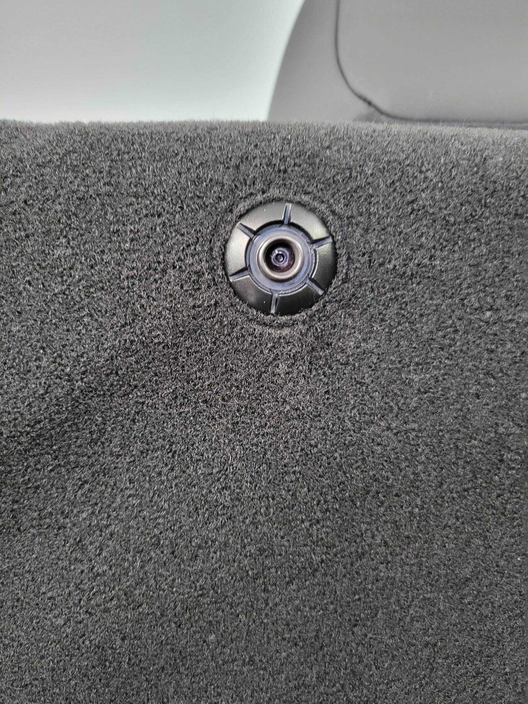

I bought a set of seat backs on eBay and the snaps on the back don't look like they will snap into place on the '22 BS seat backs. Any advice? Am I supposed to remove these black rings in order to install the seat backs? Did they change the size of the snaps on the seat backs from the '21 model to the '22 model? Does anyone have a picture similar to mine of how their '22 seat backs look compared to the snaps on the back of the '22 BS seats?
Ford Bronco Sport Rubberized seat backs IMG_6565

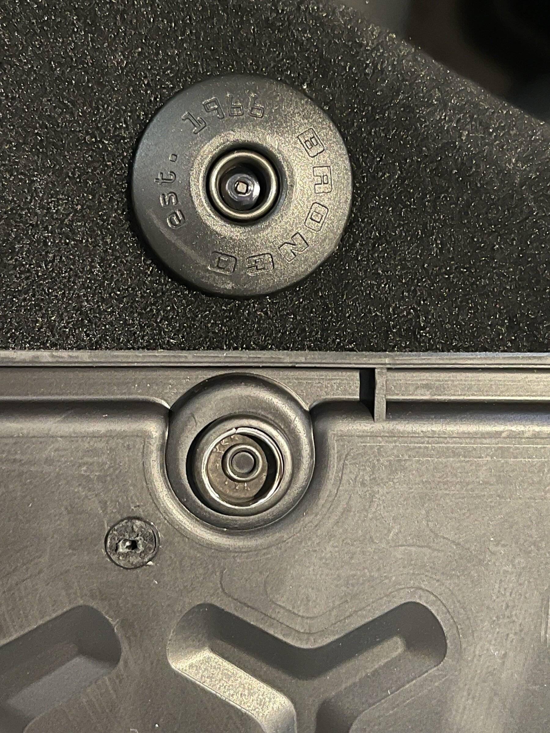

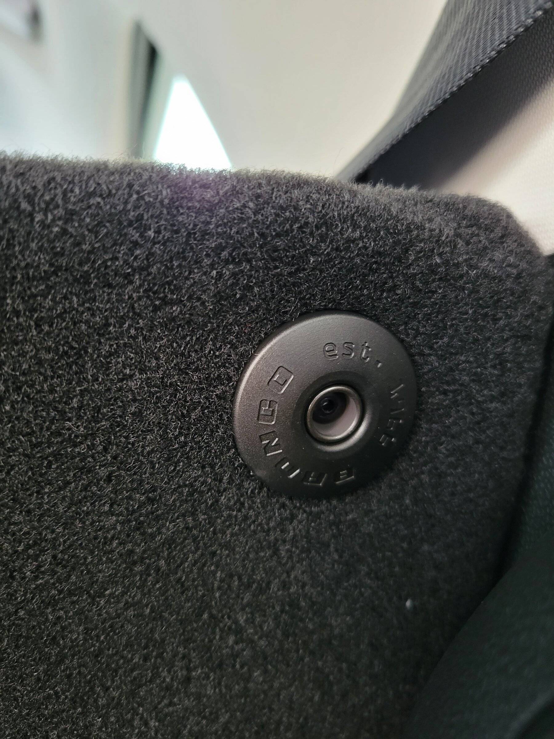

I finally got mine in today and can confirm you need to snap the plastic clips to access the buttons. See attached. Hope this helps! I was nervous but started with a bottom one in case I was wrong but I had a gut feeling it was under the clips.

I have a 2022 Big Bend which didn't come with the rubberized seat backs. There appear to be snaps on the seat backs, but they're surrounded with black plastic rings, making them almost flush. I ordered/received the new rubberized pieces, but they don't look like they perfectly match the snaps on the seats. I don't want to break anything. Any advice from someone who's done it would be much appreciated.
You will need to take those clips off. See attached. Got mine today and was confused until I had a gut feeling the actual buttons were under the clip. Started with the bottom one in case I was wrong lol hope this helps!

Thank You! I was at a loss. Without your instruction, I wouldn't have tried to remove those black rings. Having done that, worked like a charm. This is the kind of thing that makes this forum so valuable.
