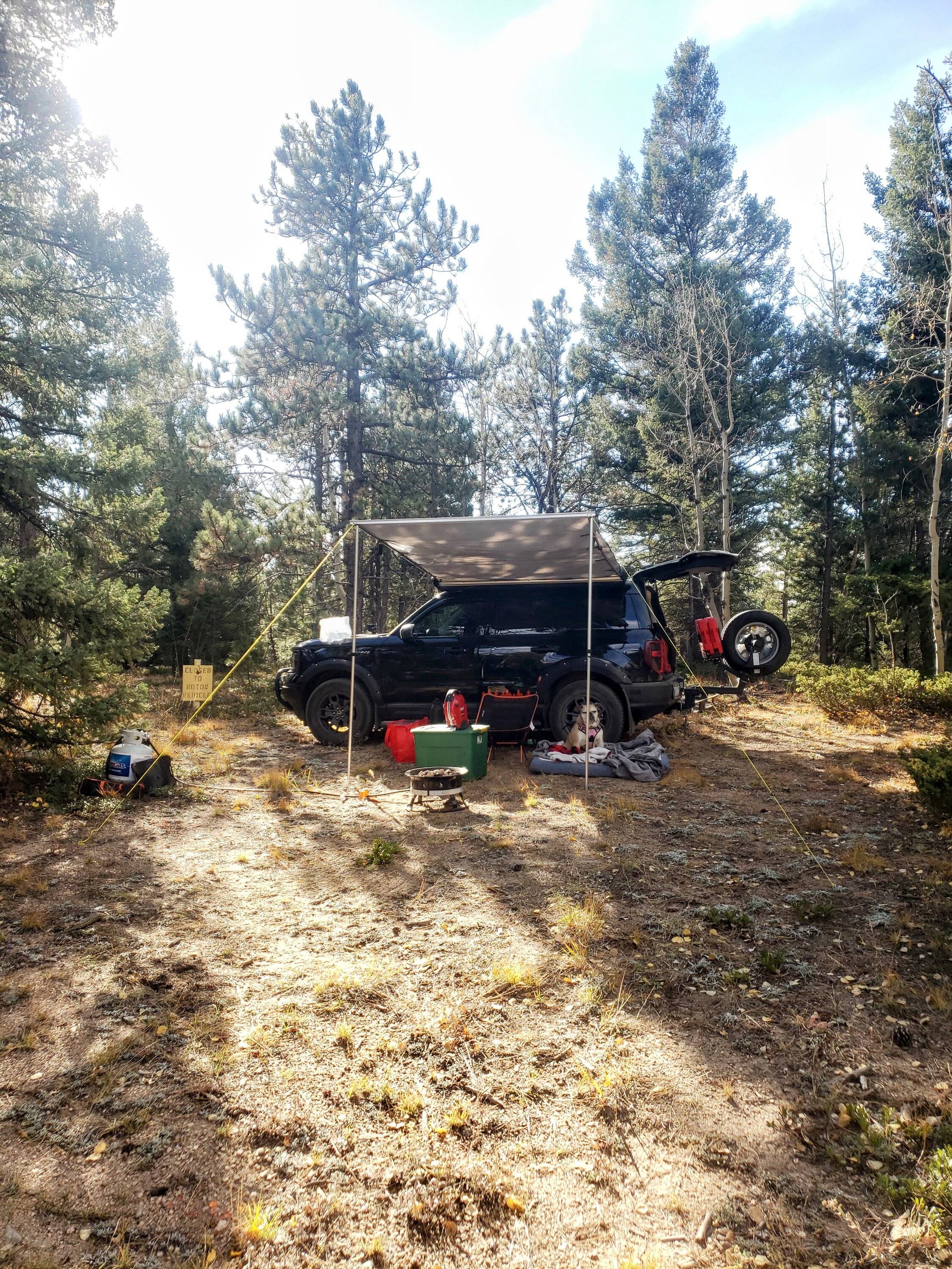

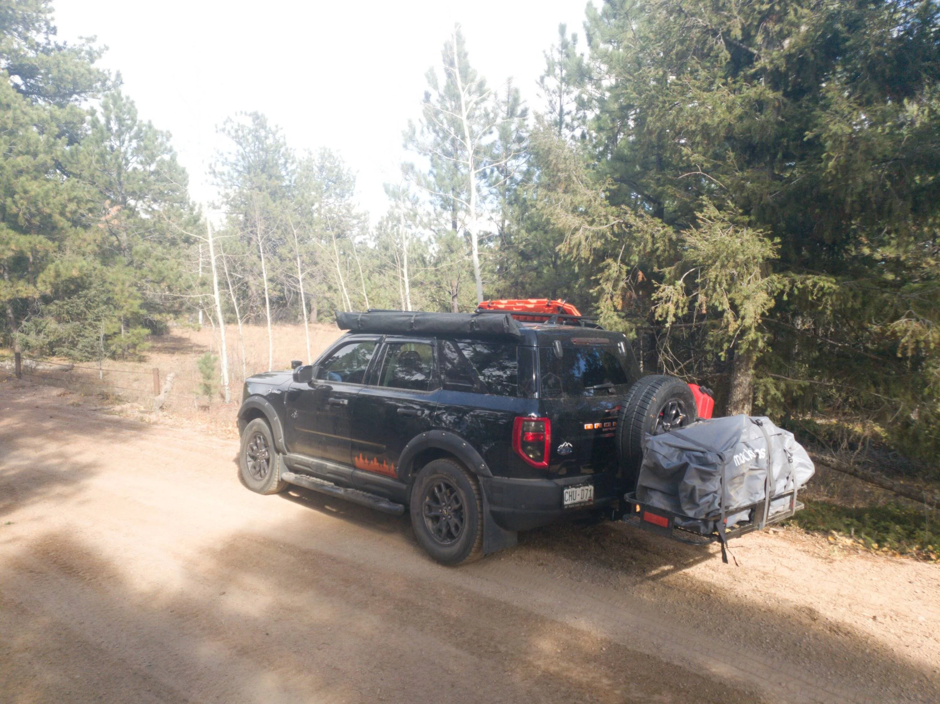

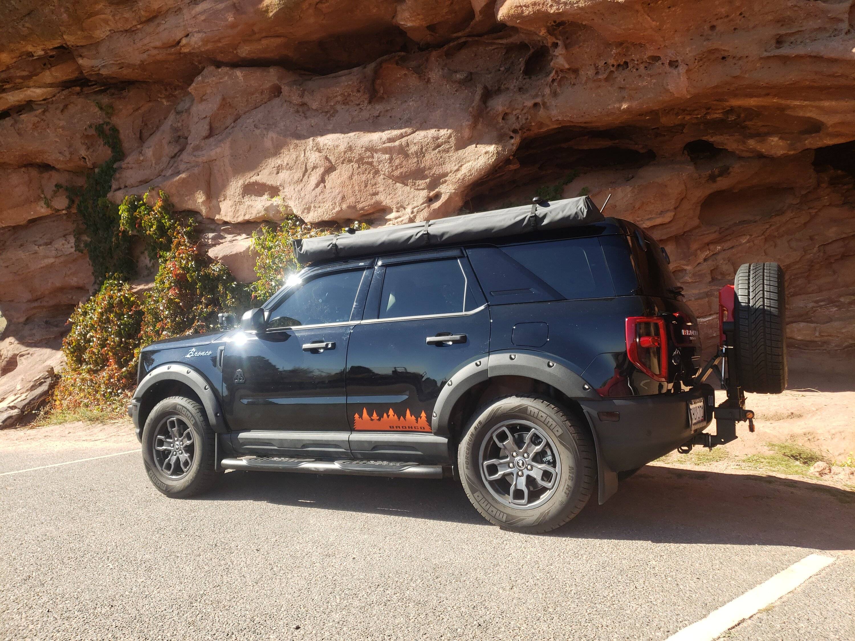

Hitch swing away spare by Wilco and full-size spare/wheel.
On top of that, I have a mount that attached two Jerry cans to the swing away. You can kind of see it in some of these pics.
I certainly need those springs in the rear.
(Flexing a lil with these photos. I had a blast with her over the weekend.)
