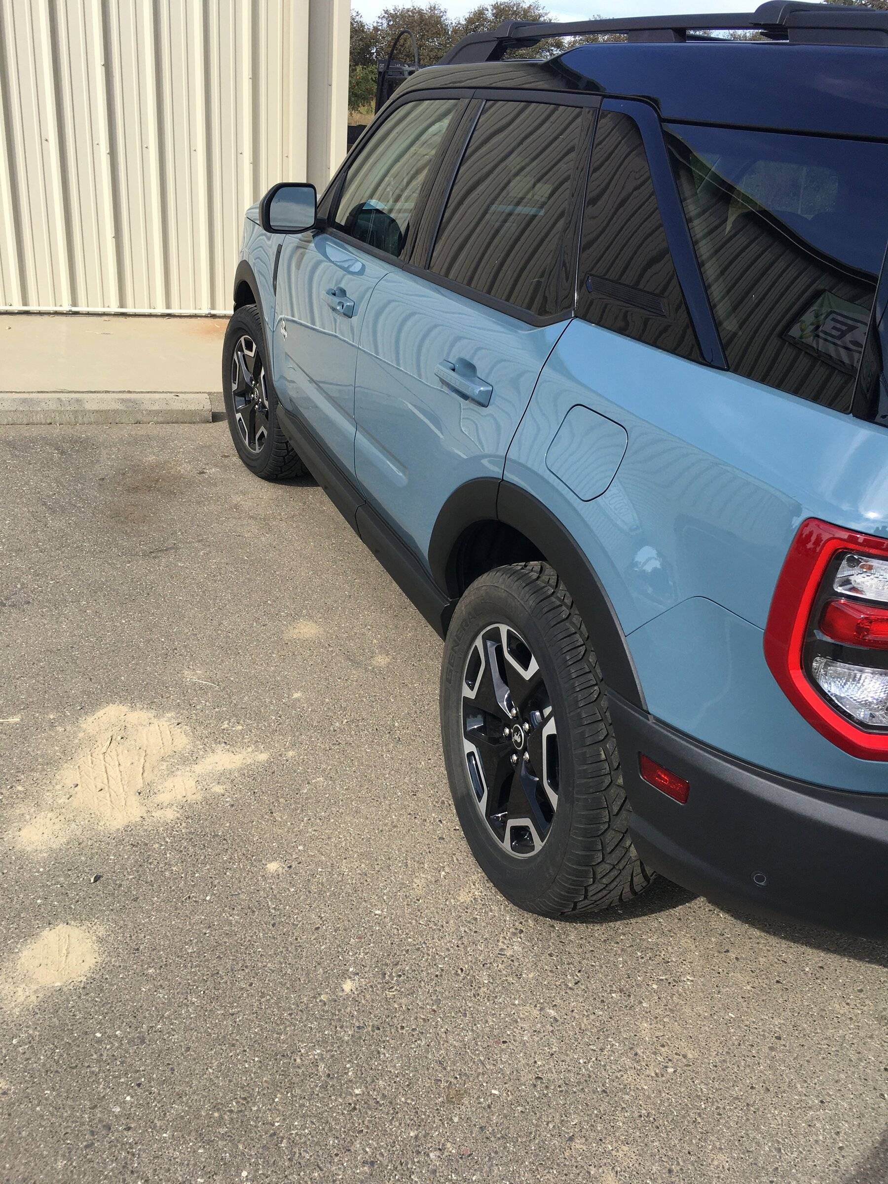

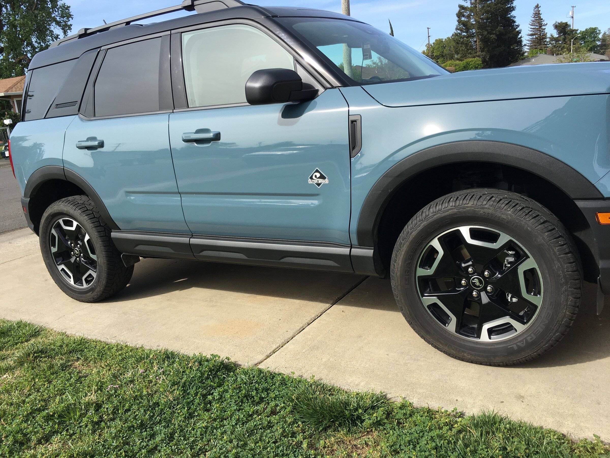

I installed the Rough Country 1.5" lift kit on my Outer Banks. It works very well. Rough Country sku: 40100. I have 29" tall 10" wide tires (255 55 R18). Next week I will have U-Haul install a hitch. Curt Class 3 Hitch 2" receiver sku: 13474.
Ford Bronco Sport Rough Country 1.5" lift kit installed Rough Country Lift 1.JPG
Ford Bronco Sport Rough Country 1.5" lift kit installed Rough Country Lift 2.JPG
Ford Bronco Sport Rough Country 1.5" lift kit installed Rough Country Lift 4.JPG

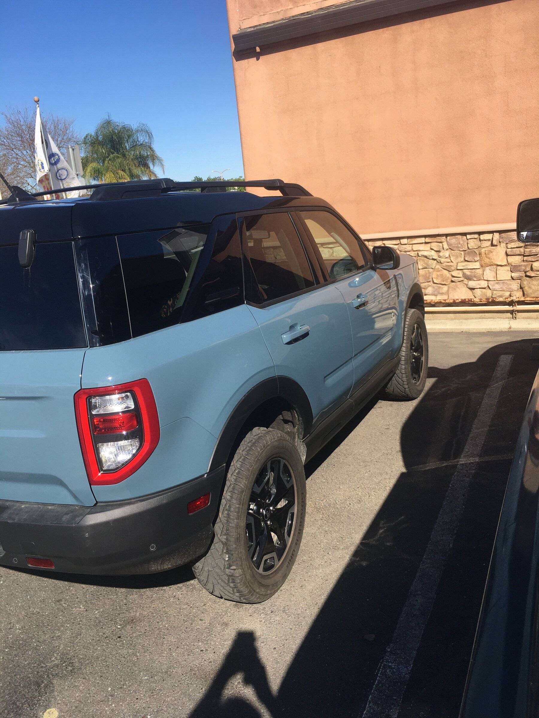

Did you take before and after measurements from the ground to the fender lip?
No. I did not think of taking any measurements. Guess I should have. Here is a before photo for comparison.

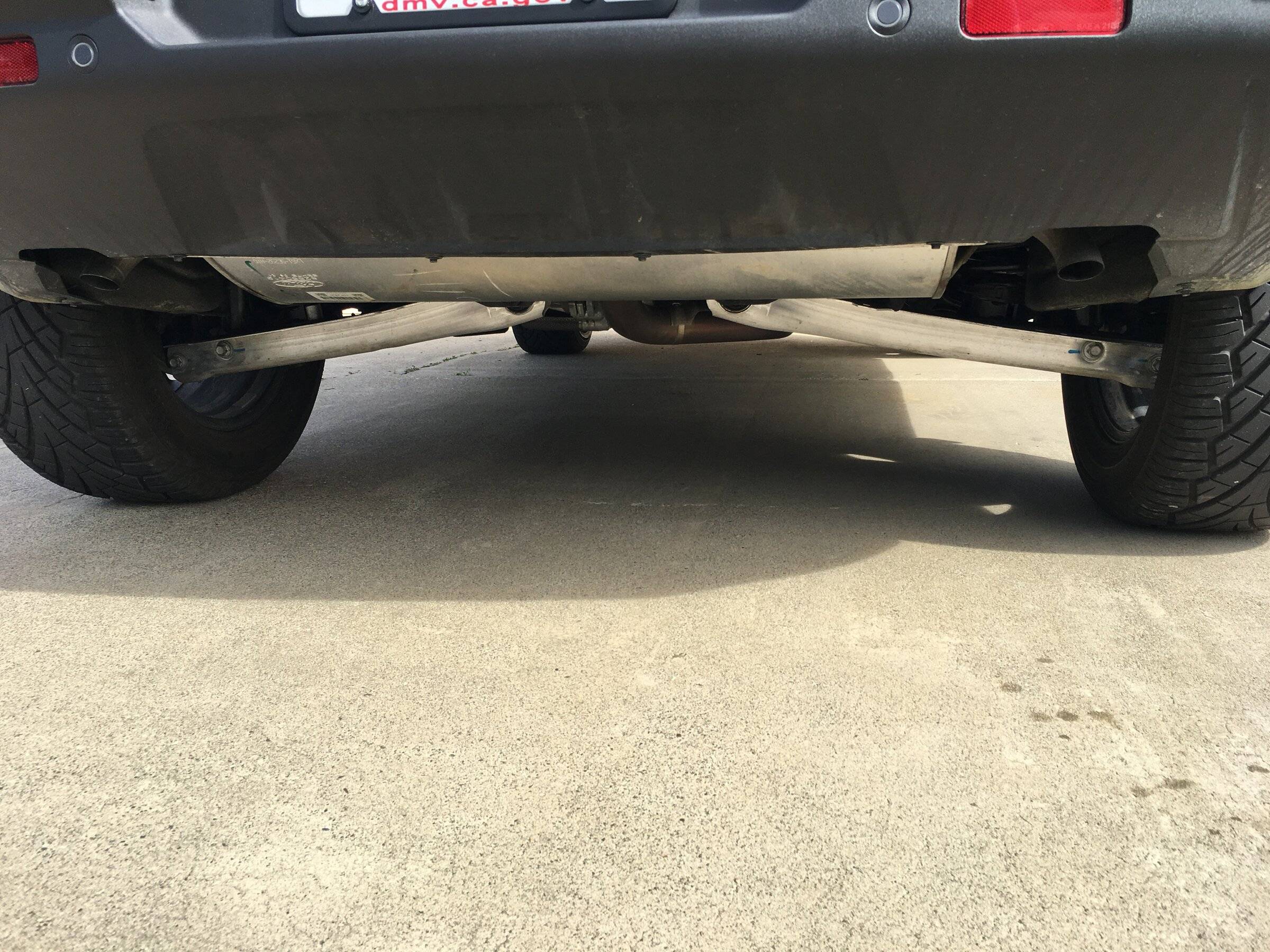

When you get your hitch let me know how you like it. I need to get one and haven't decided if I want to have Ford do it or not.
I had my hitch installed at the U-Haul service center in Vacaville. The guy did a great job and it was only about an hour to put it on. It looks like a factory install and no indications he took the back facia off to do it. My local Ford dealer, Elm Ford, service manager refused to take on any after market parts installation. In fact he was rather rude about my even asking if they would do the work. No going back there for even an oil change.
I had U-Haul put the hitch on. Took only a couple hours. They used the 4 bolt direct mount. Great installer, he made it look factory. I only do very light hauling with the OB.
