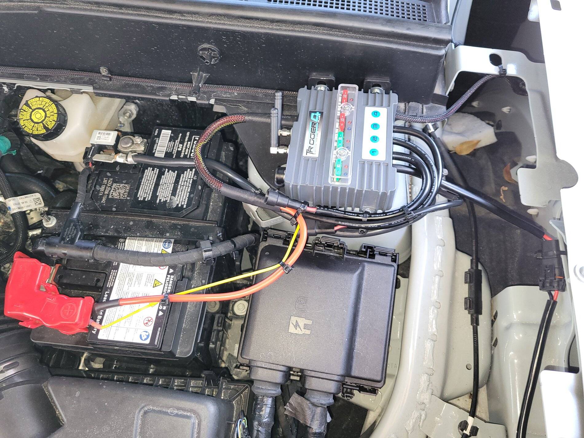

Take a look at the Trigger Series. https://triggercontroller.com/

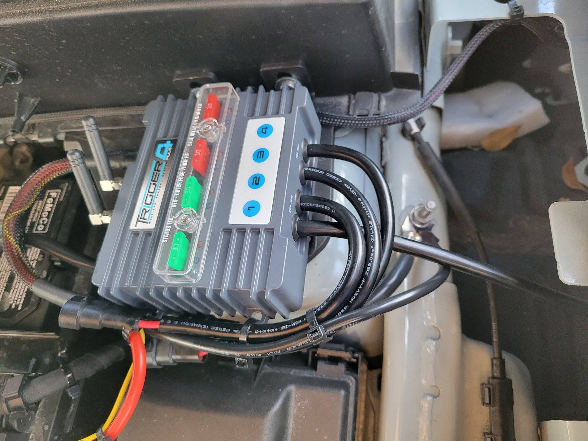

I bought the Trigger 4 Plus https://triggercontroller.com/trigger-controller-4-plus/ for my BB after installing the nudge bar and lights. Working on a stand to mount it under the hood now. Pictures to follow when I start the process. I've installed the nudge bar and one set of lights...waiting on the second set now (backordered).

where did you mount it and did you hookup the Yellow ACC wire to the battery or to a ACC wire?

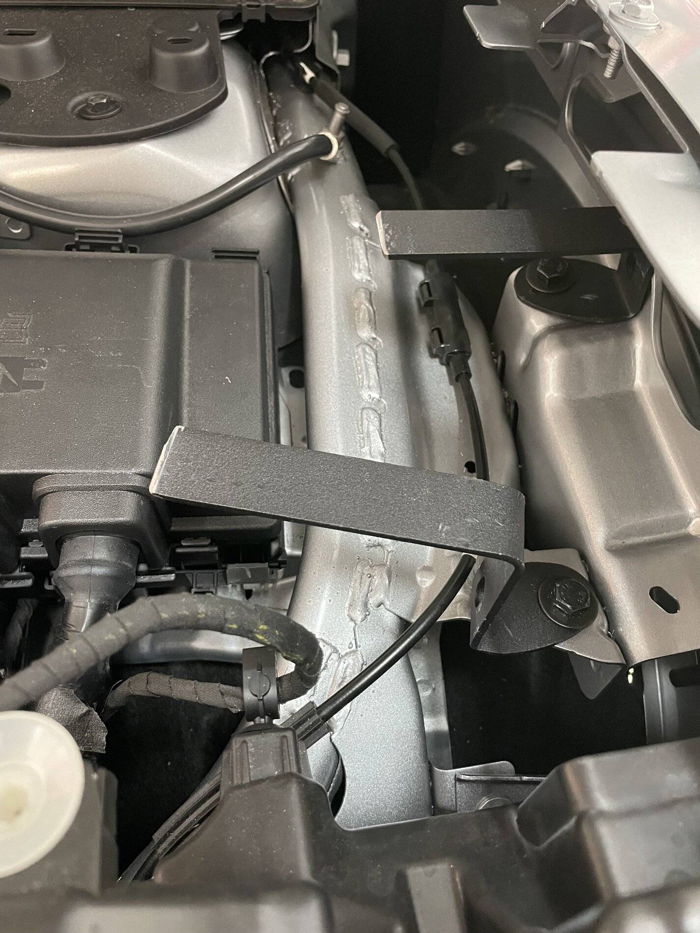

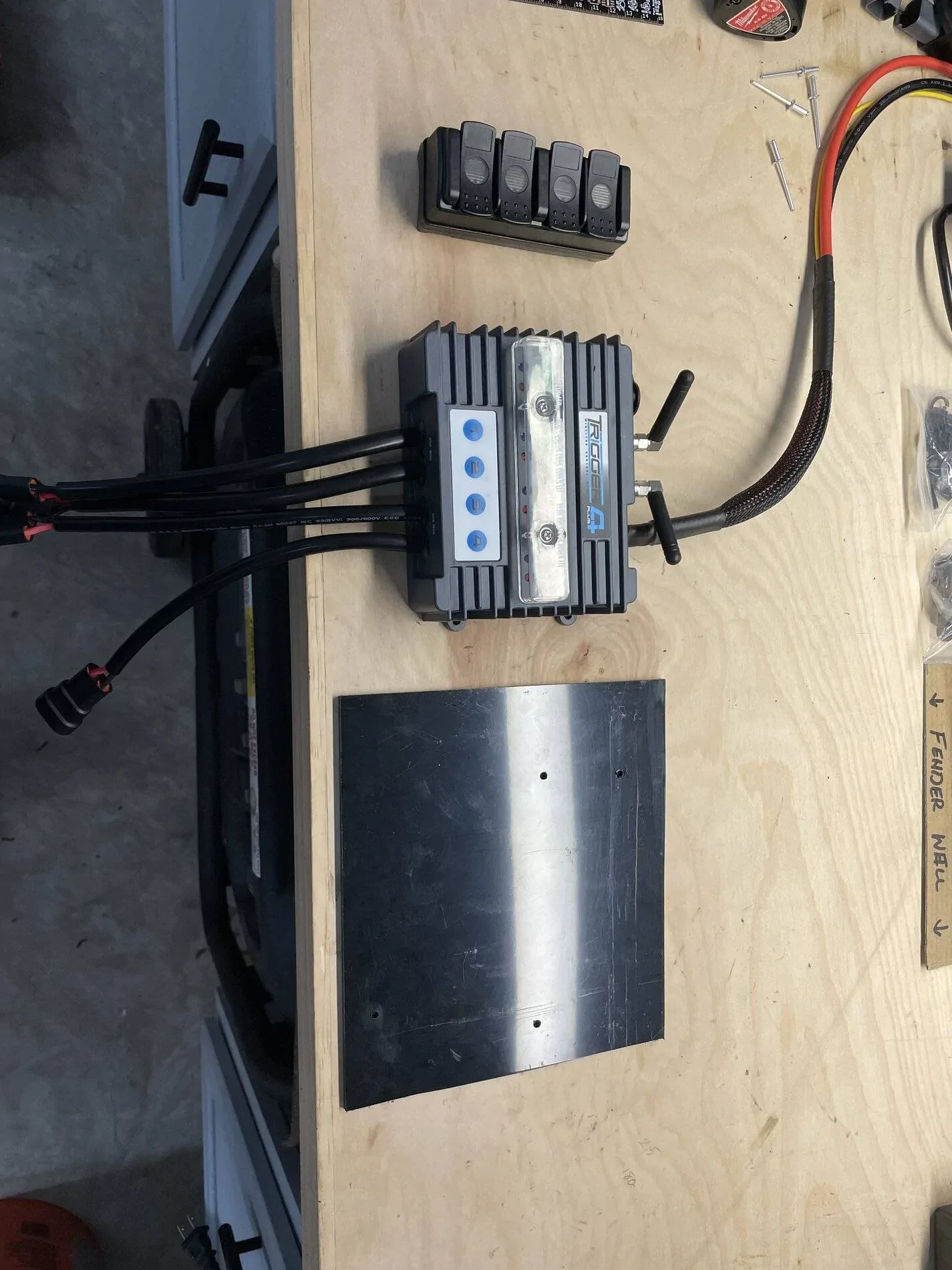

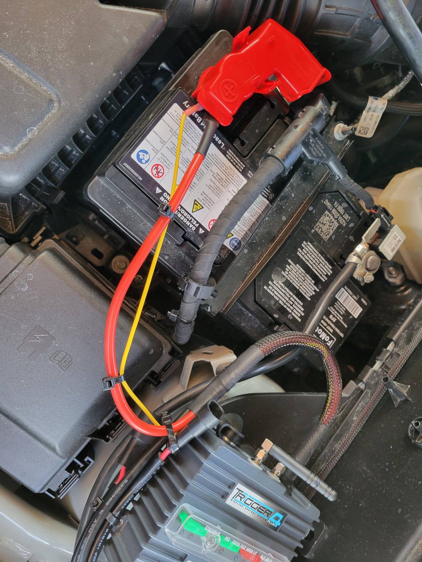

I installed two brackets on rubber isolation mounts to existing holes already in the drivers fender well. I also put a rubber bushing between the plate and the brackets to reduce the shock and vibration to the unit. This unit is heavy duty from the factory, but you never know. Originally I had it wired directly to the battery. I have since ran it to an auxiliary ignition point on the fuse box.

Which fuse did you use for acc wire?

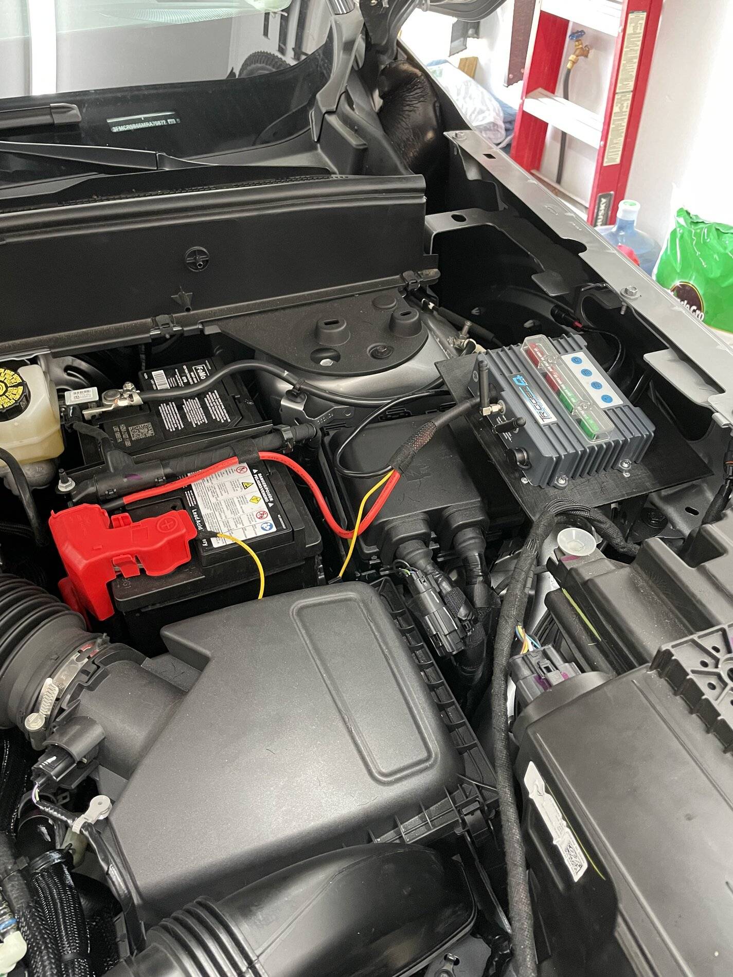

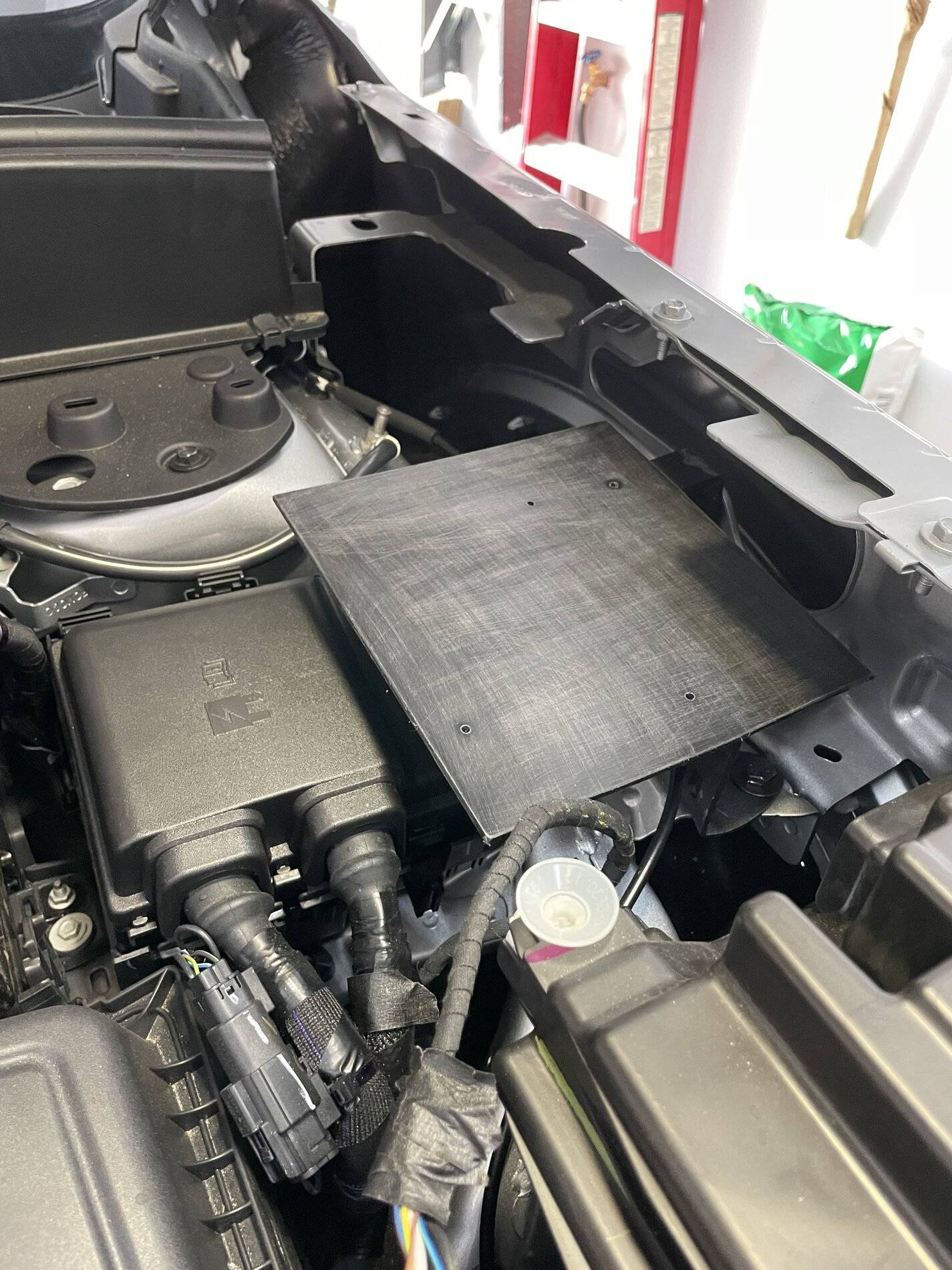

This was my final placement. Found some old brackets that fit perfectly. Decided to keep it always hot and wired it straight to the battery.

I'm in the same boat... did you still have the acc yellow cable) connected to the battery, is not killing the battery all the time?

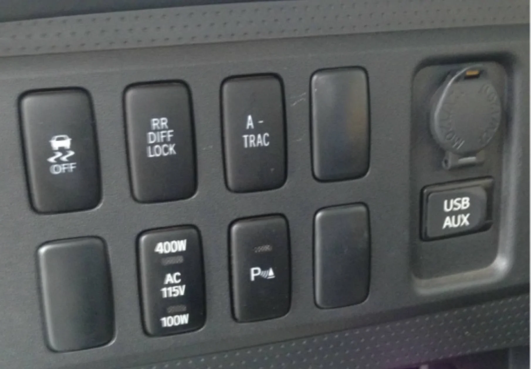

That is one thing I love about my FJ is that they gave “blank” switch in the dash where you could add the lights etc into the existing switch area.

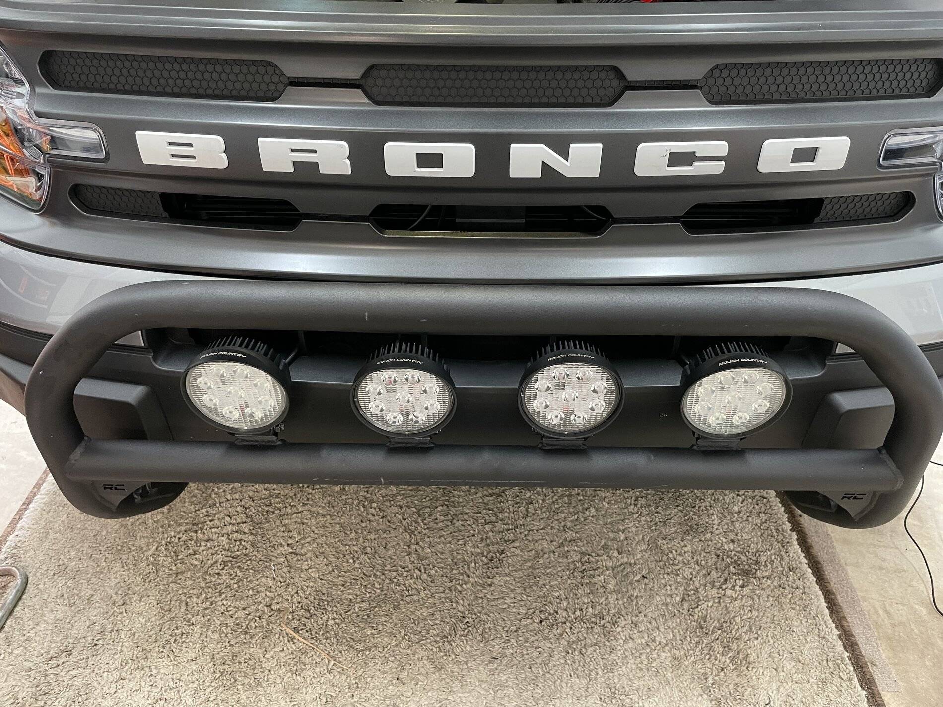

Jay - How did you wire the 4 lights to the Trigger 4 plus? Are they all on 1 circuit or did you split them up? If you did put them all on 1 circuit what/how did you do that? I am debating between getting 4 lights like you or a LED bar instead.
