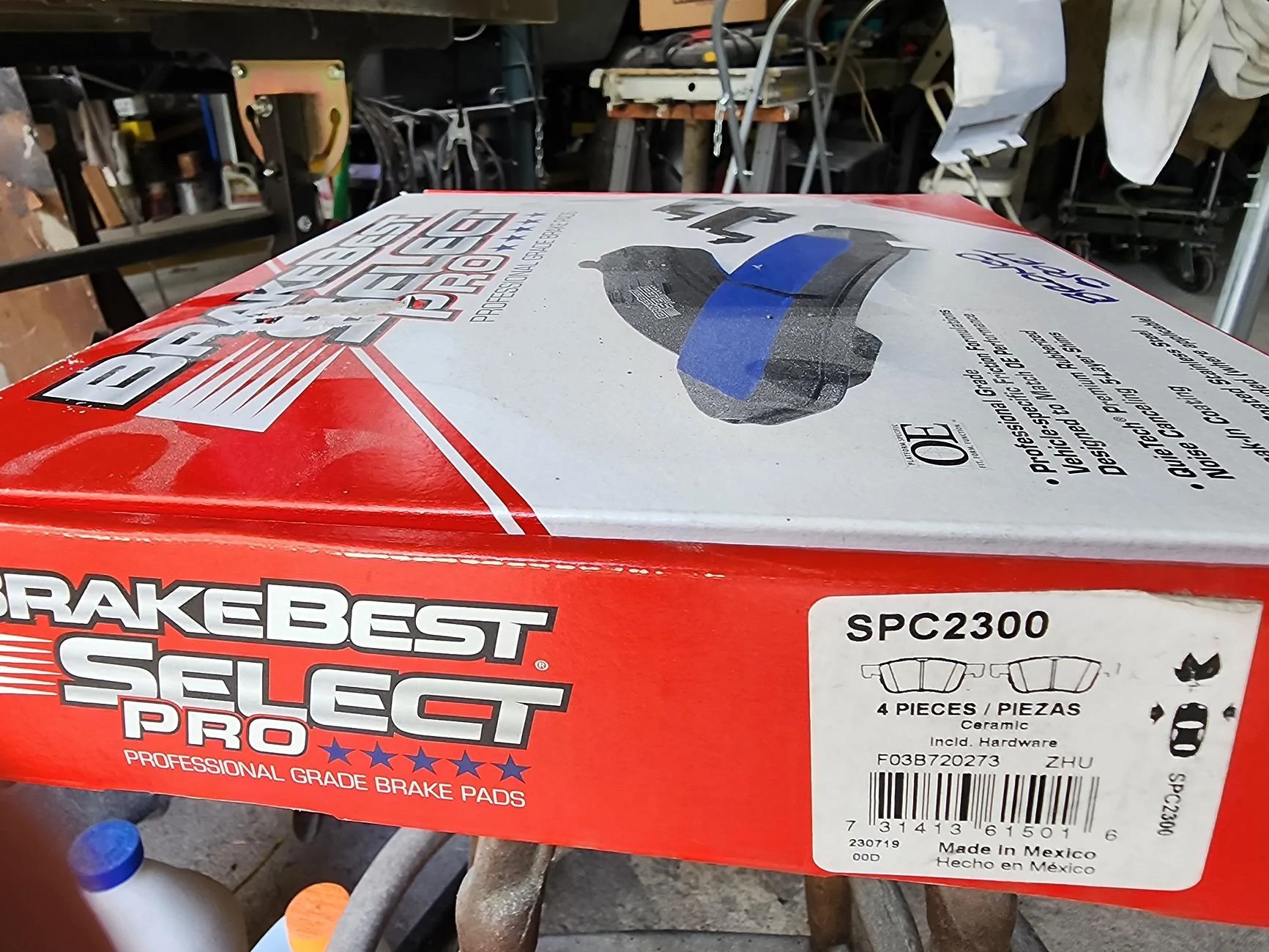

It's been 2months without ANY brake moan/howl/squeal when backing up. After all the Dealer TSB corrections it made no difference. Decided to just replace the pads myself. Went with the basic pads O'Reilly's carries. Added plenty of lube to pad/caliper contact points and slider pins. Was doubtful it was going to make a difference but it did! Fingers crossed that success continues into the colder weather and longer term. I'm sure my neighbors appreciate the effort!

Nope, just your basic off the shelf stuff. (They didn't have full ceramic)

I take that back....they are ceramic (see the fine print). The O'Reillys guy said ceramic was not available....got more than I expected!! LOL
