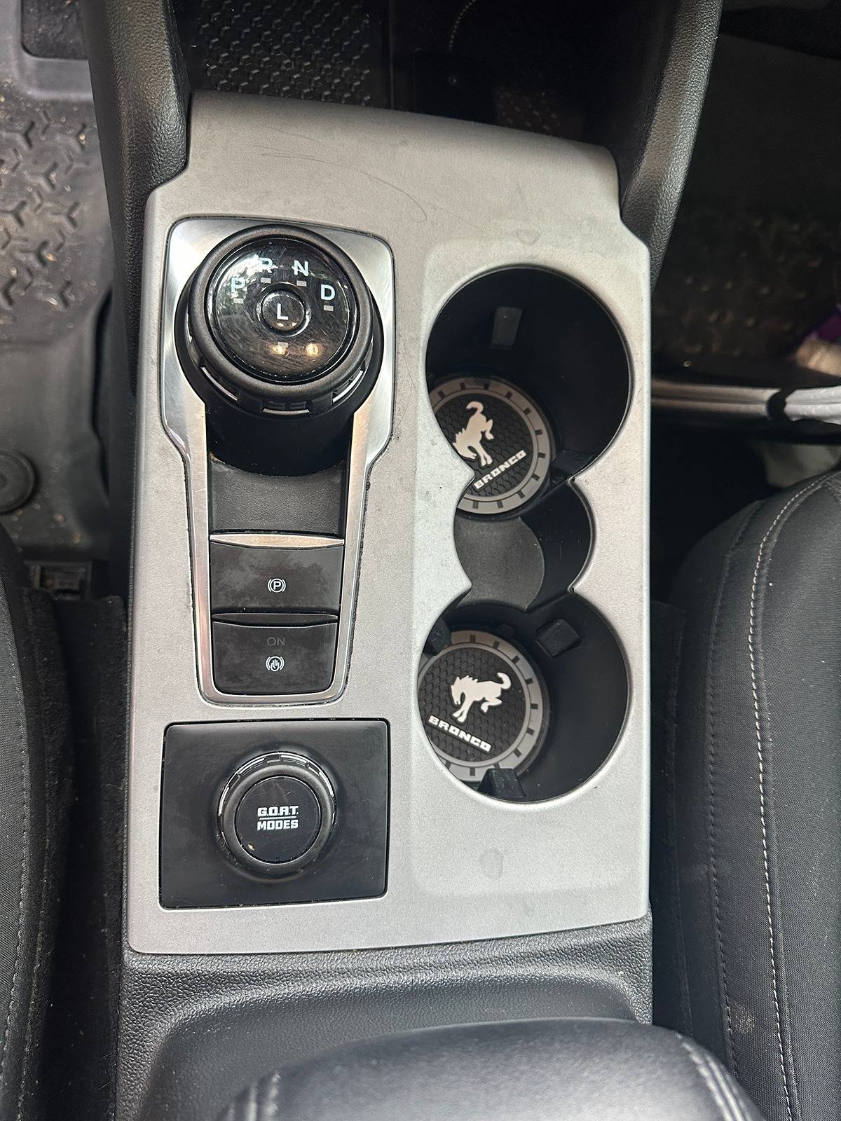

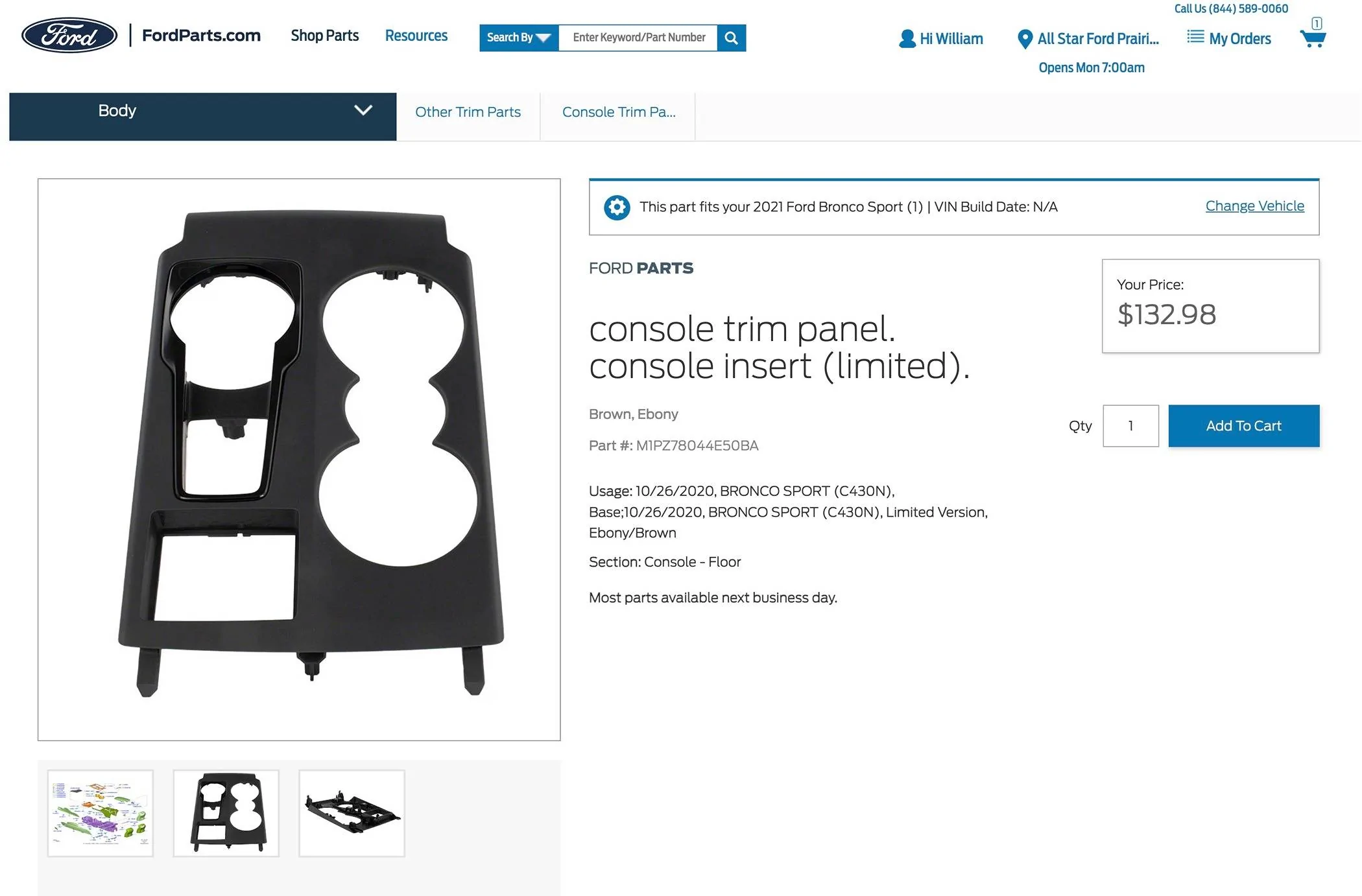

Has anyone tried to replace the center console cover. Got my BS BB used and the silver center console piece is scratched and wanted to make it look nicer without putting a carbon fiber cover over it. You can buy the part from ford, and was wondering if anyone had tried this or had any recommendations. I was also thinking about getting a different color rather than the silver piece.

Yes you pull up or using a plastic pry bar at the very front, follow the curvature with your fingers and about 1/2 way down you will feel a slight space and thats the spot to pry up from. Be careful after you get it up because there are 3 pins at the back side you need to slide the cover forward a little bit. Good Luck, Steve

Check Ebay or Amazon look at some at Ebay I think they were $24.00.
