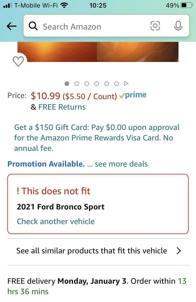

Following these links to Amazon, I get a warning that these do not fit the 2021 Bronco Sport.
Ford Bronco Sport Replaced All Rear Lights With LED's F789E6C1-87D7-4A08-AF52-01A9FE7276D5
You can't go by Amazon's vehicle check since it hasn't been updated for all of the new models and years. Also if you check the items descriptions, it states that right in them. You need to go by the bulb number that is given in the owners manual as well as the item description. Also if you read the post that I left, I specifically stated that these WERE CONFIRMED TO WORK as well as posting pictures of them working.
The following is from one of the descriptions of the bulbs that I used:
【Buy with Confidence】We offer "TWO YEAR" warranty on item(s) that confirm to be manufacturer defect.We'll respond within 24 hours on weekdays. Amazon filter system may not be 100% accurate or up to date, if you are not sure which type fit your vehicle, please check your owner manual to confirm.

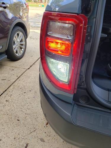

Thank you @Whitenight, this was the post I needed to upgrade my tail lights. I used 2 of the 3 you recommended (another from the other thread) and they work great. Had them in for about a week with no issues at all. These are the ones I used:
https://www.amazon.com/dp/B07FCZVLCS
https://www.amazon.com/dp/B07WZ5XWDY
https://www.amazon.com/dp/B07H6YPB8N

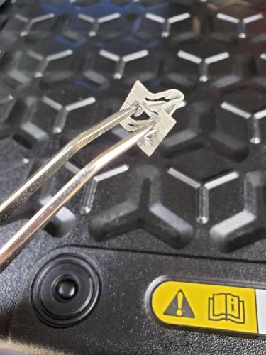

The biggest pain was pulling off the rubber trim to get to the tail lights. Mainly because one of the clips stayed behind. It was a bear to get out, but I was able to use some tweezers to grab the inner part to squeeze them out. I put it back on the trim and was able to reinstall it without any issue. The rest was just like changing any car bulb.

It originally took me a few minutes to figure out how to get at the nuts to undo the tail light lenses. Once I figured out that the plastic piece had to come off, it was another issued to get my fat fingers in at the top to release it. I finally got it done, though it wasn't as clear on how to do it as it was on my 2019 Escape (those were just a plastic cap covering the bolts). Guess I should have mentioned in my original post for those who might not know how to get them off. Glad everything worked out for you. :like:
There was a video someone posted from Uhaul that showed the process of removing the tail light (along with the rest of the back end). But I was still not prepared for how awkward it was to get my fingers in there to get enough leverage to remove it.
