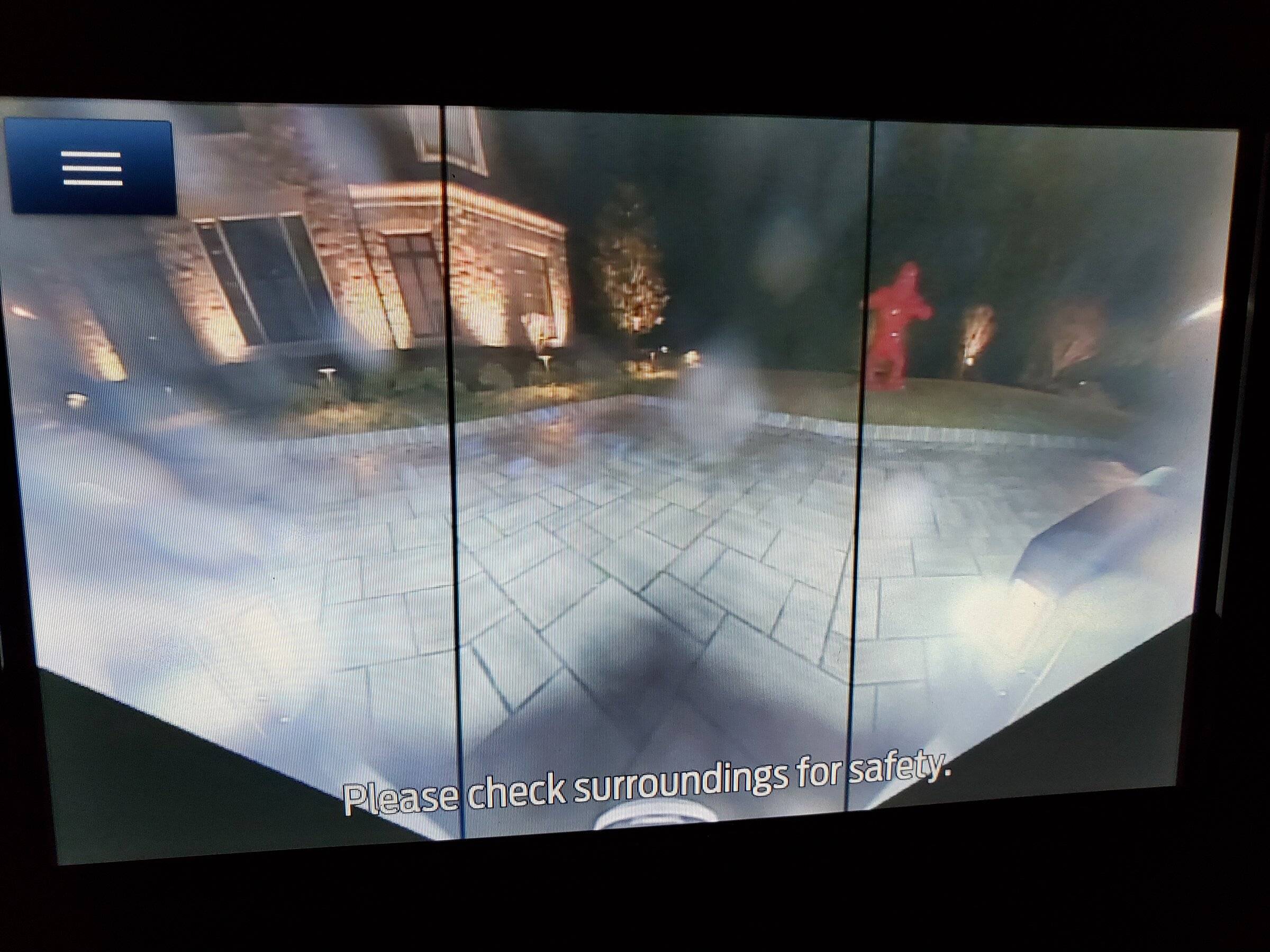

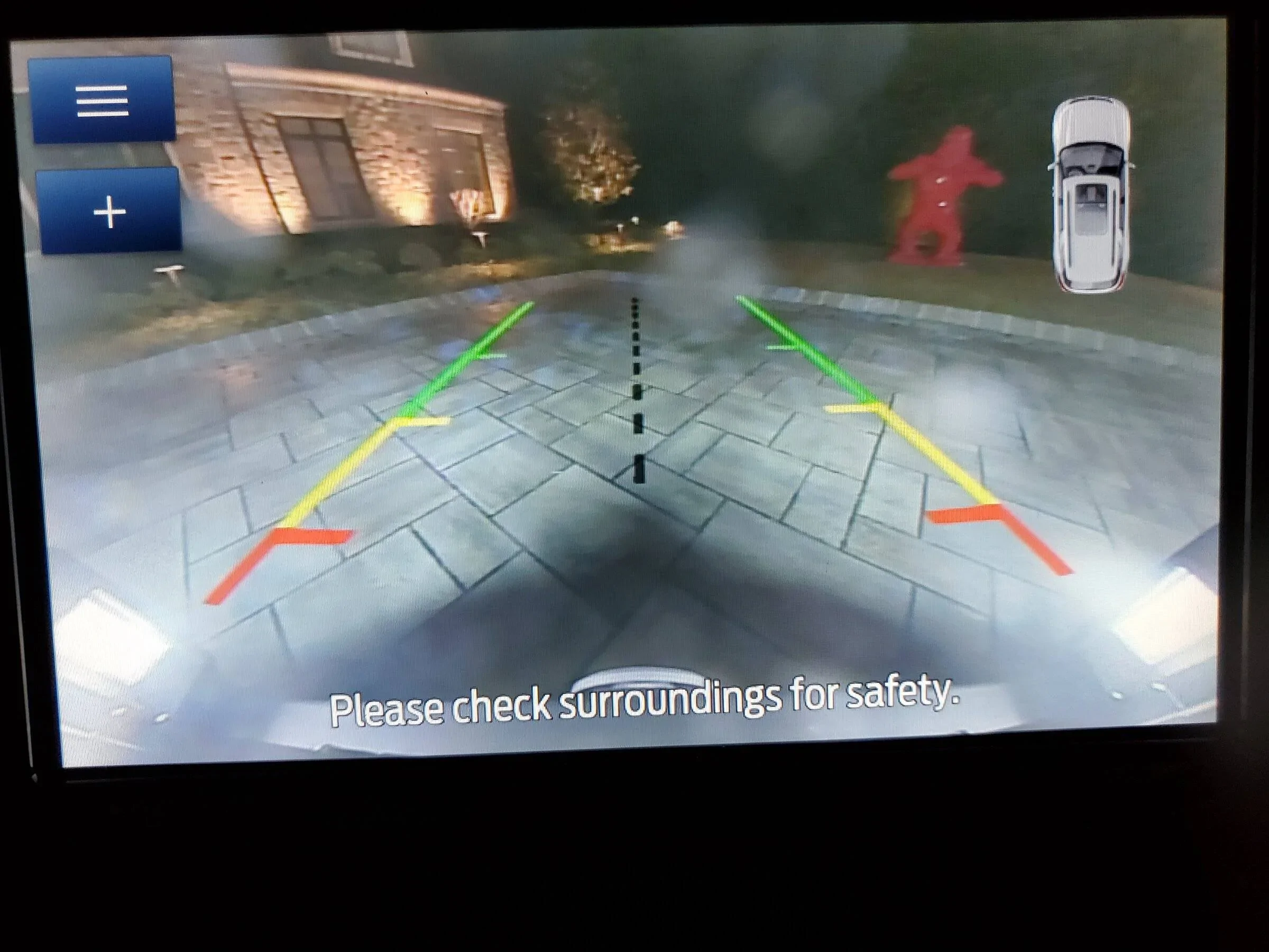

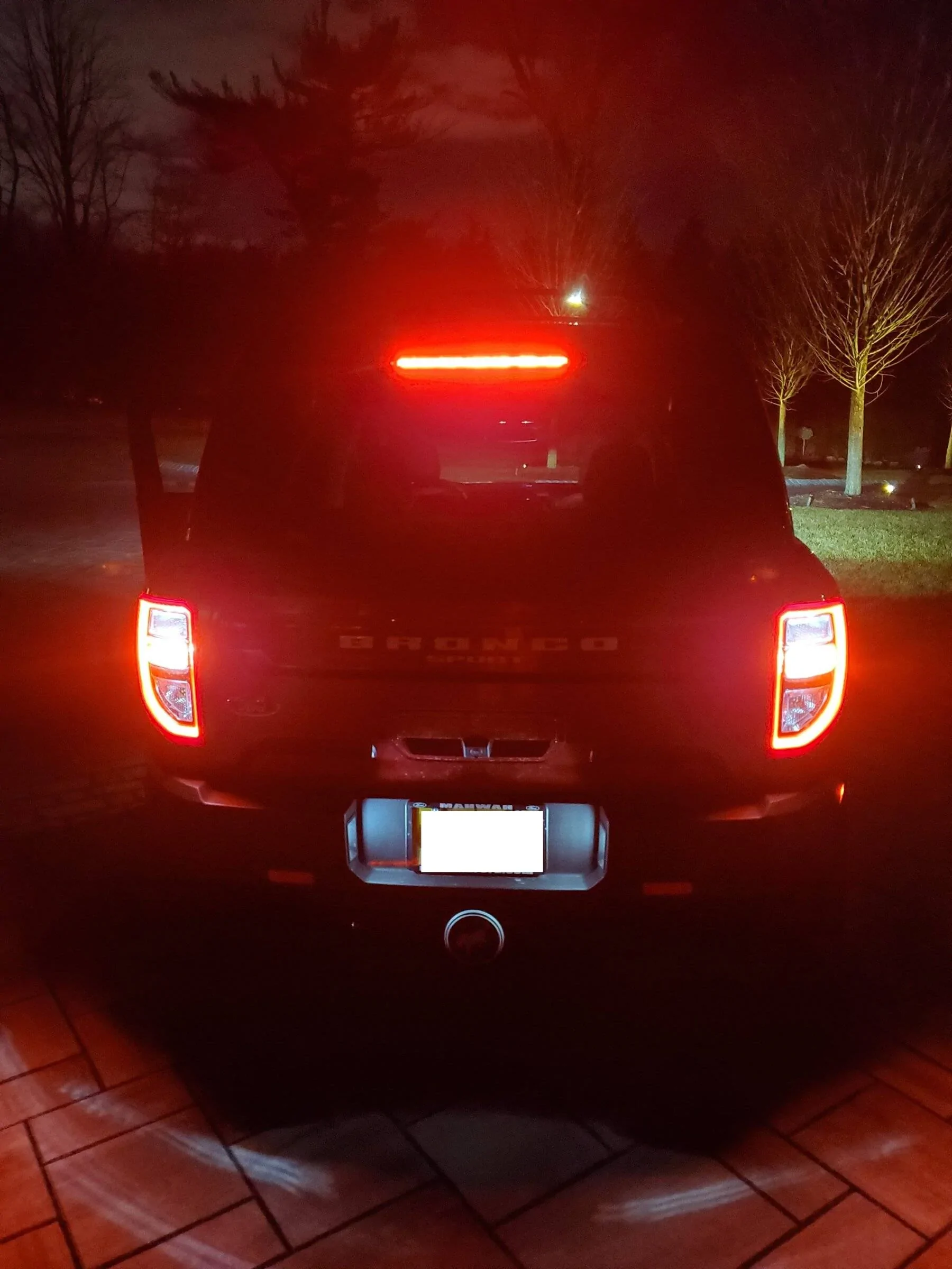

Here are the pictures of the installed bulbs on my Badlands. The first time I used the back-up camera at night with the original bulbs, I immediately said that they had to go. The photo of the reverse camera shows exactly what you see with the replacement bulbs - definitely night and day (no pun intended).
Ford Bronco Sport Replaced All Rear Lights With LED's 20211226_183431
Ford Bronco Sport Replaced All Rear Lights With LED's 20211226_183349
Ford Bronco Sport Replaced All Rear Lights With LED's Brake Lights
