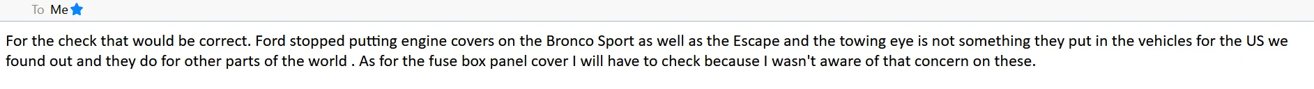

A little digging and I found the dealer correspondence concerning the towing eye, engine cover and passenger side dash panel
Ford Bronco Sport Rear tow hook 1650675328458
Thanks for posting that.
I can't say whether that's true or not, but I'd like to hear it directly from Ford. Most dealers have a pretty casual relationship with the truth, particularly when it benefits them.
