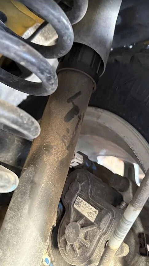

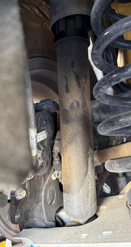

I also just found out there some leak to my rear shocks. I hope they would replace them under warranty
That leak looks pretty extensive - Ford has a bulletin showing how much shock leakage will cause the shock to be replaced under warranty and your leak looks to me like both rear shocks will get replaced under the 36 month/3 year warranty (shocks are also listed in the 1 year coverage so let’s see what your dealership has to say).
well, the shocks will be replaced under warranty but I was surprised to hear that an alignment will be done for that. I supposed this is not a struct, replacing the shocks not necessarily change the alignment. but I will probably have it checked next week by a local store I have life time alignment warranty on.

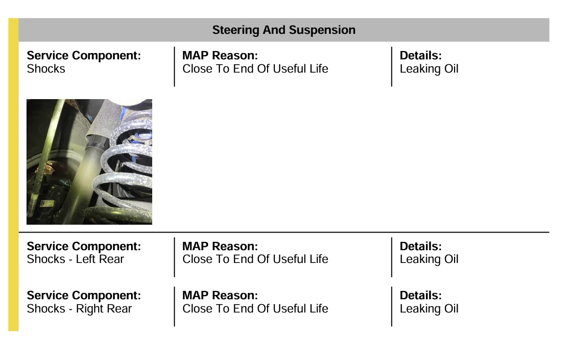

Went to Firestone for a lifetime alignment ($200 one time then free subsequent alignments) and had them rotate the tires. Tires need changing (doing at Mavis, Firestone didn't have the tire I wanted), but in addition to some other things, they noted the rear shocks were leaking. When I told them I was still in 3yr/36k they said "oh yeah definitely take it to the dealer and make them replace it", no upsell pressure at all.
Ford Bronco Sport Rear Shock Leak 1766497021180-7y
See what your dealership says - as stated in an earlier post, Ford has a service bulletin which defines the amount of seepage (weepage) that is considered as normal vs leakage
You can google that as well
(Pretty much all lifetime service programs are “loss-leaders” to find and suggest other profitable repairs)
