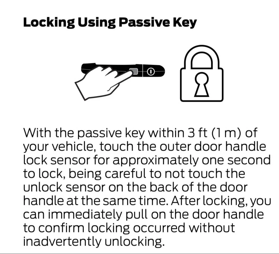

The vehicle is not designed to unlock with just the FOB being near the vehicle. The user with the FOB has to take an action to unlock the doors.
There is no touch sensor on the backside of the front door handles. Try this, lock the doors, without physically touching anything, slide your hand behind the front door handle. You will hear the doors unlock.
To lock the doors, make sure the FOB is on or near you, take your index finger and touch the ribbed area on the topside of either front door handle until you hear the doors lock. This is the area that has the 5 ribs.
Ford Bronco Sport Rear Door Open...Open...Open IMG_4806

All true! I must just not know what magic "key words" to use when looking something up. I got frustrated when finding something saying "see page xxx", going to that page and having refer you back to the first page I looked at. Anyway, with all of you helping, I tested it all and it all worked.

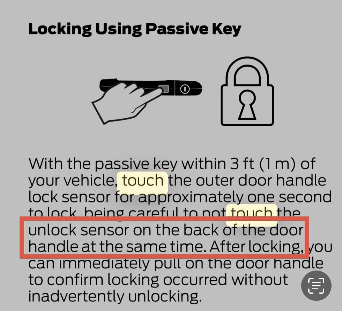

I think both are correct - there is a touch sensor on the backside as stated in the manual but on mine at least, my fingers don’t have to physically touch a sensor before the door unlocks
I wonder if the sensor is capacitive and fingers in close proximity is enough
