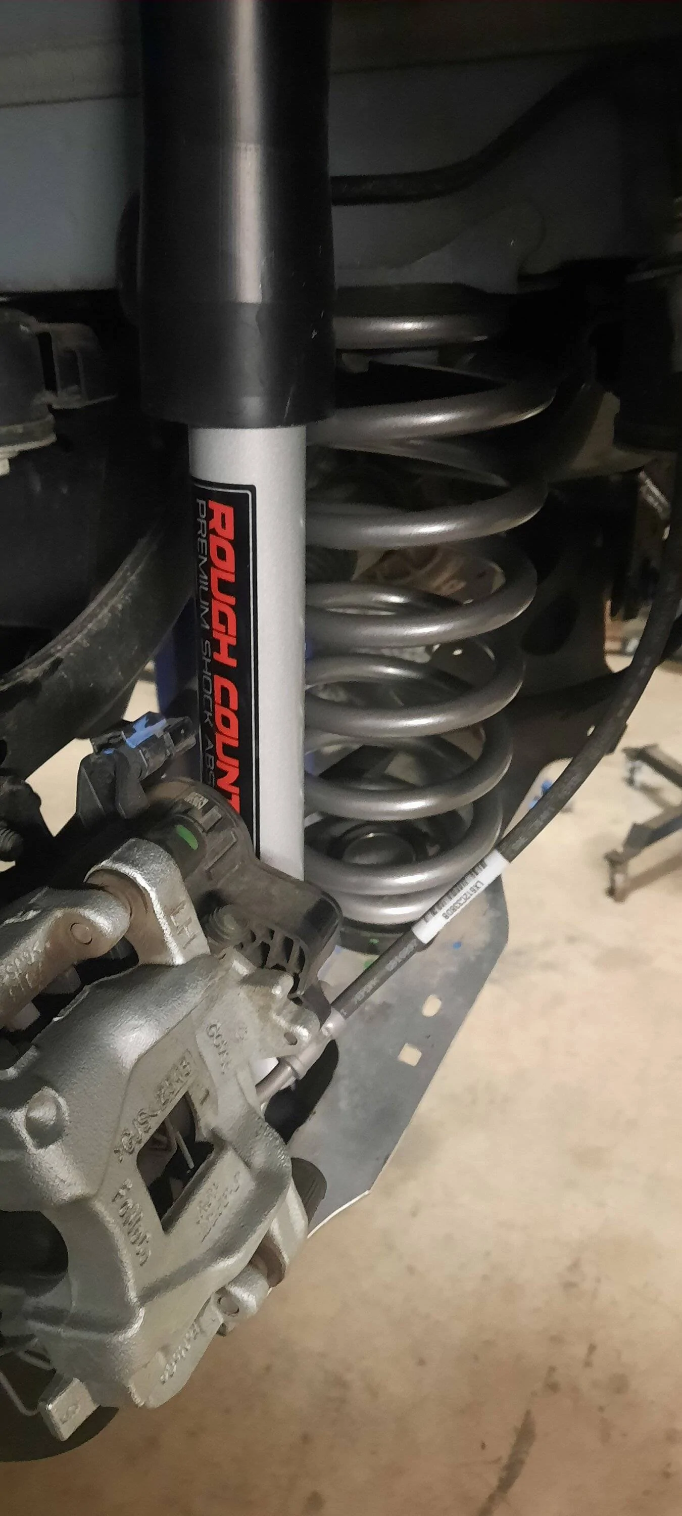

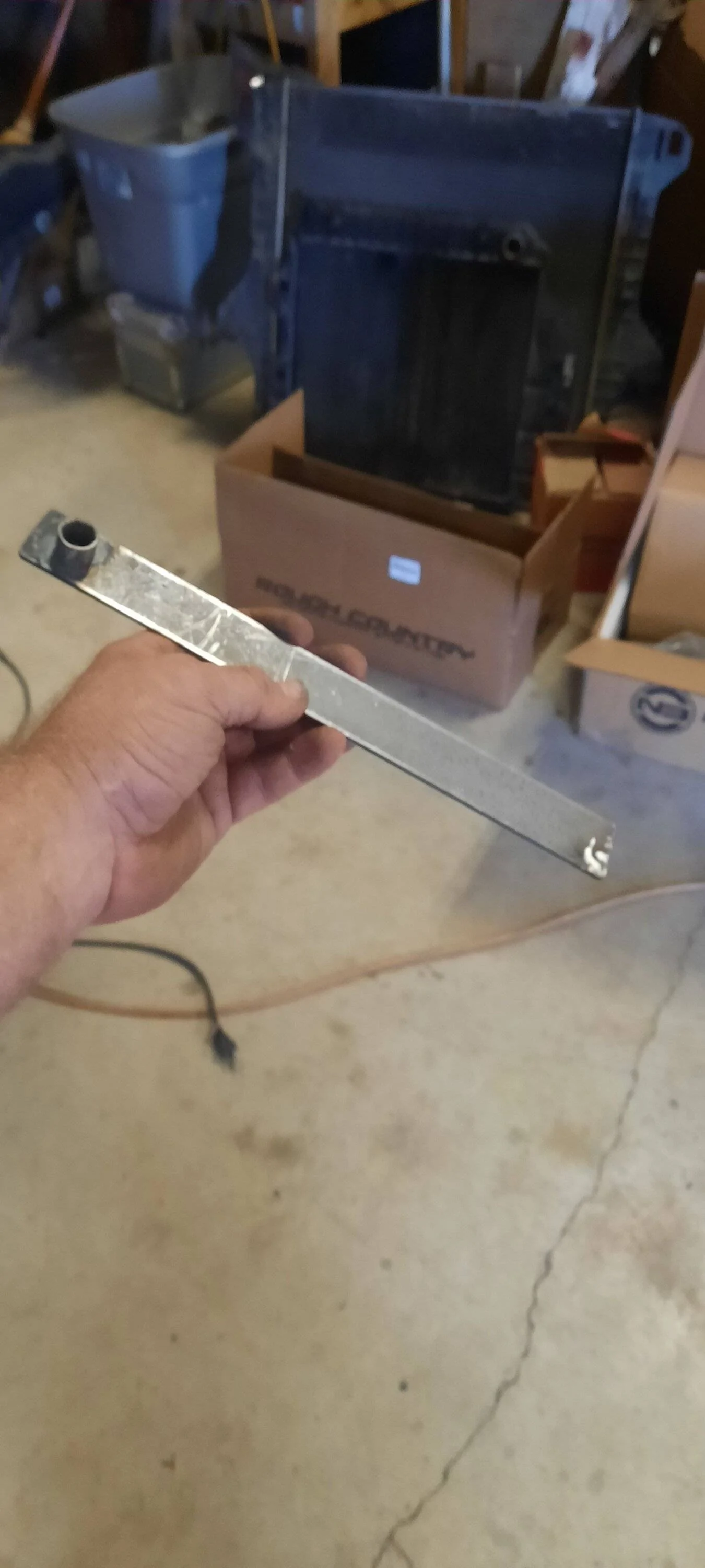

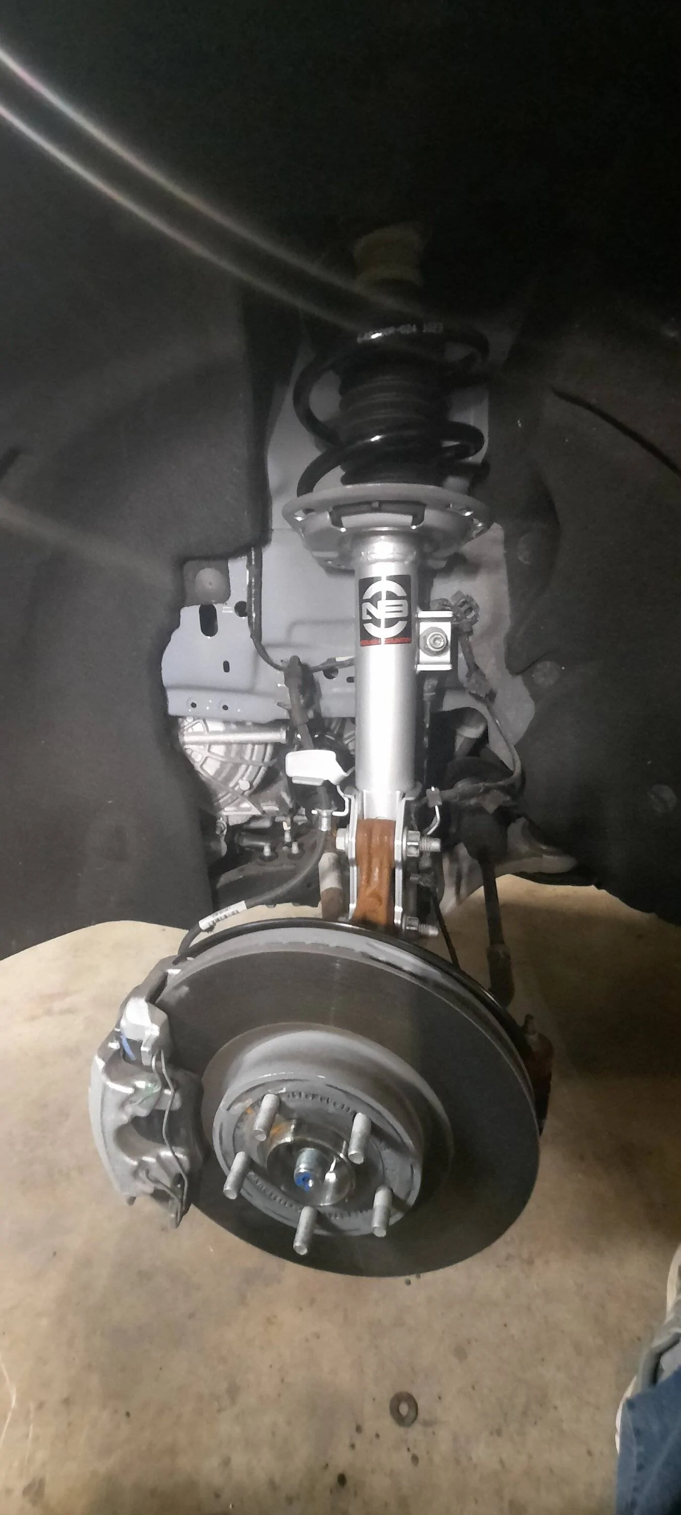

I took a chance with the Rough Country 1-1/2 strut ,spring and shock lift kit , Did the install myself as I have a 9k lift in my home shop, the hardest part of the job for me was getting the 1 inch spacers under the trailing arms on the rear access is tight because the jacking points for the rear are next to the arm pivot points , also had to fab a wrench for the shock nut ,I'm sure ford makes one but I'm pretty handy with a drill and welder , finished up late so test drive will have to wait till Tomorrow.

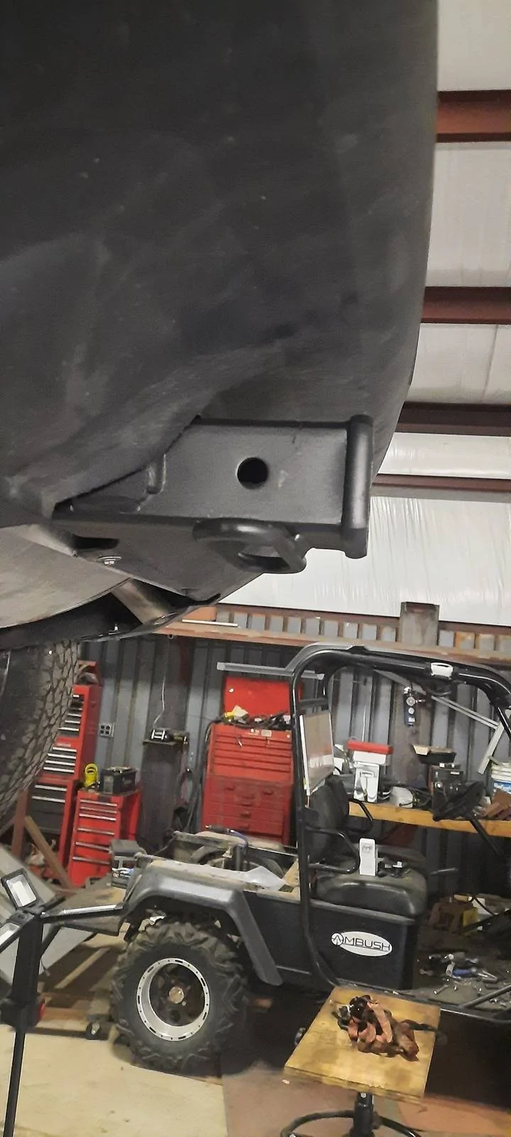

Took the Bb out for a test drive this morning, everything seems fine, haven't taken it off road yet maybe later today I'll go down to the lake bed and see how it does in the sand , it's real easy to get stuck at the lake because the ground looks solid but will give way and you'll drop like a rock , I've pull several people out with my TJ last week ,I did get the trailer hitch installed , so I have a recovery point now , I like how the BS,BB looks now .

Not sure why you needed to make a tool for the rear shock. I don’t remember that being especially difficult to remove/replace when I did the Flatout kit.
Ironman482
Ronald
Dec 8, 2023
50
99
Buchanan dam Texas
2023 bronco sport
The nut to remove the shock frome the bracket is countersunk into the bracket and you have to hold the shaft with a 1/4 " wrench. I suppose you could use a pair of visegrips on the shaft below the tower on the old shock but that would be out of the question on the new one.
