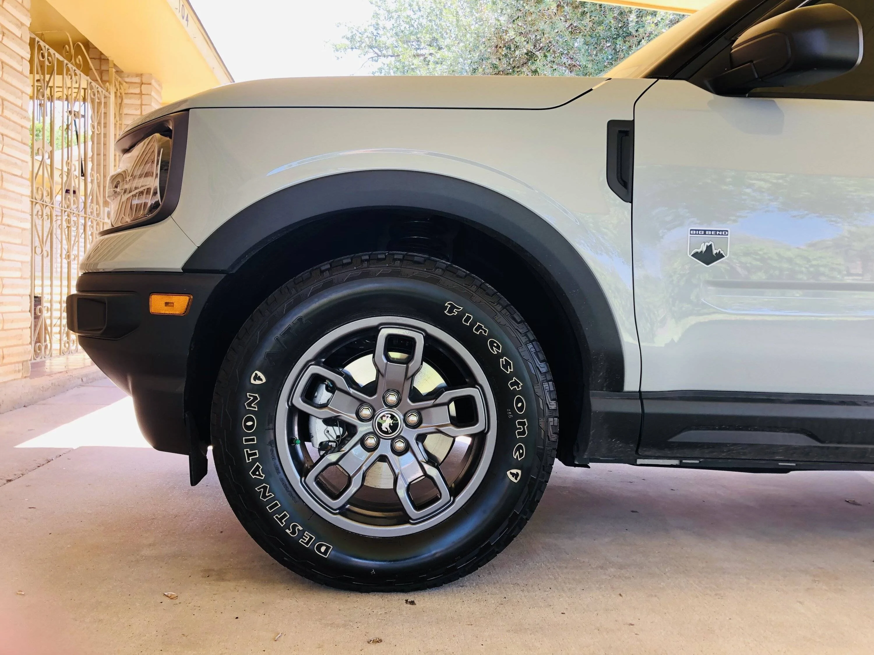

I know that the 65 and the 17 work, but does the 235? Anyone do this?
(For specific reference, look at my main pic, that's my Bronco Sport. The rims are what I would be using.)

Yes, 235/65/17 is the stock upgraded size Ford offers directly.

I had 245/65/17 on stock big bend wheels so 235 will work fine

AT’s what I did on my Base model.
My 235’s added about a half inch of tread width and it lined up my sidewalls with my rims edge perfectly.
NOTE: my door recommendation on tire pressure is 33 psi for the stock 225’s
I dropped one psi cold to get an even tread wear across the tire in my 235 wides. This has proven effective over the last 18,000 miles per my tire tread depth gage. :,P
