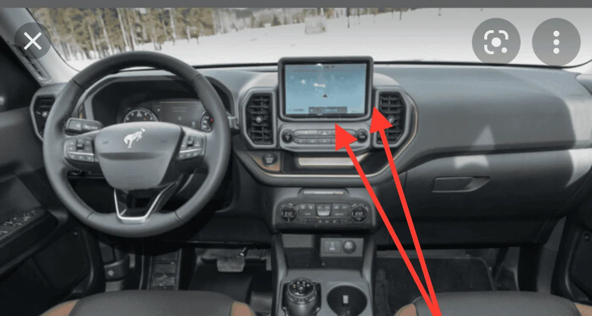

  2. Because I live in Arizona, I often drive on the highway. There's a slight plastic collision sound near the area of my central console screen. I feel like it might be due to assembly tolerances. Has anyone else encountered this issue? It seems like it doesn't happen in the evening. Could it be due to expansion and contraction from temperature changes?

2. Regarding “slight plastic collision sound near the area of my central console screen”, if is the same issue of noise that others reported, their solution was to insert small amount of insulation about the thickness of a credit card - see pic for the arrows pointing to where to insert. Check first if you are getting noise there and if so that solution may work work you. If I misunderstood your #2 item please ignore the solution.
Ford Bronco Sport Question about my lovely Outer Banks! 1694311327826
