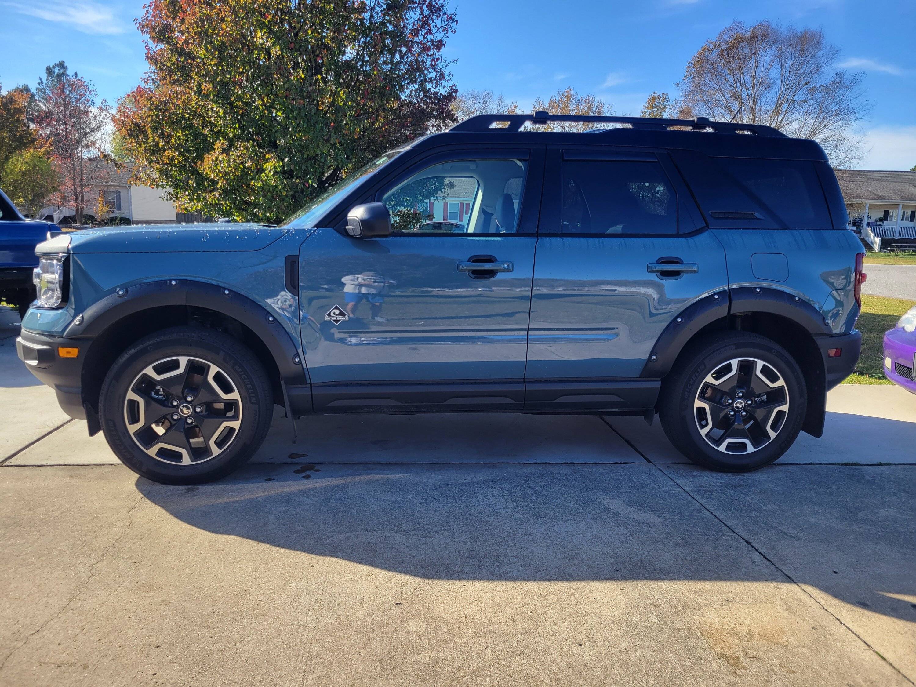

Picture of your lift?
mikldom
Sep 22, 2022
73
81
Outer Banks NC
2022 Bronco Sport Outer Banks Edition, Area 51
After about 5,000 miles or so a bad clunking has popped up from the driver side. I am pretty sure the axle is the culprit. I took off all wheels and "shook" everything. All bolts are tight. There is some movement in the axle on the driver side at the inside joint, (where it previously was separated). I can "smack" it and it will do a clunk. I can imagine with the weight of the vehicle and suspension movement, this is the source of my bad clunk. Ordered new axle from Rock Auto and another 5 quarts of ULV fluid for a grand total of $201 with shipping. Everyone, be careful when installing your lift. If the axle becomes separated you will likely have it fail or make a ton of noise if you get it back together. I am certain it would not be covered under warranty because I had to reband the axle and I installed a lift. Now, if it the front end still clunks like hell after I get new axle in, I will remove the lift and take it to the dealer. At least it will be back to stock.
