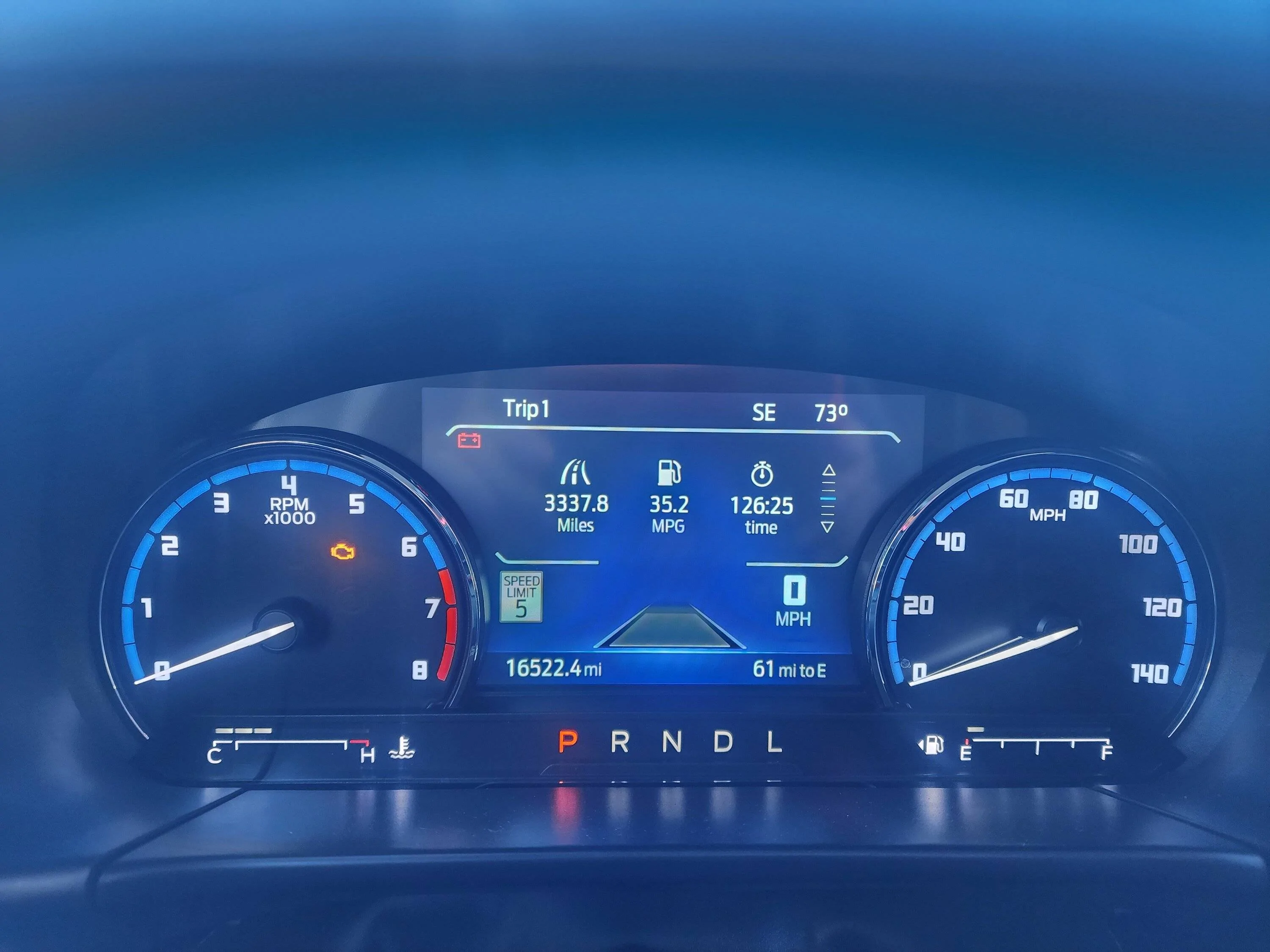

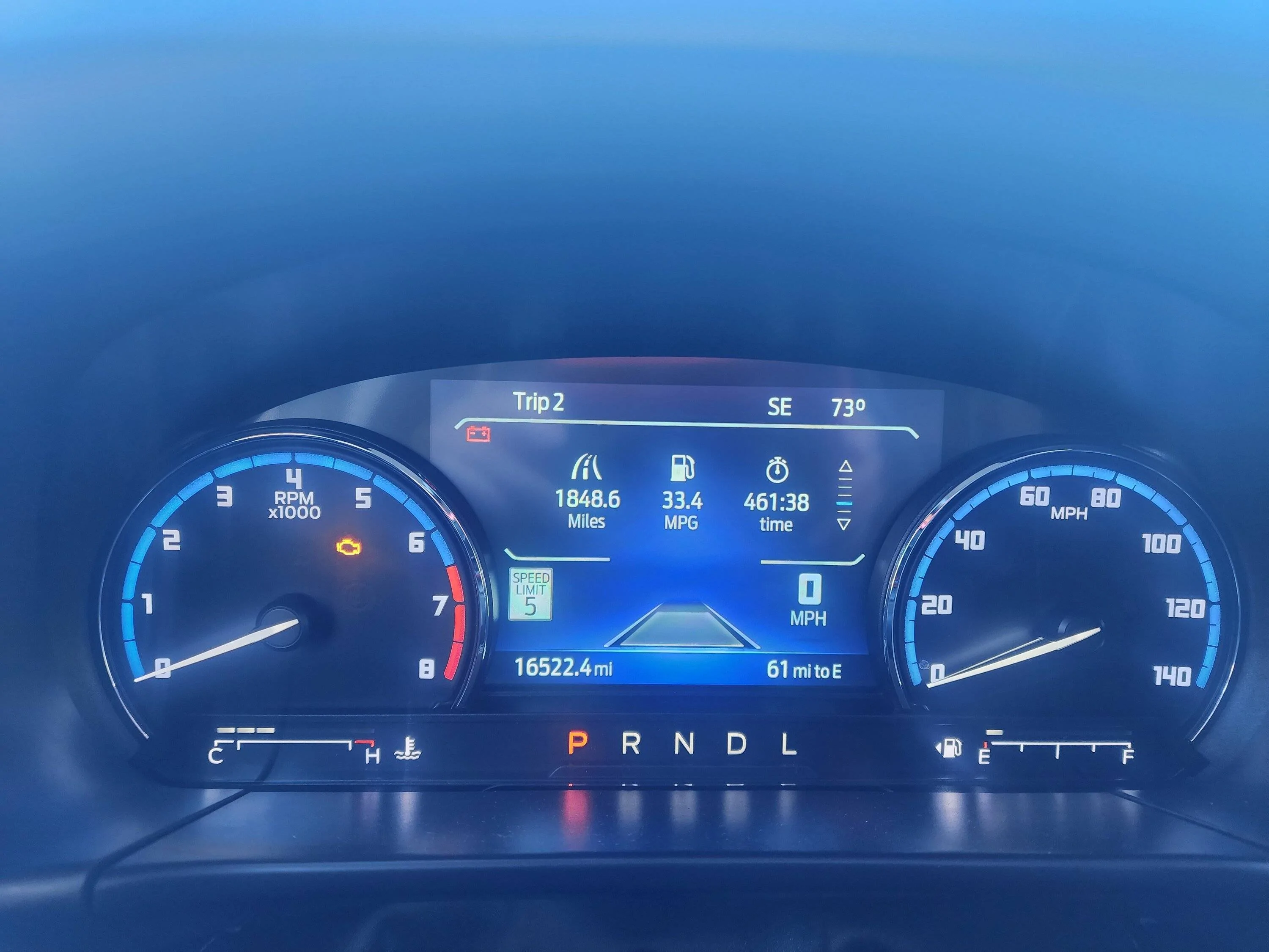

I agree with some of what you posted. Driving inputs probably make the biggest difference. I've been building and modifying engines for 40 years, wasted a lot of money on things that don't work. In the case of 1.5 it's the aggregate of all mods combined plus my personal driving habits that show mpg improvement. It also helps I live in Southern Florida, flat as a table and at sea level. Attached is a photo of my 11000 mile average, confirmed. it rolled over at 9999.9 but the hours keep ticking up. I've done other things as well and like I said it's the combination of everything, each to a certain percentage of mpg gain. Due to a big warranty no no I haven't touched the programming side of the engine. I'm positive I'd get even more out of it but it can also open up a can of worms on reliability. All in all this engine has plenty of potential for mods, like all cars really.

I have a Badlands and I know for sure the Bronco Sport is capable of getting very good fuel mileage on flat open highway, It wont get 1.5 liter economy but its respectable.
Mileage does start dropping off when encountering hills, slow traffic or when needing to accelerate.
Also the Mileage drops significantly when city driving and then another order of magnitude drop when driving off road.
In my case I didn't buy the Badlands for its fuel economy, but for its performance capabilities.
