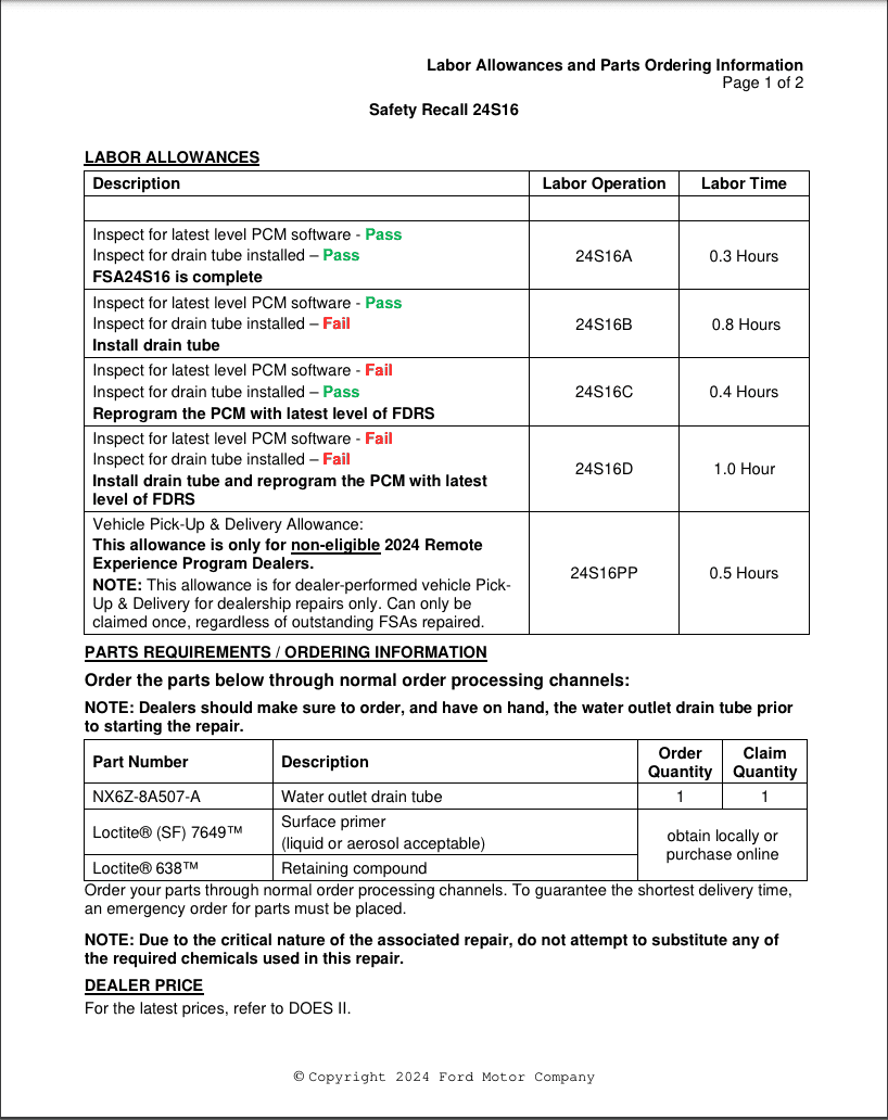

Basically, yeah. They revised the fuel injectors, ending in revision code -BC instead of -BB. They believed that these revised injectors would prevent the leaks that led to recall 22S73. For vehicles built with the old injectors, they provided an engine control software (ECU) update that would detect and respond to a leaking fuel injector, as well as the drain tube. 22S73 is for Bronco Sport built from launch through August 12, 2022, and Escape through October 17, 2022.
For vehicles built with the new injectors, they did not get that software logic and they may not have gotten the drain tubes. Bronco Sport and Escape population for 24S16 both resumed October 17, 2022. But it turns out, those revised injectors are indeed capable of leaking, leading to an engine fire.

24S16 is solely vehicles built with the new injectors, which Ford believed addressed the issue at the factory, so they were not already recalled under 22S73. Now they are acknowledging that the -BC revision can still leak, leading to engine fire. The fix is to push the latest PCM and related software revisions and/or install the drain tube, depending on what each affected vehicle needs.
