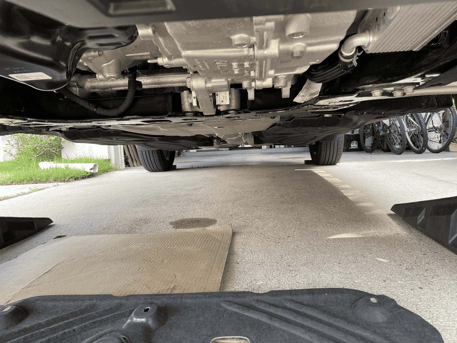

It could also be air bypass leakage in you A/C venting system or Air Box , something may be disconnected, broken or not sealed properly . Ya need to see if water( condensate ) drips out of your A/C drain first . I'll go out & look for it but it may be hard to find right now , our BS is soaking wet from rain.I looked & can't tell with all the water on the Garage floor & the BS , but ifs you look at this photo from when I changed my Oil , you can see I ran the Engine for a few min. so the Oil sample was a good mix & if you look at the end of the Cardboard I have on the Driveway , there is a wet spot from condensate on the Driveway , it could have traveled , because the BS is on Ramps , but my Drive has a grade to it & the BS may be close to level . That spot is right below the firewall .
Ford Bronco Sport passenger front carpet soaked tempImagevyVEIi
