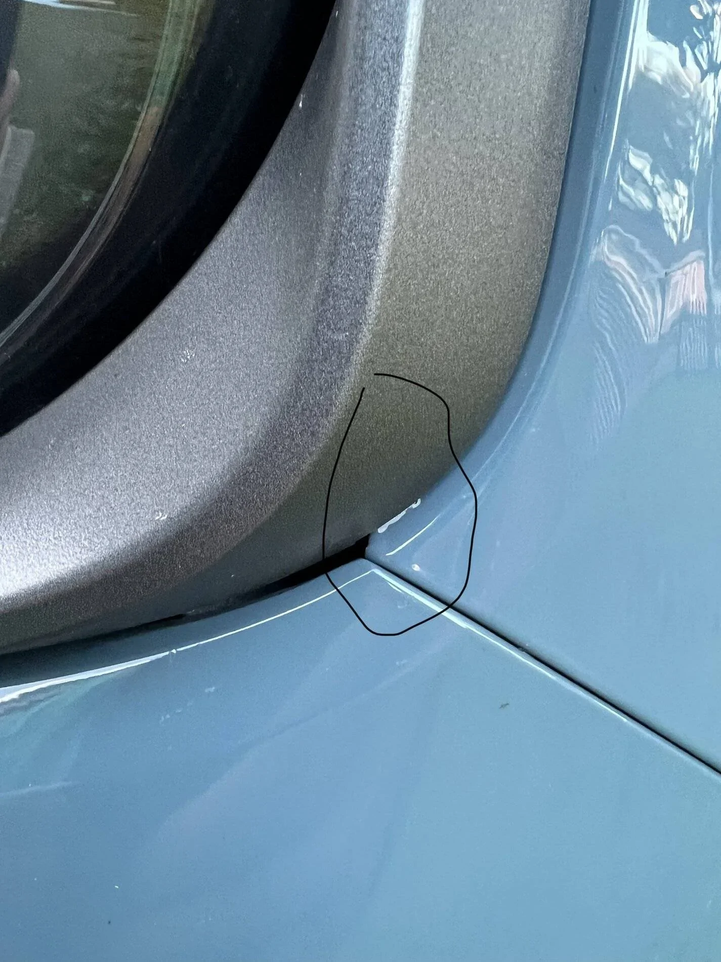

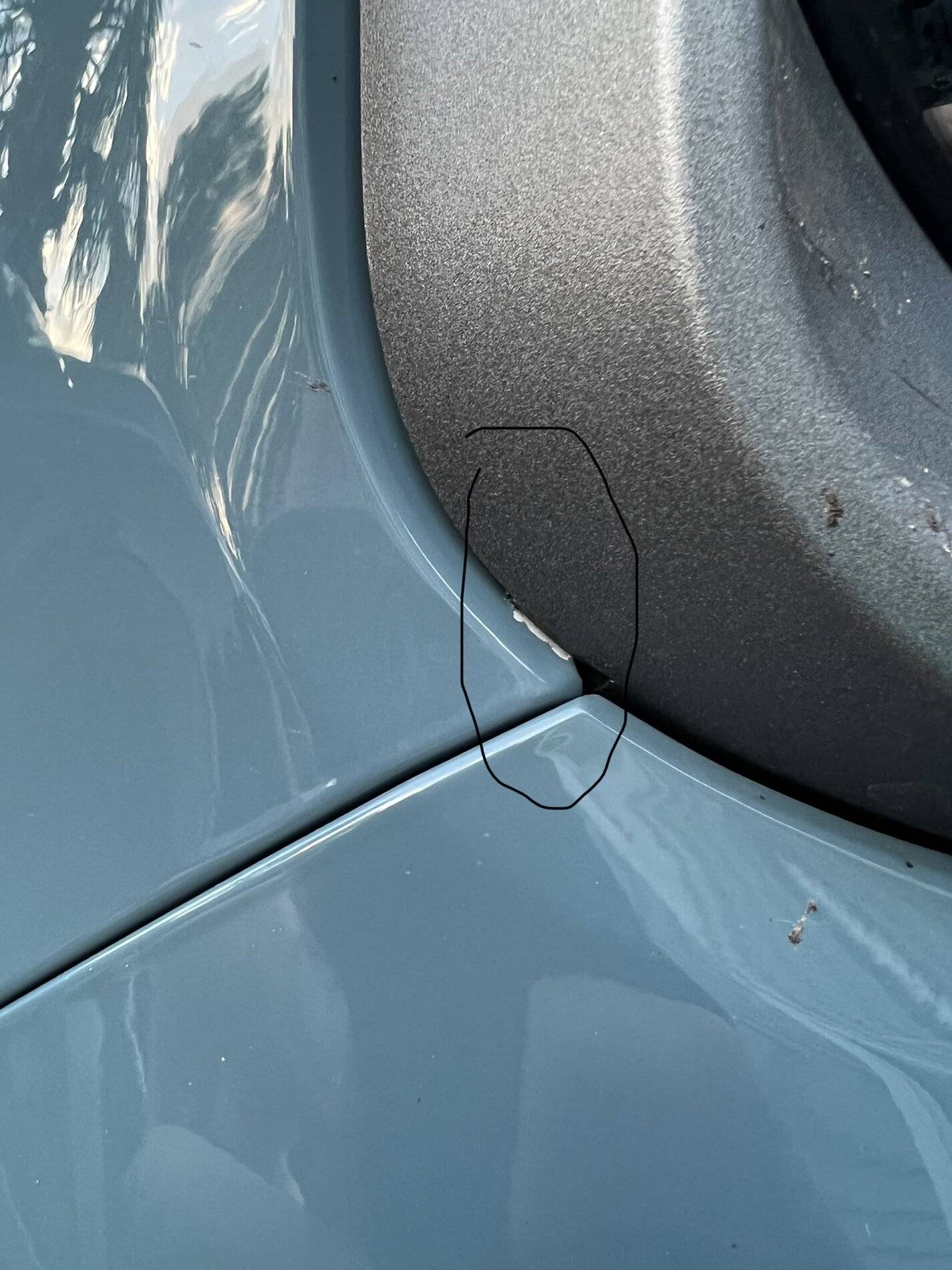

So I was getting ready to wash my car and doing a few spot cleans the other day. Noticed some paint chips in areas that are not even high traffic areas. You can see the two paint chips on the front surrounding the lights are in identical spots on both sides, and then surrounding the back left tail light. These are on top of the chips on the hood that happened in the first month, which I just assumed was due to highway driving. Now I’m not so sure and believe that my bs badlands was just a crappy paint job. Not sure if I’m going to take it in and deal with the hassle or just use a paint pen but pretty upsetting to say the least.

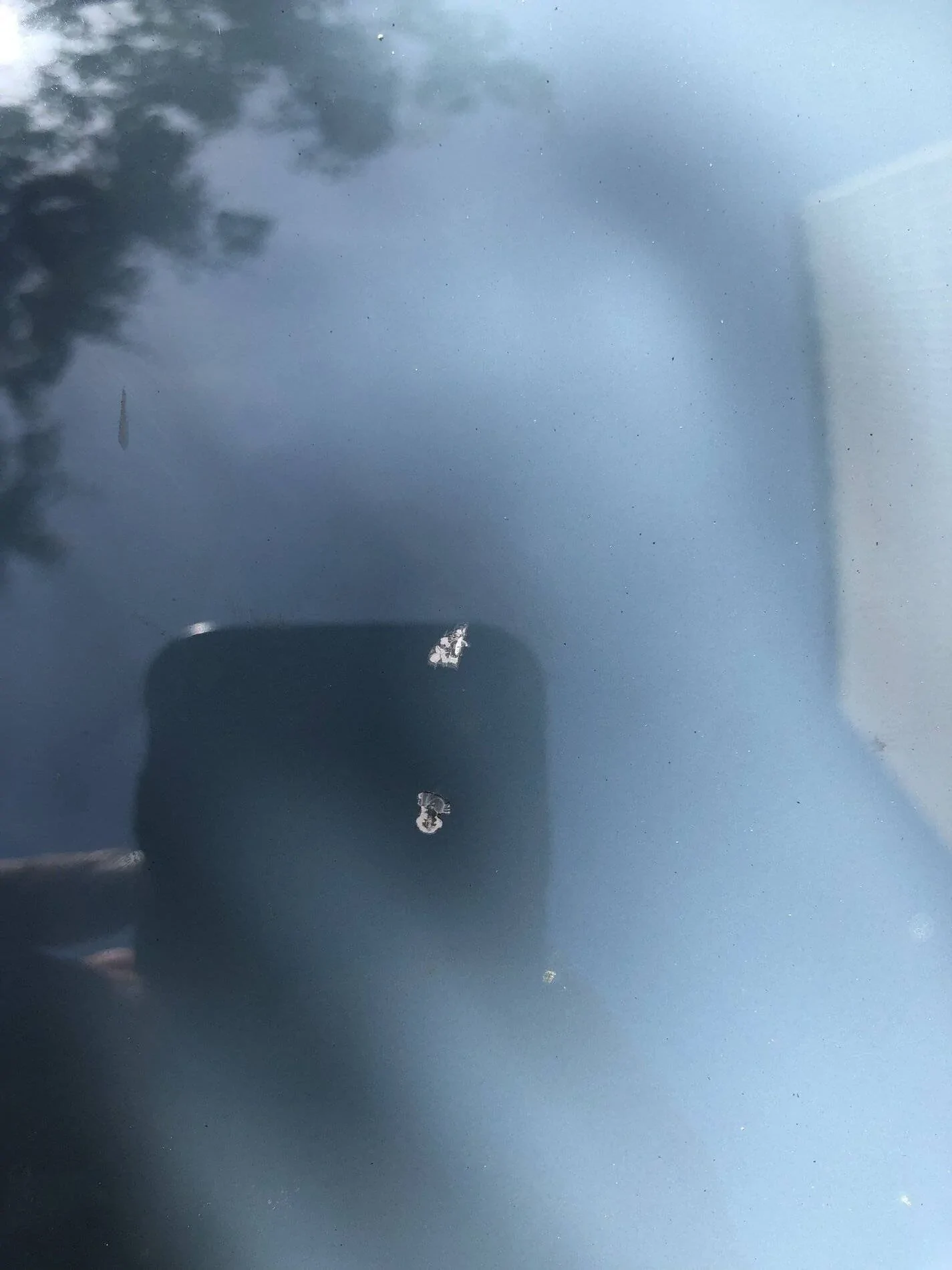

Yeah I've had a few spots on my BL as well. On the trunk, rear passenger door, side of headlight, and even on the roof (I noticed while applying my ceramic wax). I had no luck with Ford; I just use the pen ?‍♂

considering that you see brand new cars on your dealerships, it makes sense that you don’t see paint chips. But just a little research on your end by typing in paint chips in the search bar above would show that there are issues with bronco sports and paint chips. This is a bronco sport forum, we talk about bronco sports so that people are aware of any issues that arise and we also share experiences that we can all relate to. These pictures attached show that this is a crappy paint job. Now with that said, I love my bronco sport and have actually canceled my big bronco reservation because of how much I like It. But coming on here to discredit what is clearly poor QC coming off the lot so that you may sell one or two more bronco sports is a little mind blowing. I’ll use a touch pen and keep enjoying my sport. Good day.
