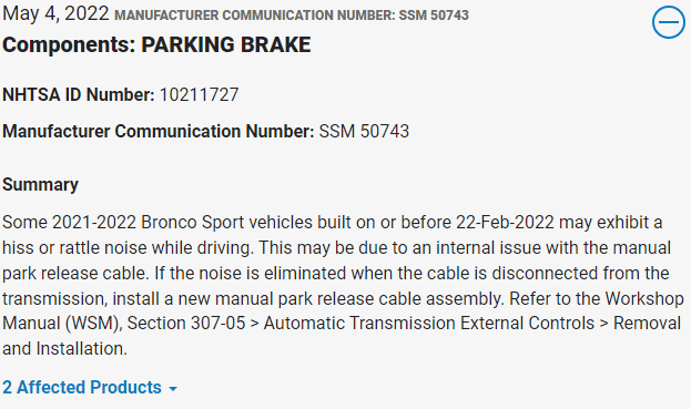

No prob I took the cable off and it’s pretty quiet now so that cable was acting as a pipeline for noise right to the cab.
Finally took your advice and pulled the cable off. Unsnapped it from the bell crank and removed the bolt holding the cable to the top of the transmission. Zip tied the loose end up next to the battery. WOW what a difference! The hissing noise is GONE! The clacking noise on downshift is GONE! After 19,000 miles it's finally the Bronco it was meant to be.
FordGuy
Jordan
Dec 11, 2021
61
I’m very happy to hear that! Just make sure the lever on top of the transmission is moved toward the front of the vehicle so it doesn’t inadvertently put it in neutral since the cable isn’t hooked to it.
My clacking/ rattles are still gone too. That cable is 100% a pathway like a stethoscope from the transmission to the cabin and when it’s connected, you hear all the solenoid clicks from the transmission. The dealer and ford don’t admit or know this so they have been blaming the cable all along yet it’s the transmission I 100% believe it’s the reason for the noises (normal) but the revised cable has a ball like sound deadening item attached to the cable to prevent noises from traveling through

I found this on the NHTSA website. It appears Ford is aware? I have this issue as well with my 2022 BSBL. Just need to bring it in for service.
Ford Bronco Sport On this episode of, "Is this noise normal?"... 1654623890465
