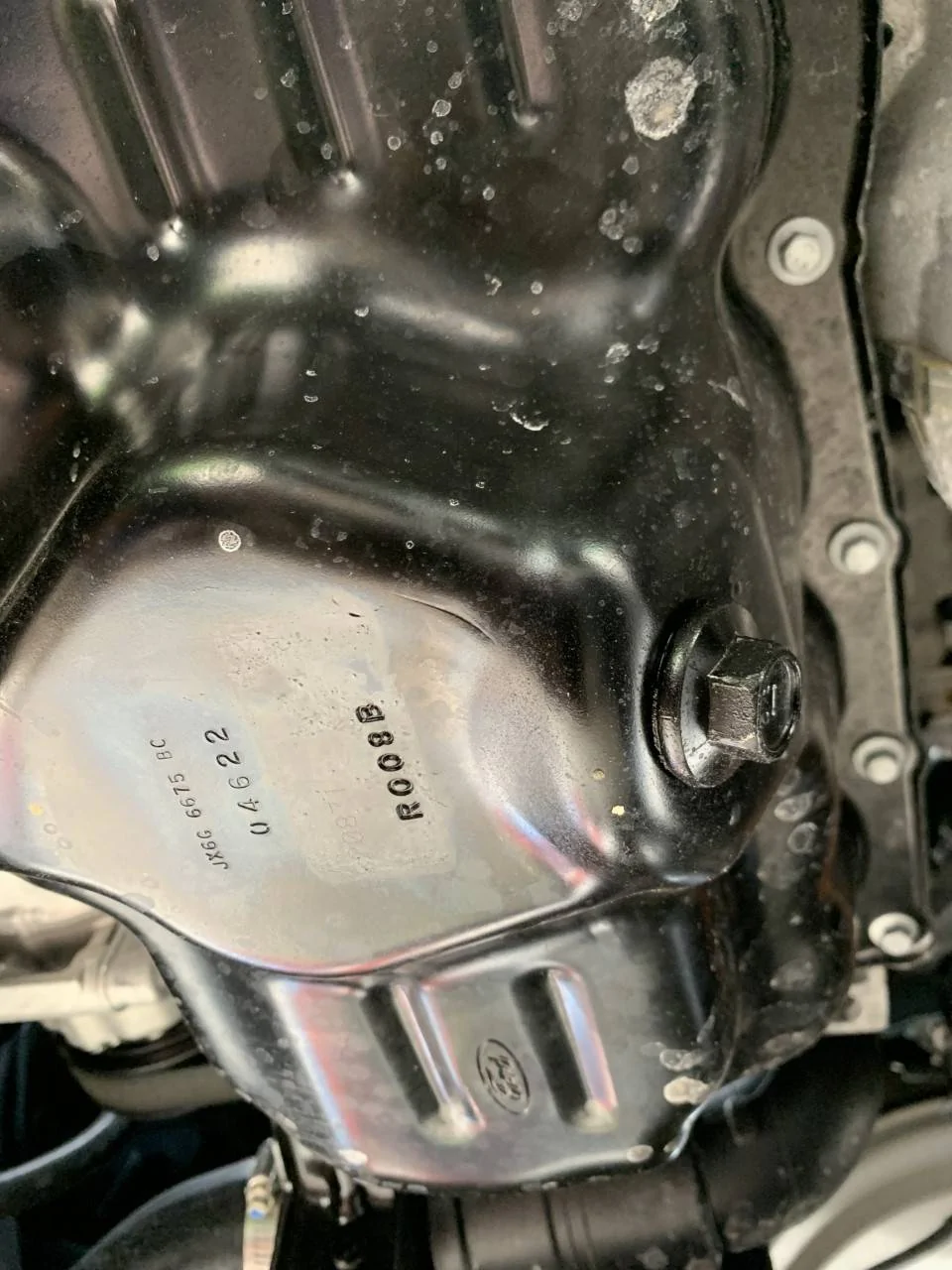

Changed my oil for second time and took picture of the oil pan for reference. This would be the metal pan and metal drain plug. took only 5.3 quarts.
