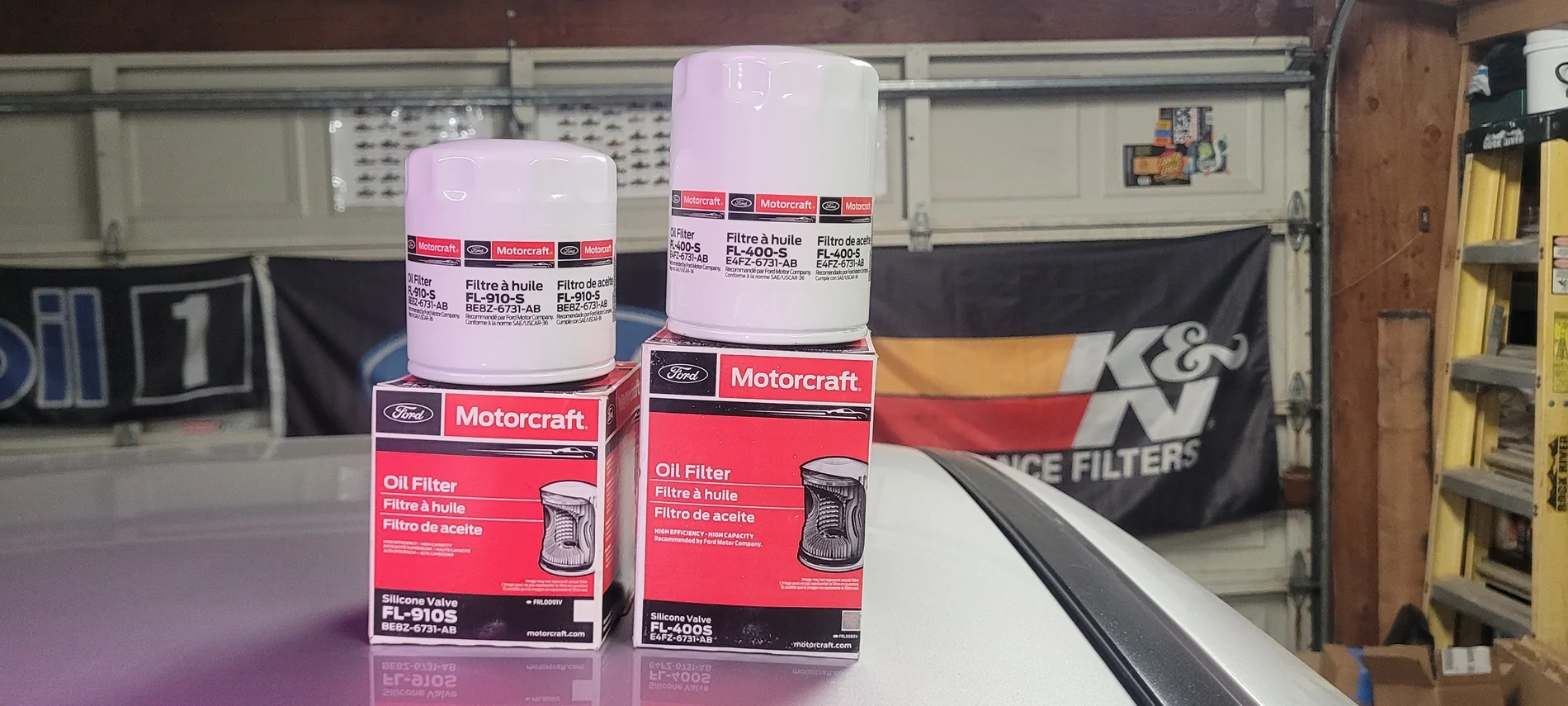

Took the wife's car for service on Saturday morning. I don't trust dealerships, so I had cut the corner off of the sticker on the oil filter and made a dot with a sharpie so see if they actually changed the filter. I checked and noticed the oil life monitor hadn't been reset, so i reset it leaving the dealership. Parked the car on flat ground and came back later to check the oil level. Removed the cover and looked underneath. They did change the filter. Marked this filter the same way, got 3 more free changes. Here's a size comparison of the two filters mentioned earlier since I have them on the shelf.
