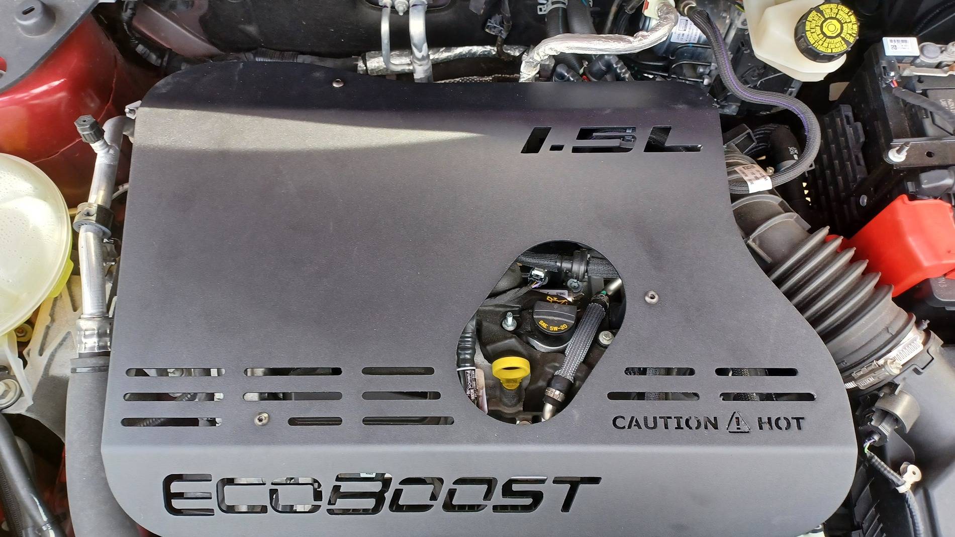

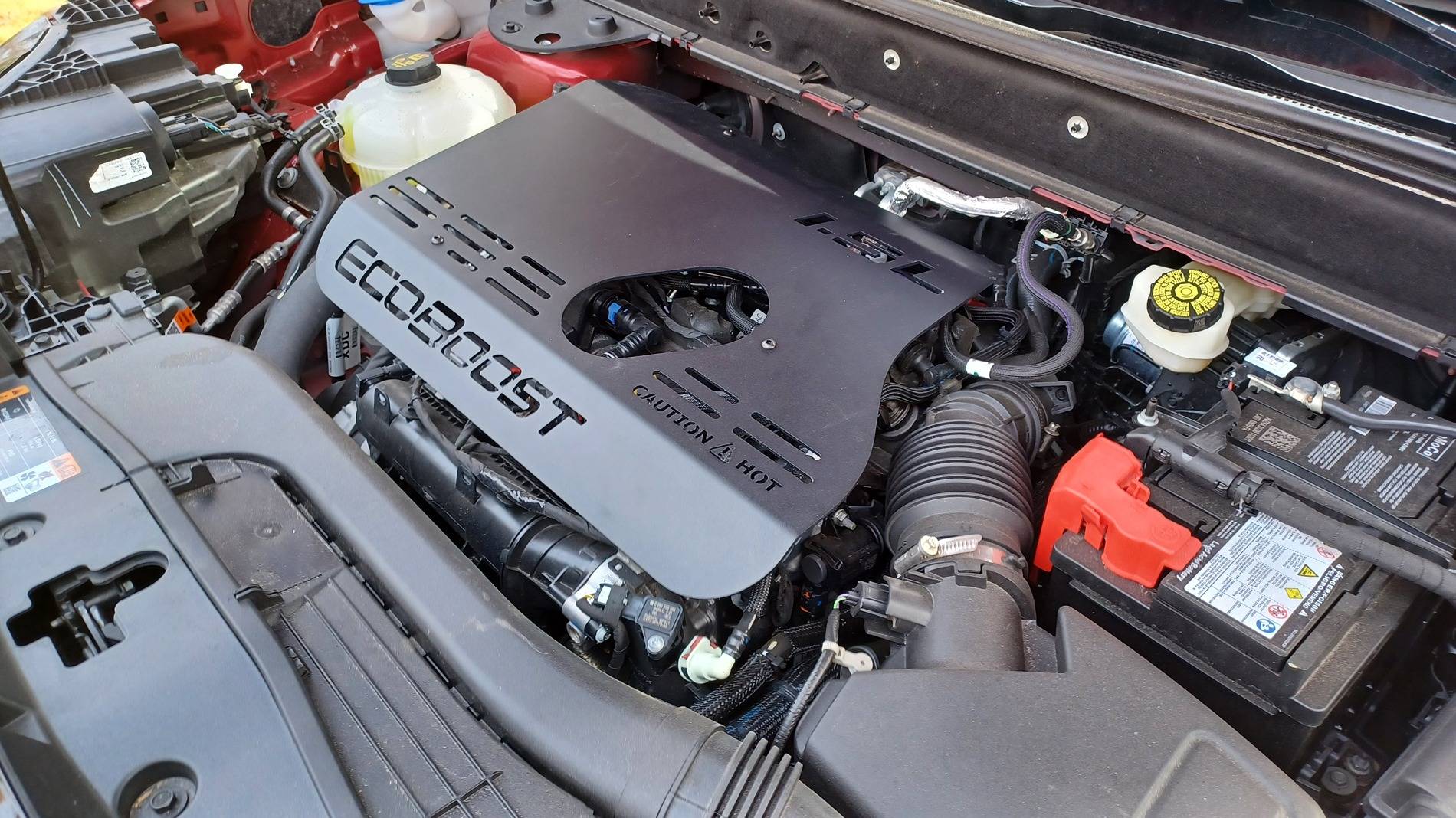

I installed this 1.5L Engine Cover over the holidays in DEC/2024.

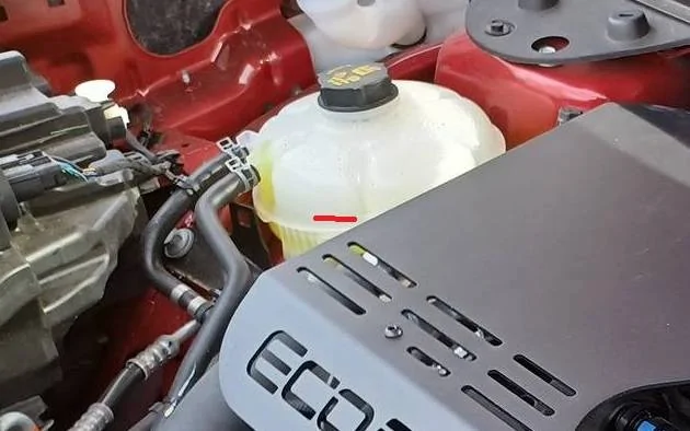

I'm not saying you have a water pump issue, but your coolant is low. It should be somewhere about the red mark I added in. It looks like good old Ford Yellow in the pic, just don't intermix the wrong type. You can get it right at the Ford parts counter and should be under $20.

The Bronco Sport is parked on the slope of my driveway so it isn't sitting level. But I'll take a look tomorrow, if the weather cooperates. Thanks for the 'heads up'.

I did add a small amount of Anti-Freeze this morning when I checked the Bronco Sport. Again, thanks for the 'heads up'!

While I was under the hood with the battery change this morning, I noticed that the engine cover looked like it had tilted towards the front of the motor. Sure enough, it had come loose from the rear mounting pin. I know that the 2.0 liter cover has 4 mounting pins, while the 1.5 liter has only 3 mounting pins (small ball pins similar to hatch cylinder mounts). Having only 1 along the backside of the cover is a design weakness. But I'm sure the aftermarket supplier is only using the mounting locations Ford originally provided for their plastic cover. I'll need to continue to monitor this.
