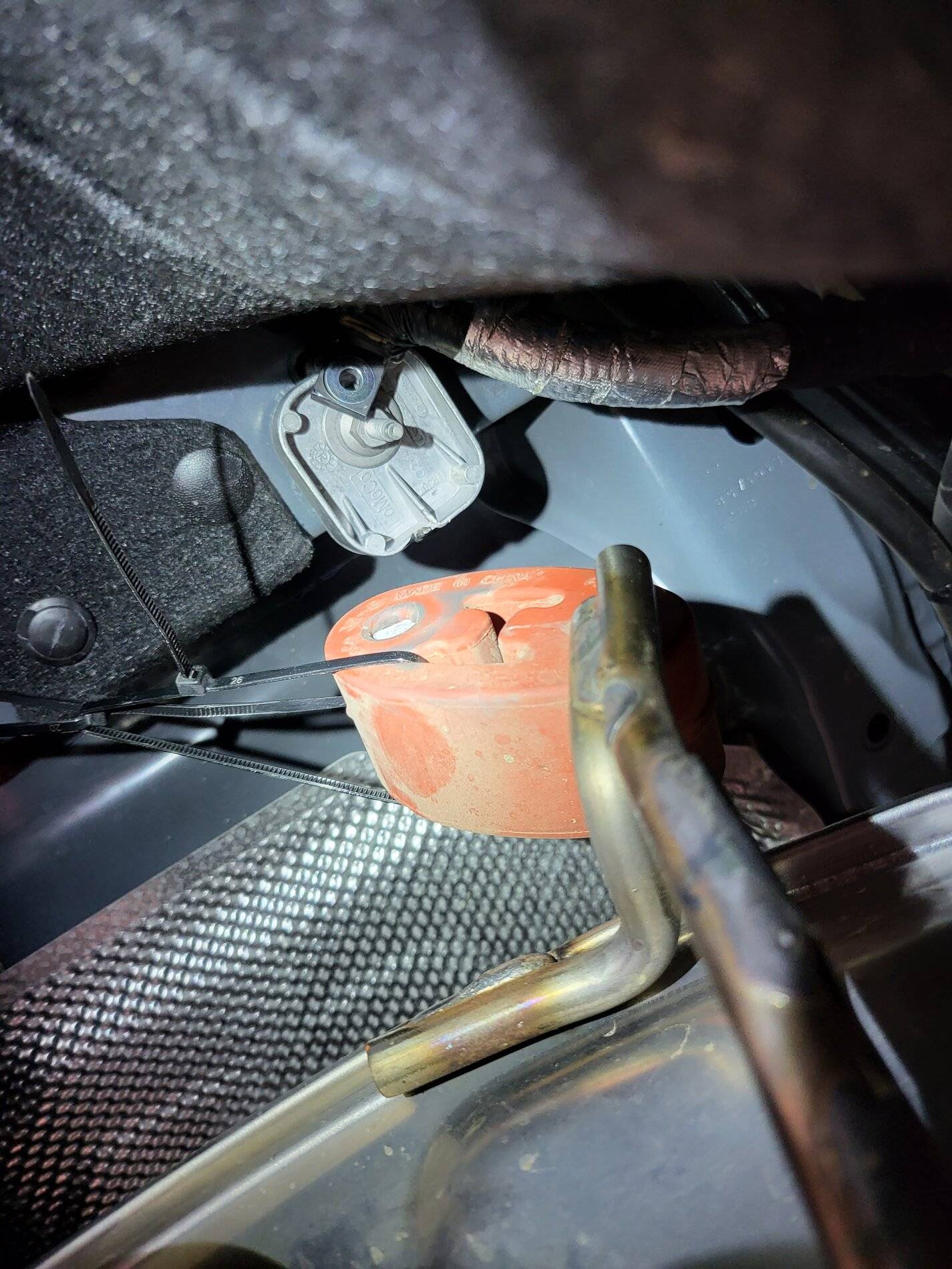

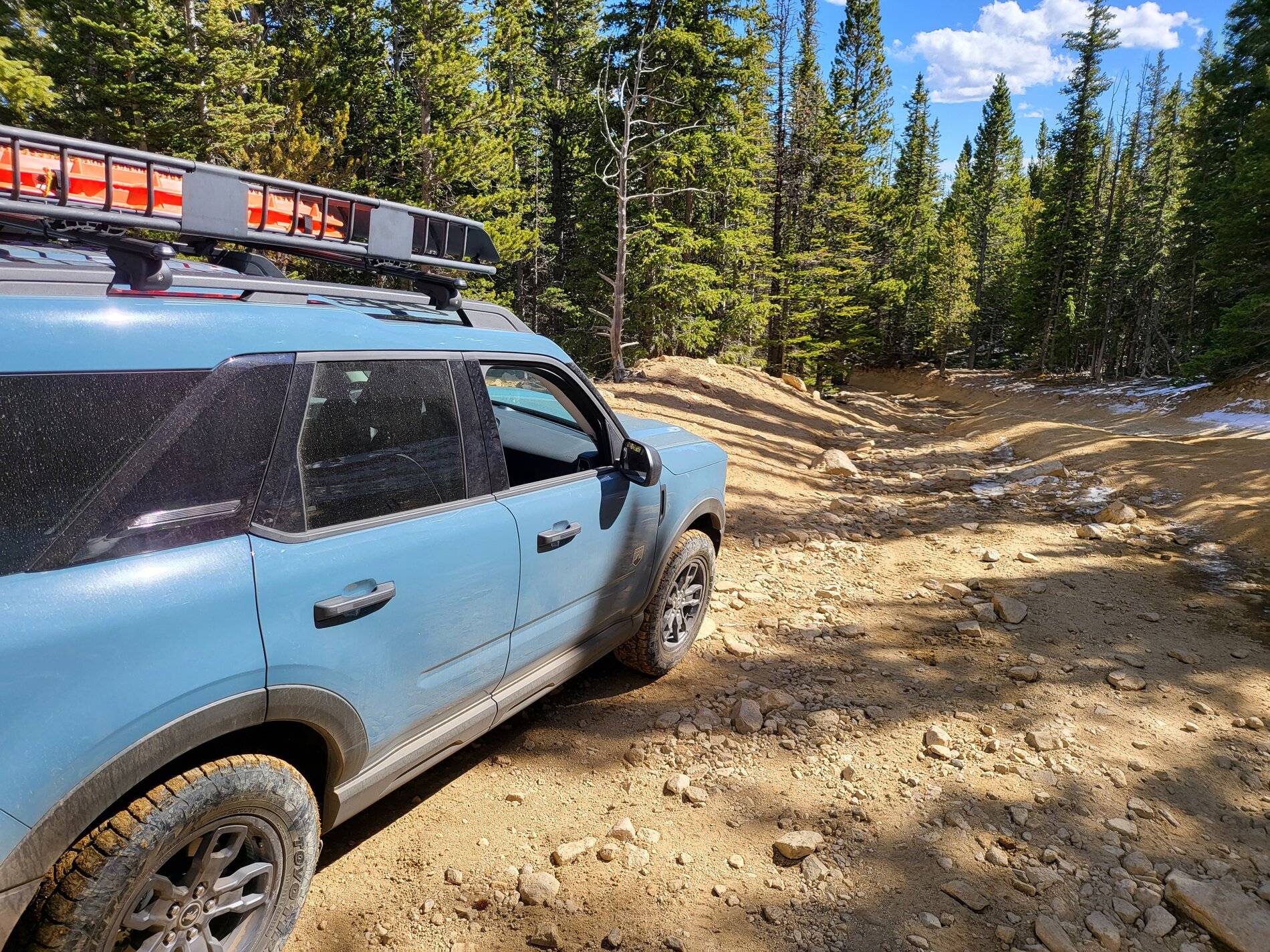

I have recently upgraded my tires to the 235/65/r17 Open Country A/T III so decided to take my Big Bend off roading on what was listed as a moderate difficulty trail (Yankee hill in Colorado). Didn't have any traction issues or anything like that (aired down to 20-25 psi) and for the most part did just fine but did end up scrapping / bashing a few times on some larger rocks I couldn't completely avoid and even managed to brake one of the mounts that hangs the muffler (even the guy at the ford parts center was confused as to how the piece broke. The metal skid plate under the car car scrapped off on the drivers side and is a bit bashed and crumpled but apart from some scratches on plastics doesn't seem to be any other issues.
So that brings me to what are some parts I should swap out to make this a bit more reliable off road. I would like to have full metal skid plates covering all the important parts but i've been a bit confused by some of the posts here with links to a few part number of which areas these actually cover. I was planning to get a lift kit but not sure how effective the 1.5" from rough country really will be, id like the 2" from ford lifts but at over $500 that's way too much for a basic lift kit (should have done this and then bought largest possible tires but too late now). Being on the base big bend i don't even have the rear hitch and doesn't look like there are any front tow points so seems like i need to get something added there (not sure if the tow hooks from badlands can be easily installed or if something like rough country nudge bar would be a better option).
What parts have others added to help getting out in more rugged terrain?

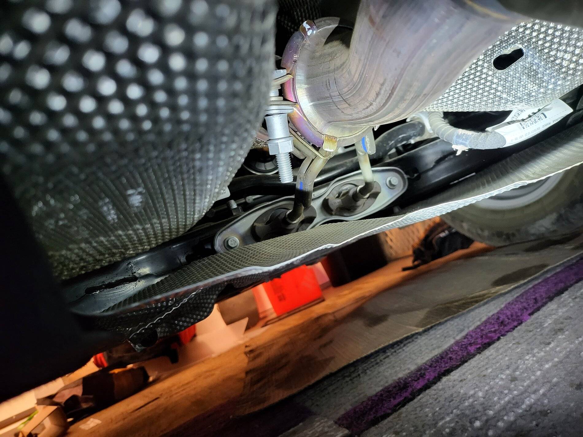

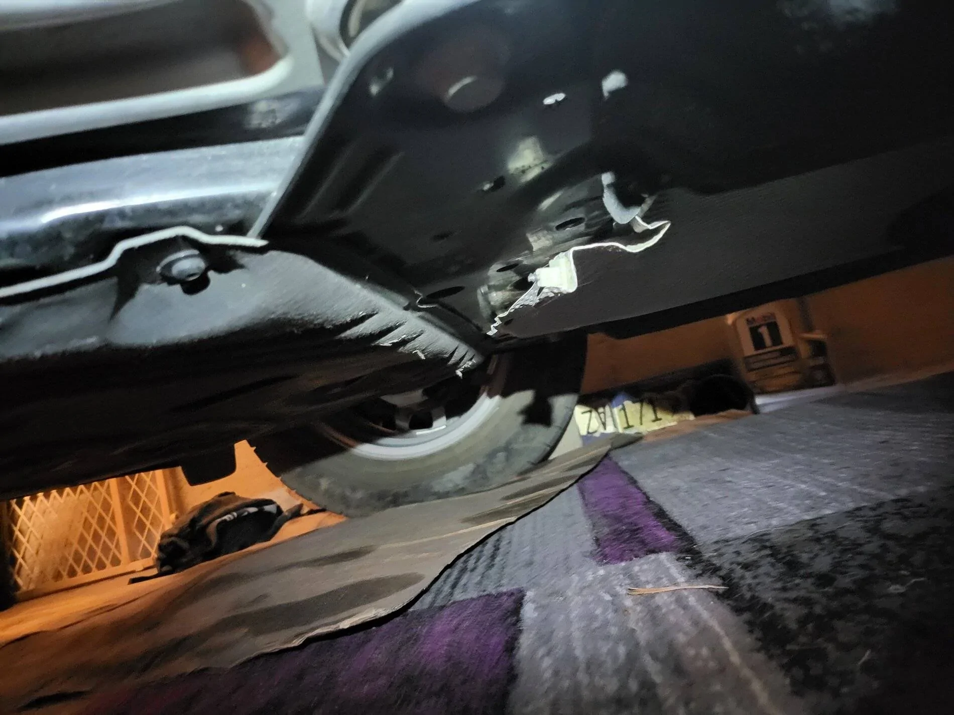

Most important thing to note. The Big Bend does NOT have skid or bash plates. They have composite covers over critical parts. Basically underbody liner.
There is no skid plate protection.
Only the badlands and First Edition have them. Off-roading with anything that can bash under your BB will require skid plates and I do not know of any aftermarket right now for the Base. OB or BB. Hopefully someone else might know.
You are talking about trying to make the BB into a BL. To be rugged you really should move up to a BL and sell the BB or buy a BL and keep the BB. Or buy a Bronco and keep or sell the BB.
The BS BL has the suspension, 2 additional goats, 4x4 lock, twin clutch locking dif, liquid coolant, hydraulic bump stops. Etc.
Do not put a nudge bar on a think it will take the place of tow hooks unless you want to be in a situation where the nudge tears right off and takes your bumper with it. Nudge bars are to push Like if a friend runs out of gas and needs a kind push.
If you are really wanting to be rugged where you are looking to go places that bash underneath and you may need help getting out of, I recommend driving something else rather than spending thousands trying to upgrade the BB. Join the unicorn crowd and order a 22 badlands!
Just my thoughts. I included a outline of the 2021 BS Trim levels To show that the undercarriage protection starts with the BL And in 2022 will only be on the BL as there will be no FE.

don't tug from a nudge bar - or you'll get fudge-barred. and yah, those arent skid plates. thats my one gripe with these sports, why the eff dont they have any protection?
in your shoes, i'd do a lift, get the ford transit recovery hook for the rear, and maybe someone local to fab up skid plates?
