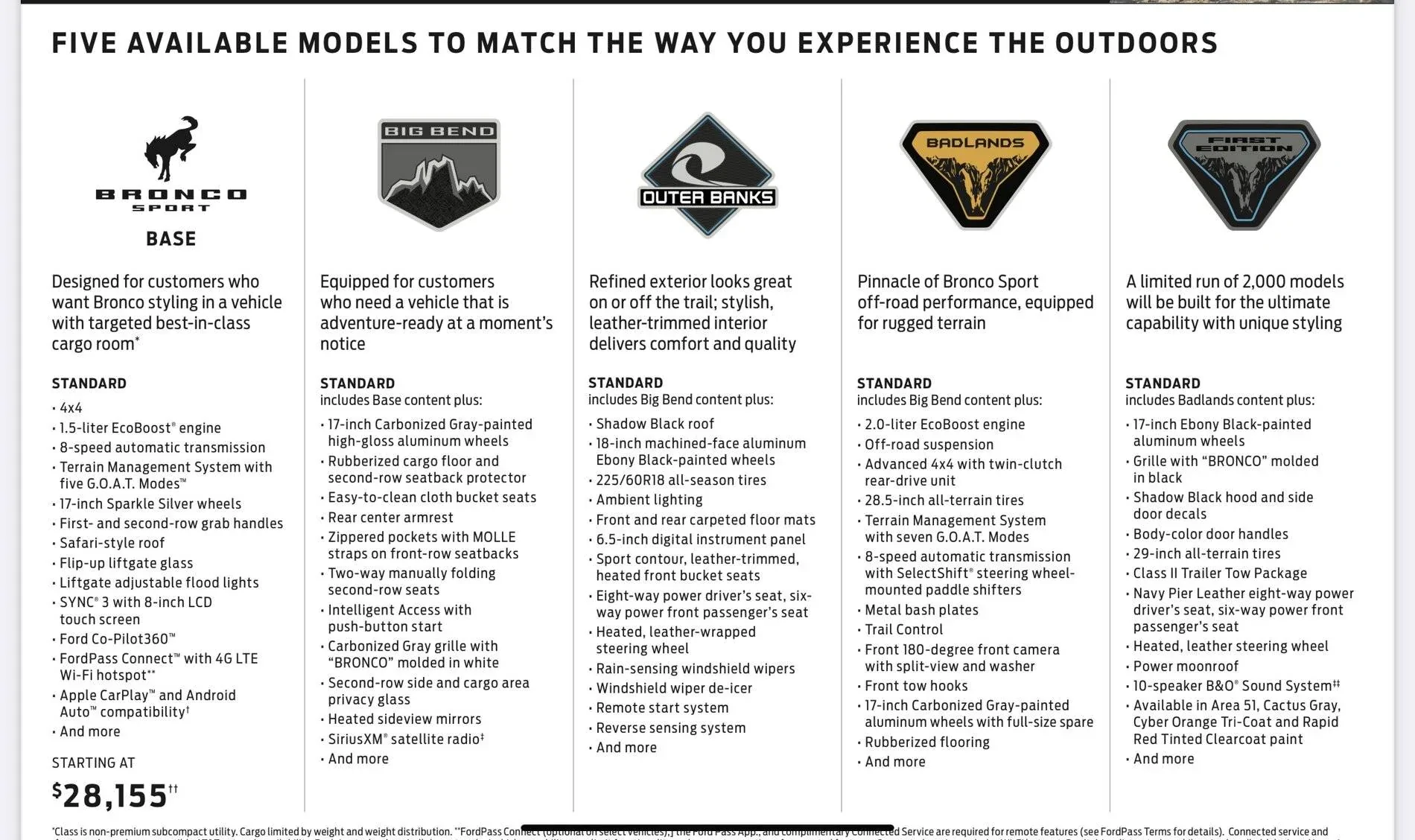

Most important thing to note. The Big Bend does NOT have skid or bash plates. They have composite covers over critical parts. Basically underbody liner.
There is no skid plate protection.
Only the badlands and First Edition have them. Off-roading with anything that can bash under your BB will require skid plates and I do not know of any aftermarket right now for the Base. OB or BB. Hopefully someone else might know.
You are talking about trying to make the BB into a BL. To be rugged you really should move up to a BL and sell the BB or buy a BL and keep the BB. Or buy a Bronco and keep or sell the BB.
The BS BL has the suspension, 2 additional goats, 4x4 lock, twin clutch locking dif, liquid coolant, hydraulic bump stops. Etc.
Do not put a nudge bar on a think it will take the place of tow hooks unless you want to be in a situation where the nudge tears right off and takes your bumper with it. Nudge bars are to push Like if a friend runs out of gas and needs a kind push.
If you are really wanting to be rugged where you are looking to go places that bash underneath and you may need help getting out of, I recommend driving something else rather than spending thousands trying to upgrade the BB. Join the unicorn crowd and order a 22 badlands!
Just my thoughts. I included a outline of the 2021 BS Trim levels To show that the undercarriage protection starts with the BL And in 2022 will only be on the BL as there will be no FE.
(I will also add as a caution that many of us know, even the BS BL has its Achilles heel without a skid for the very front radiator section in front (glass jaw should we say). For BS BL unicorn owners, this should be on a hunt list for everyone.)
Ford Bronco Sport Off roading upgrade suggestions 398A1987-4C0F-4746-A1CD-D13491E06924

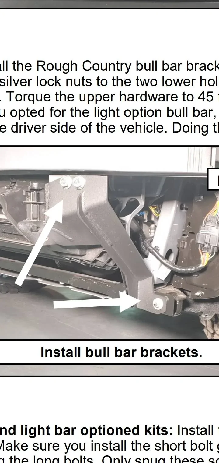

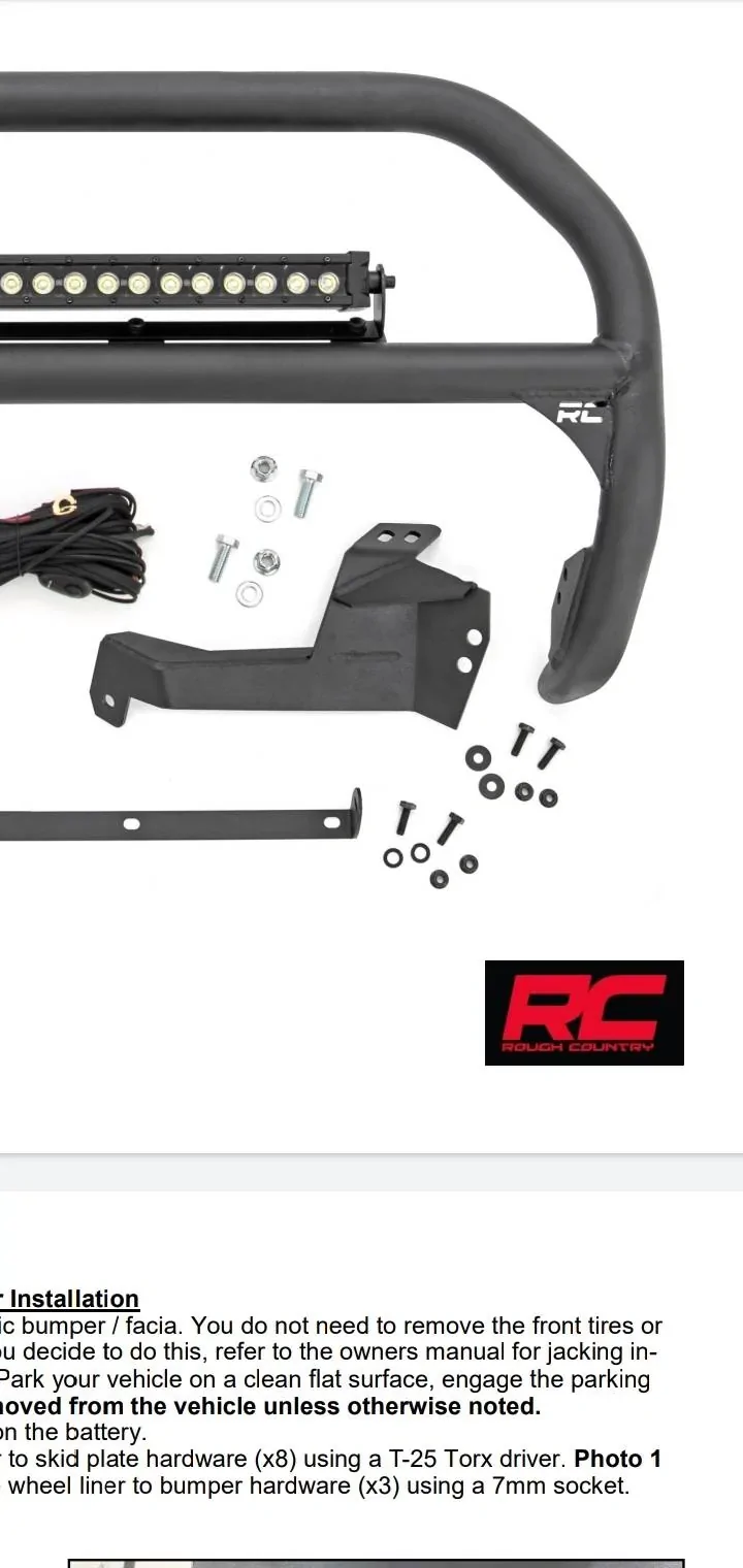

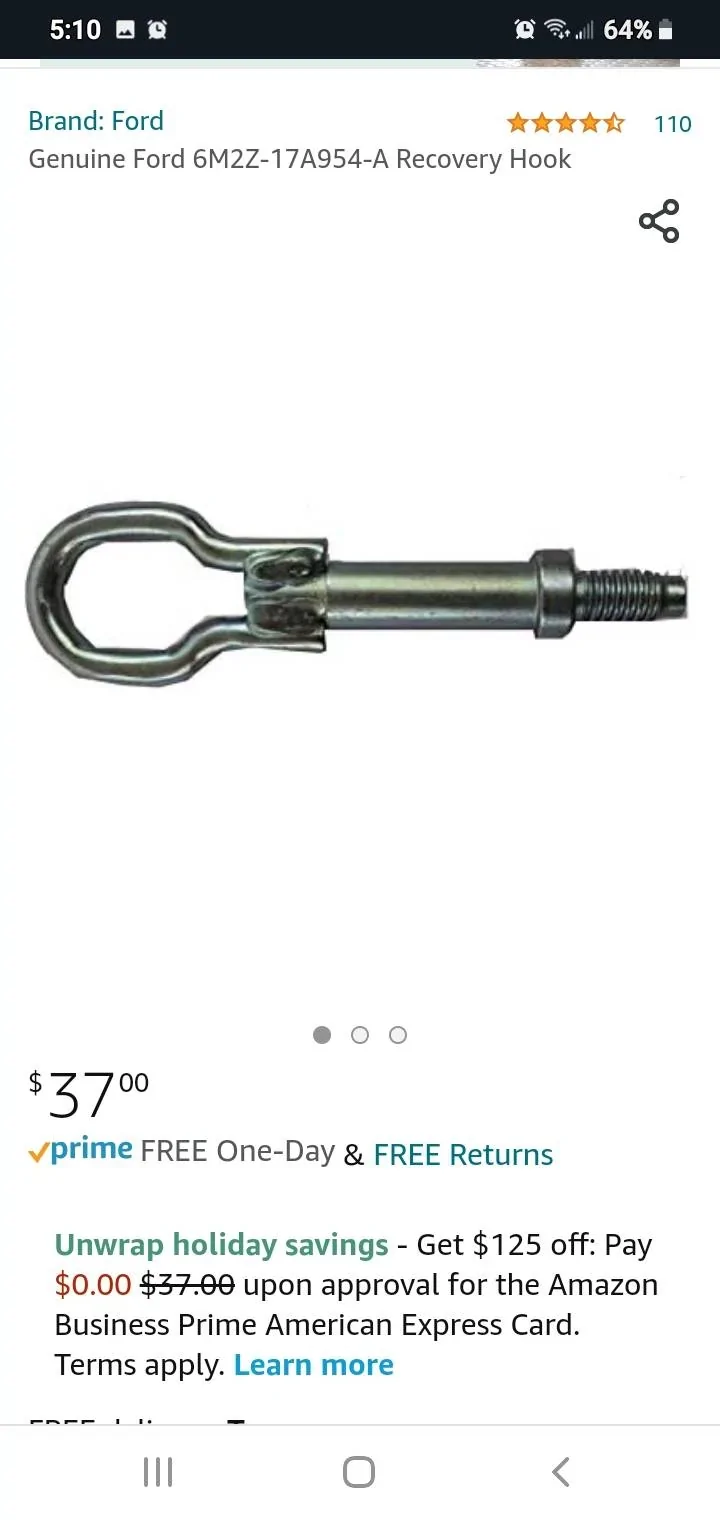

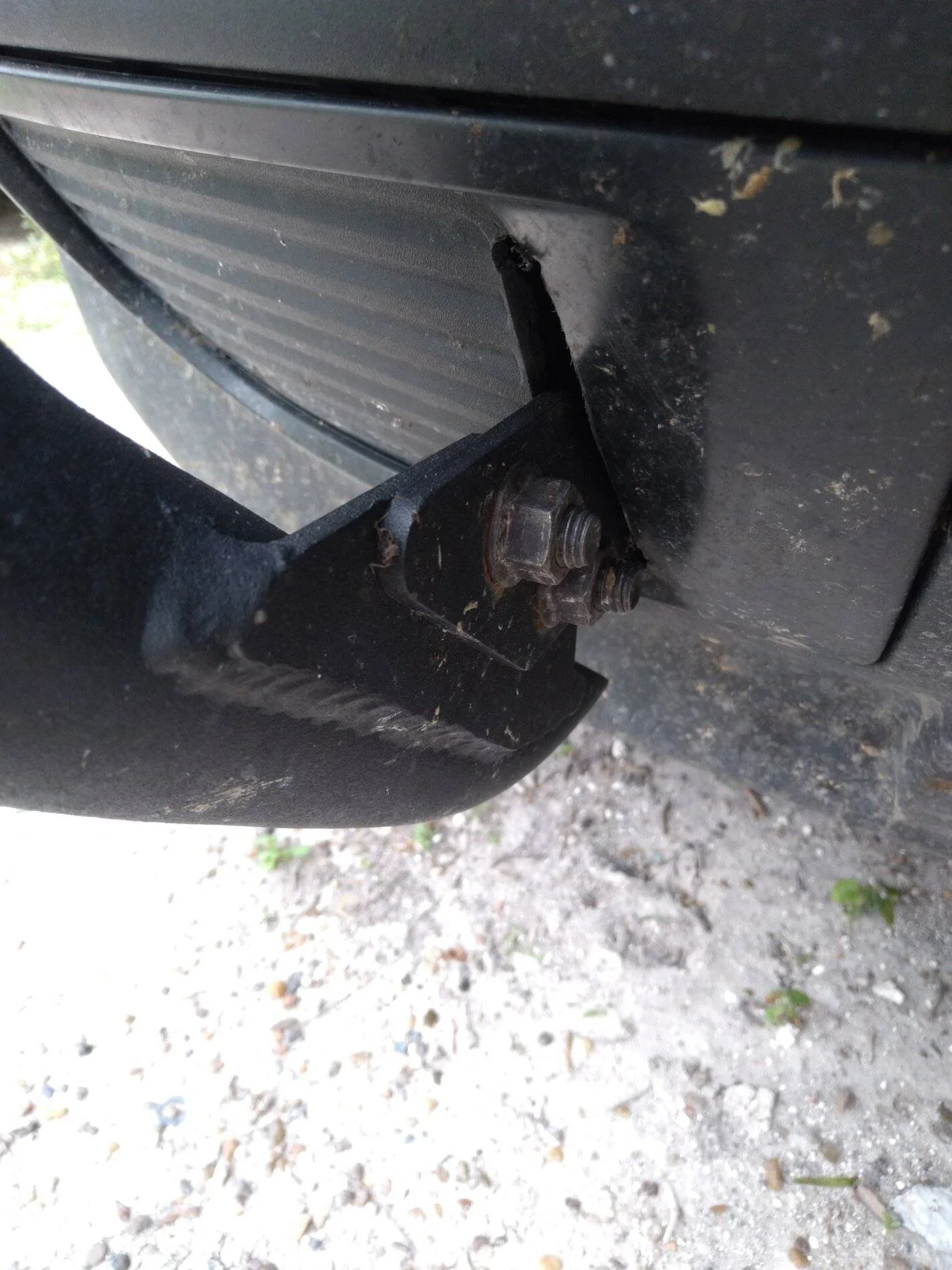

This is the rough country nudgebar bracket and bolt points... like i said ... if it was necessary it could be used .. especially if youre just needing that little help like in sand or slippery mud ... but i wouldnt use it if you were in a serious bind and really stuck qs it could result in some damage ... now with a little modification and step up a little thickness/ strength on the bracket , qnd assuming the tow points were located in the same location as were the nudge bar would connect, i would feel pretty confident using that location/ set up for most situqtions but i wouldnt rely on that little bracket as is on its own
Ford Bronco Sport Off roading upgrade suggestions Screenshot_20211026-161226_Driv
Ford Bronco Sport Off roading upgrade suggestions Screenshot_20211026-161247_Driv
Ford Bronco Sport Off roading upgrade suggestions 16352831594324250626360324130505

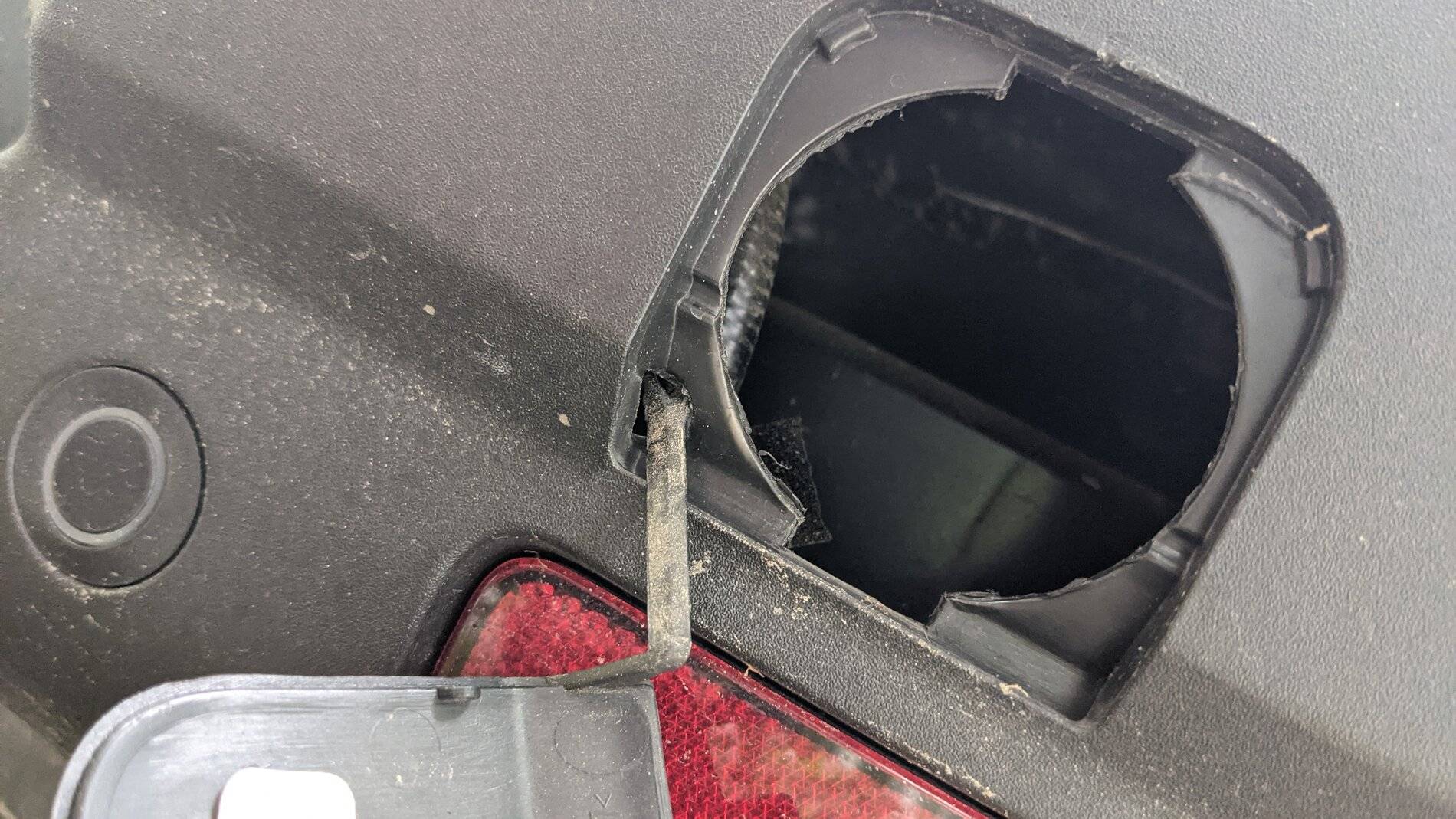

If you have the thread back there, seems to not be there if you got a factory tow package...

Ha .. well how bout that... good news is there are plenty of hitch recovery options ! How strange!

Generally if you have a hitch receiver you travel in front of the person with front hooks, that way it's easier for recovery. Or better yet, just don't get stuck ??

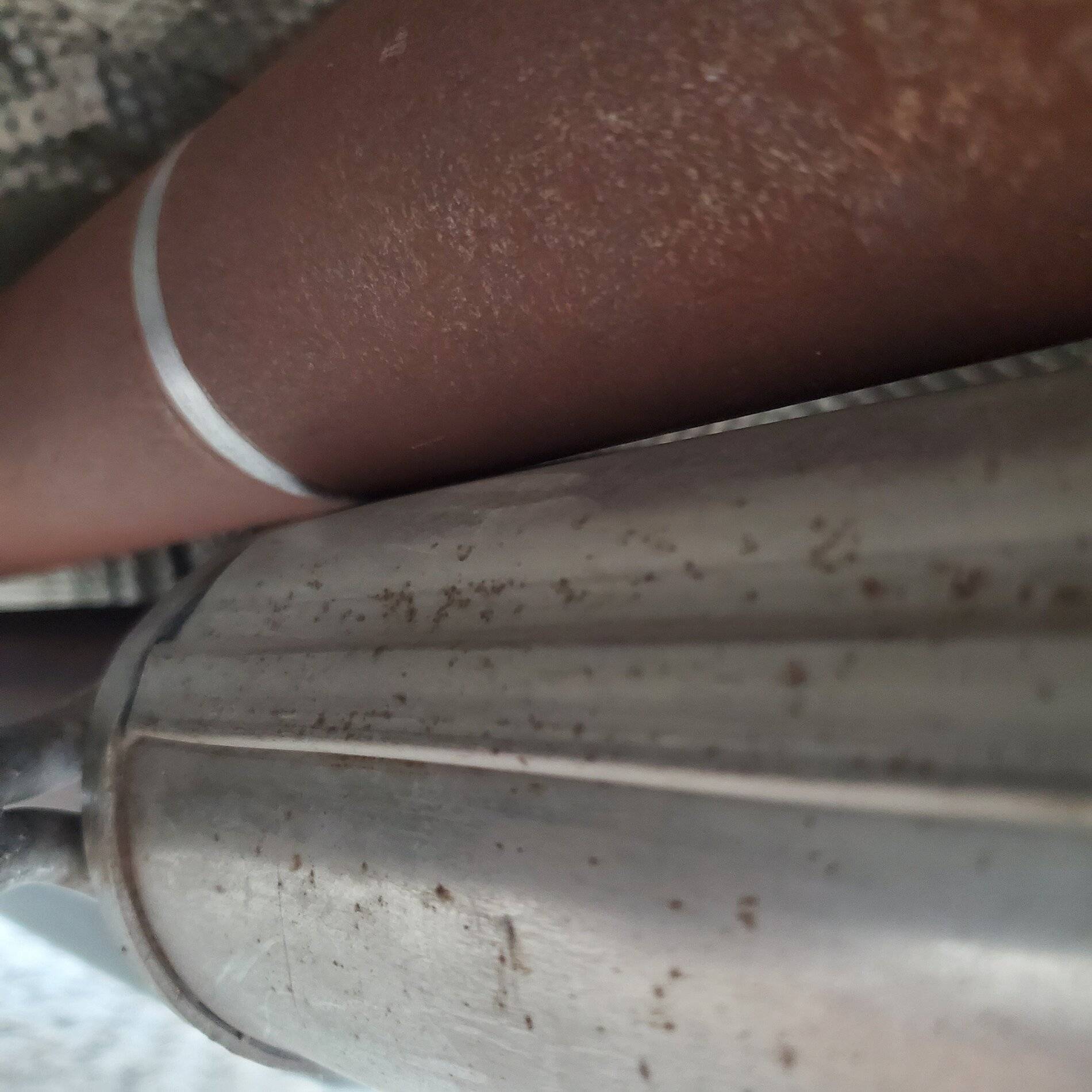

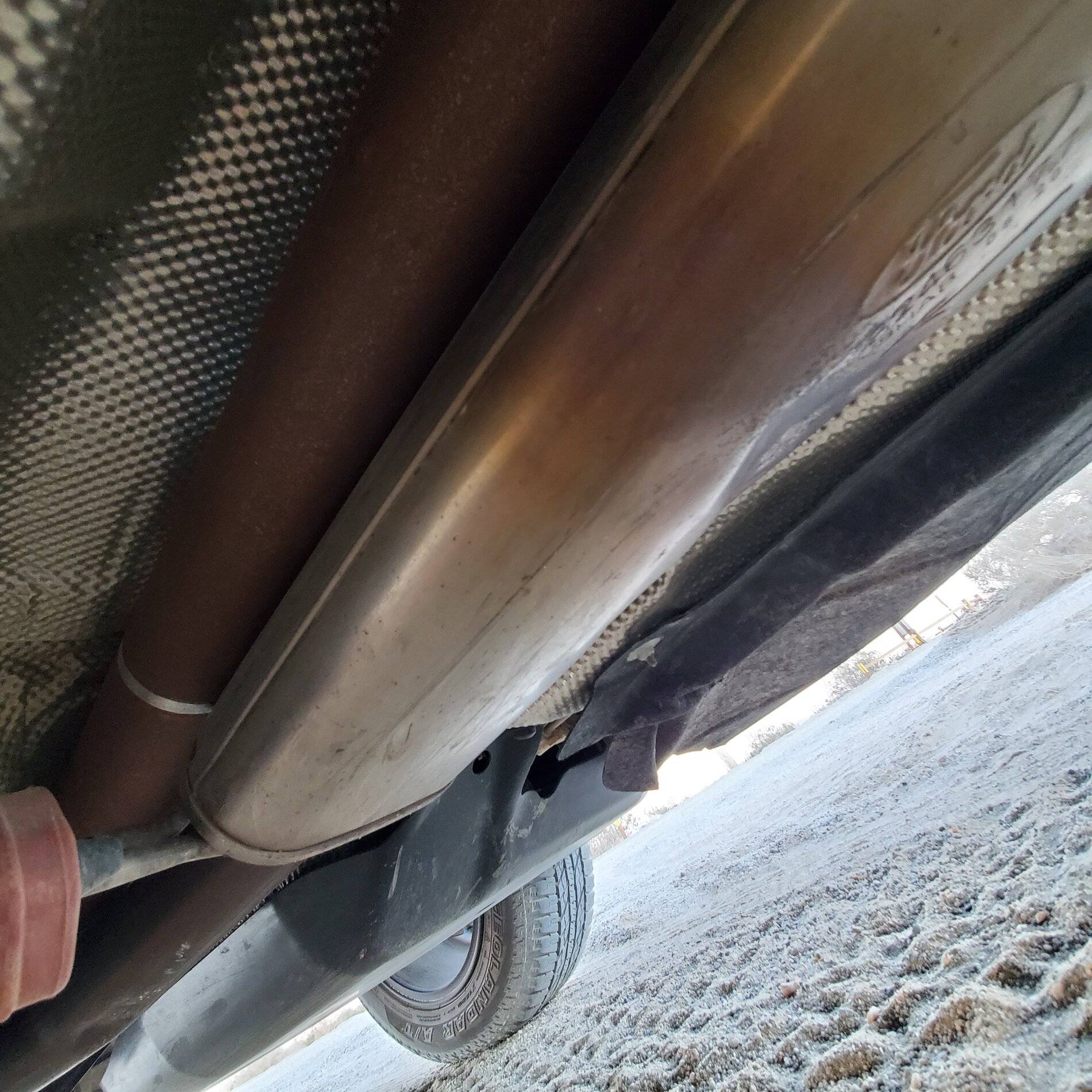

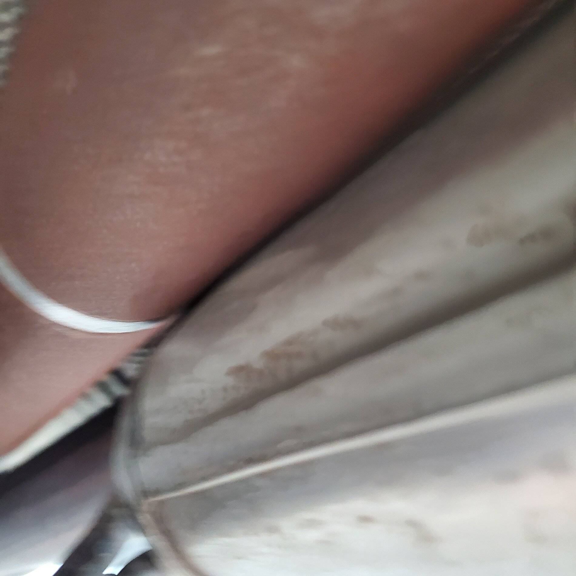

Could not agree more about the bad design on the muffler mount... we had this happen when driving and now the dealership is trying to charge us 2k for a full replacement... essentially the muffler is bent up touching the driveshaft so when it rotates it grinds the metal.
We called Ford and they said there have been other reporting issues with this because the muffle sits so close and any rock, bump etc can cause this...
There's also no protection there...?‍♂
Ford Bronco Sport Off roading upgrade suggestions 20211107_163240
Ford Bronco Sport Off roading upgrade suggestions 20211107_163247
Ford Bronco Sport Off roading upgrade suggestions 20211107_163228

Wow, that muffler is caved in and there's a pretty good sized dent in the tailpipe. Sorry but this appears to be a lack of driver understanding of a vehicle's capability limits, notably ground clearance.
