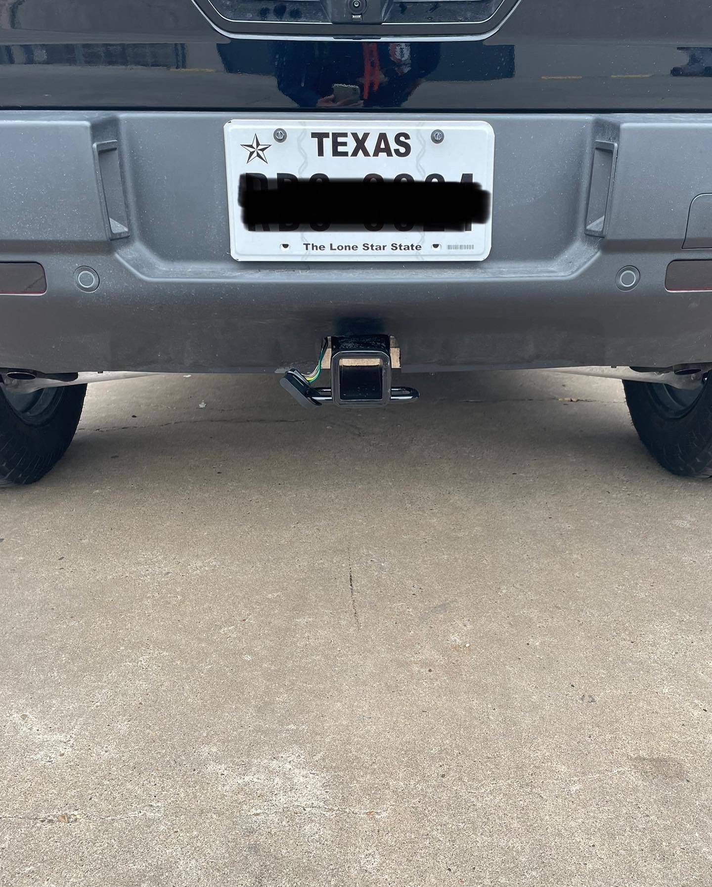

Ford Bronco Sport OEM Hitch Install for 2022 Badlands A150C8F2-61EF-4F4A-9F9C-080F906F8493
Mine hangs and is looped on to reduce hang time. I also bought a cheaper universal wiring harness and not the Ford OEM style. I will use my hitch more for accessories than true towing so I’m ok with how it is, and just wanted the wire harness put in so I didn’t have to add later and pay labor again
I would secure that plug and wire bundle to the hitch receiver.
2,679
3,379
It is. Hard to tell in the pic. It’s looped/connected to where you would place hooks from a trailer.
That’s how my Escape was done. Worked just fine! Your cut out also looks just fine.
