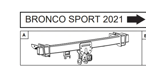

I have a Badlands model with factory tow and I see the ratings are 220lbs tongue and 2200lbs trailer weight.

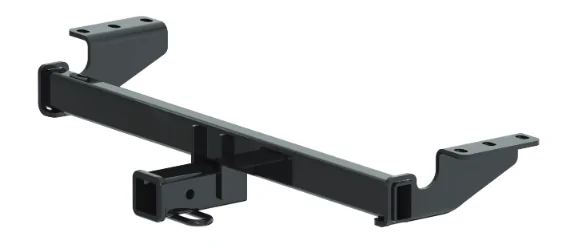

The Curt model for the BS (CMF13474) is rated at 525lbs tongue and 3500lbs trailer weight.
Curious on why they are so far apart on the ratings and if the factory hitch is underrated or if it's purely the design. I understand that the tow rating from Ford was reduced (compared to the Escape) due to the suspension.
Hitch design or reserved ratings?

IMO, it’s only because it’s considered a class 3 hitch with a 2 inch receiver. The Ford design does not appear to be any less substantial. As you said, it’s all in the suspension, not the class of the hitch or the HP of the vehicle.

And that’s what I’m hoping is the case. The 220lb tongue weight limits me quite severely BUT I wouldn’t be hauling anything at great lengths with that much hanging off the hitch.
The OEM hitch looks to have more reinforcements which is why I figured it’s ratings were on the cautious side.

That's not necessarily what the topic is about (despite my reference to the suspension in the OP). Its about the differences, if any, between the two hitches in relation to their weight ratings.
I think it is germane, mainly because I don't think Ford's tow limit for the BS is based on the hitch. Curt sets limitations for their hitches, not for the vehicles they're mounted on. Ford's tow limit for the Escape with a 2.0L, which is based on the same C2 platform as the BS, is 3500 lbs.

Exactly! If the limitation is not structural then that’s the information I like to hear. Completely understanding that the vehicle isn’t truly rated for towing such weights in stock form BUT I have less concern if I need to transport something over 220lbs on a hitch rack a few miles away.
While I wouldn’t expect much R&D from Curt there is a liability involved with providing a rating of their hitch for a particular vehicle and my guess is they are blanketing the rating across the chassis (escape/bs).

I don’t think the difference is due to the hitches. It’s due to Ford’s rating for the BS. I think a big factor in that rating is the fact that the BS is unibody, rather than having a sturdy steel frame to mount the hitch to. I think if you start pushing anything over 220, you might bend/tweak something. The hitch will be fine, the unibody, maybe not.

It has nothing to do with the hitch as much as the vehicles rating.

the question is why Curt is claiming far greater ratings on their hitch for the Bronco Sport (which folks are going to go off of).
Curt's ratings are for its hitch. Ford's ratings are for its vehicles. Curt's website states "[t]railer hitch weight ratings are limited to vehicle manufacturer's stated capacities."
In short, Curt's hitch is no more durable than Ford's OEM hitch. The limitation listed in the Owner's Manual is based on the vehicle, not the hitch.

I bought the curt. Easier installation did not have to remove any part other than lower the exhaust about six inches. Curt is a class 3 with stronger weld support. I would think putting on a bike rack and hitting some off the pavement swales May end up putting more strain on the hitch than 200lbs so class 3 it was.
