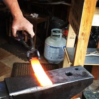

Yes I'm so sorry I've been in the shop forging knives lol..... I took her to the dealership and they actually took me for a LONG ride so I can pin point the " Rattle" and of course she didn't do it, its been over 24Hrs and no rattle has happened. They did say if it happens to bring it back any time.
Ford Bronco Sport Odd, Soft Rattle Noise at Low Speed/RPM When Downshifting at Low Gear 160333306_887343905422137_1230317784381665070_n
Ford Bronco Sport Odd, Soft Rattle Noise at Low Speed/RPM When Downshifting at Low Gear 146243970_498025131597123_4704153189045113703_n
Ford Bronco Sport Odd, Soft Rattle Noise at Low Speed/RPM When Downshifting at Low Gear 147069579_265281814983238_3608676221469269343_n(1)
Nice Damascus pattern beautiful work
