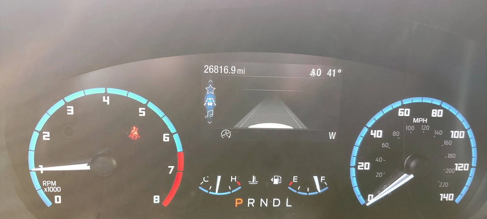

Hi all. 22 stock Big Bend with 26K. I noticed that I cannot make changes in the sub-menu "driver assist", it is frozen on this screen. All other menus on the dash display work fine. Is there a way to reset this or do I have to pull off the battery cable to see if that fixes it? Thanks!

I would try disconnecting the negative battery terminal for a few minutes and re connecting.
There's too many electronics in new cars. If not that might be something with steering wheel controls. Sometimes in my work truck 2020 f350 randomly the volume button will change the mode. Seems to only happen on really cold mornings

I updated to the latest software (23188) but that screen remains the same. Maybe it supposed to be that way?

On my 22 BB, that is the screen I get when "Lane-Keeping Assist" is OFF (you turn it ON and OFF via the button on the end of the turn signal stalk). When it is ON (and meeting the conditions specified in the Owner's Manual), I will see the lane lines in various colors depending on what the camera sees as "lanes". There's nothing to change via the menu button on the right side of the steering wheel (hence nothing happening when pressed). The items that you can change in LKA are found under Settings > Driver Assistance > Lane-Keeping System where you can set the mode to Alert Only, Aid Only, or Alert+Aid. You can also set the Sensitivity. Hope this helps. Cheers!

Thanks, yeah I figured this may be the case since I did figure out the settings to change sensor sensitivities and such is on the main Sync screen and not the dash display menu.
