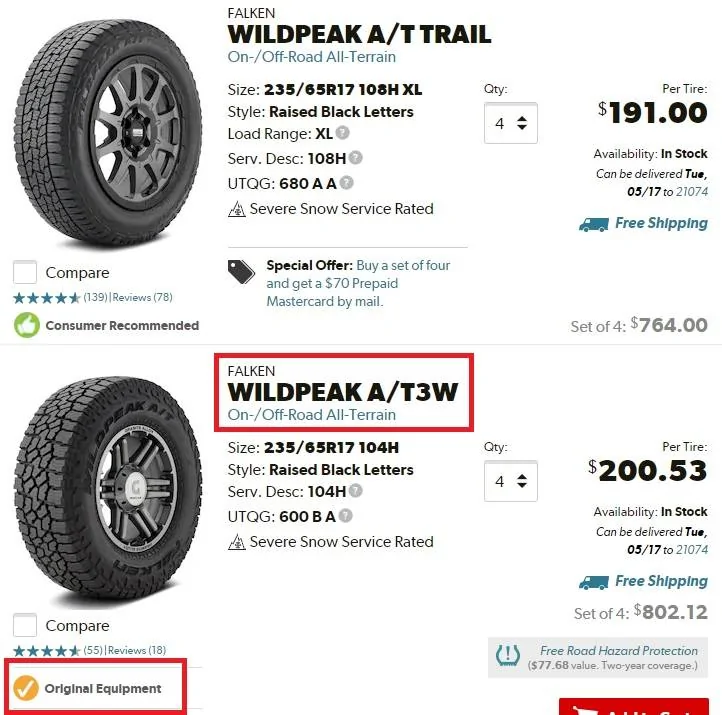

Tire Rack is showing two different Wildpeak tires in the 235/65R17 size. The A/T3W is the OEM tire. The A/T Trail is not. So not all Wildpeak 235 tires are OEM tires only the A/T3W is the OEM tire.
Ford Bronco Sport New Spare for new Badlands Wildpeak Tires

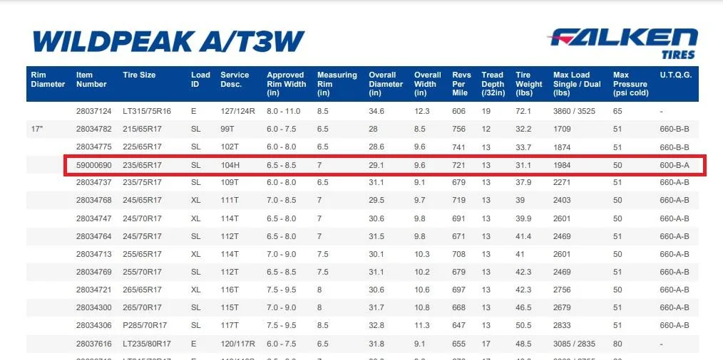

Yeah its weird Flacon designed the Wildpeak A/T3W 235/65R17 with lighter weight side wall and slightly different tread pattern to reduce noise per Ford specs. But the 225 and 245 A/T3W have the heavier stiffer sidewalls and regular A/T3W tread pattern. So anyone who buys the 235/65R17 A/T3W gets the Ford spec'ed tire because Falcon decided they are going to do one tire in that size/model and it will be the different Ford spec tire.
Note how the 235 tire is lighter then the 225 tire even though it is a bigger taller tire:
Ford Bronco Sport New Spare for new Badlands Wildpeak Tires Sizes Specs
