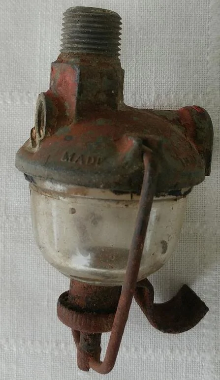

as the last bit of fuel sloshes around inside the tank
solid contaminants to fuel ratio greatly increases
repeated low fuel occurrences yields greater potential for filter contaminant exposure
fuel filter located inside the tank
bad scenario
repeated low fuel occurrences yields greater fuel filter contaminant exposure
bad scenario
I think this used to be an issue with older cars utilizing metal tanks. The "contaminants" in that case was corrosion flaking off the inside tanks walls. Our cars use a plastic tank, thus no corrosion. The only way contaminants get into the tank is through the filler port or suspended in the fuel. This is a good reason to stick with stations that offer Top Tier fuel. Even if you don't use Top Tier fuel the filtration systems on modern fuel dispensers are quite a lot better than they were in the past.
All of that's to say I believe the danger of contaminants clogging your pump filter to be significantly less than overheating the pump.
correct you are sir
internal corrosion is not the factor pertaining to contaminants in this case
however I would add the word introduced in this situation
possible poor fuel selection
or simply the lack of a proper screw type gas cap
consider some of the off road driving conditions
and what is the only thing between your fuel and the environment
a spring loaded fuel hatch cover
far from being hermetically sealed from particulates
the potential risks exist
how many owners visually check the opening before fueling
rare happening is my guess
