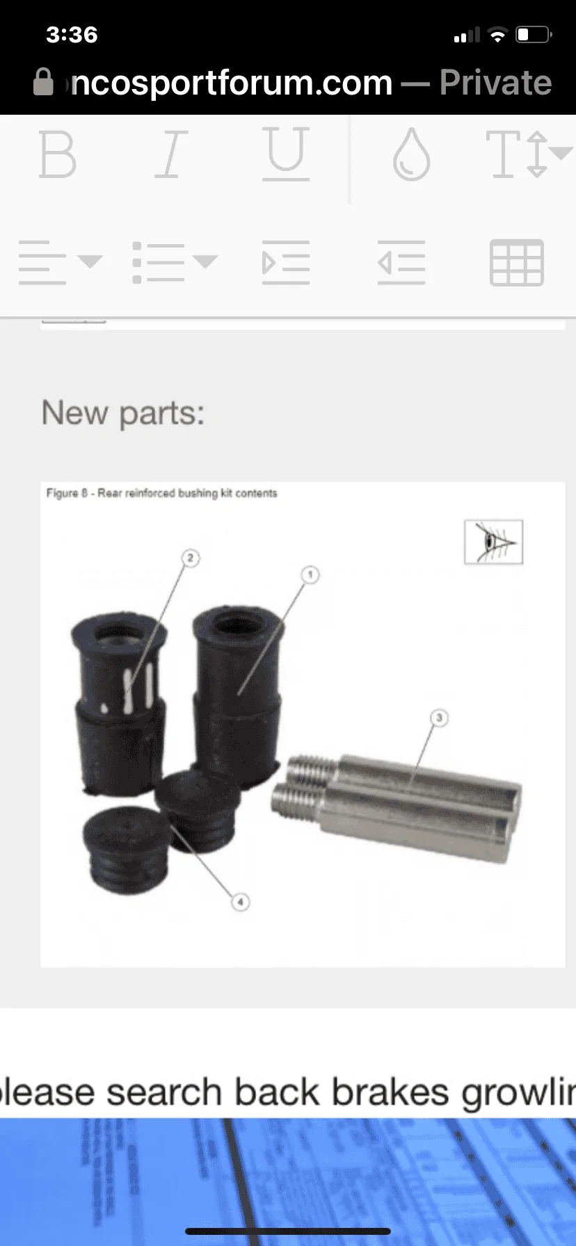

Ford does. Have had this issue since new and had gotten worse after tsb.
Only option I have is to pay out of pocket and have it fixed like I had to with the alignments I had done three times by two different dealers. And still had awful pull and poor handling at highway speeds.
Magically got fixed after Ford said they wouldn’t cover it anymore and I paid out of pocket for it. Been fine since then.
What specifically did you do that actually fixed the issue? I'm also in the camp of TSB completed but noise returned even louder.
1,325
1,288
When installing bushing the one with the white plastic that you can plainly see gets installed on the bottom of the caliber and the all rubber bushing goes in the top pin and grease the pin only not the end's .

I’ve been debating going to a dealer and having them address this with the TSB info, but seeing some say it got worse makes me nervous. Is it worth taking the chance? Anything I can do to increase the odds the fix works?

But seriously, though, there is a ton of discussion throughout the forum on this topic. Ford has issued a service bulletin to address the problem, but some have reported the noise returned after getting the work done. I don't believe Ford has a definitive solution yet.
Can you share where you saw the service bulletin? I have the same issue and not getting much help.
