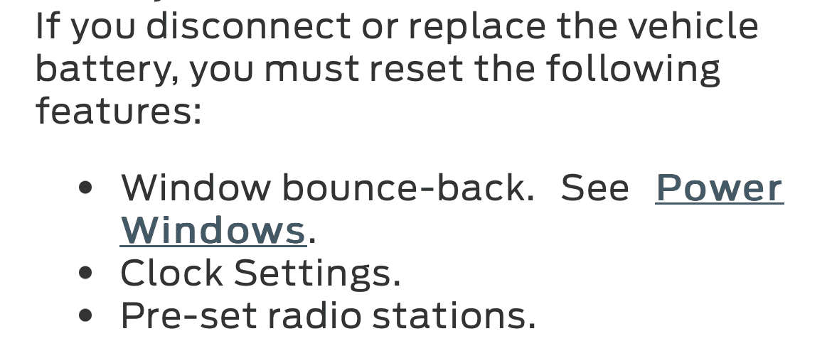

However … my ‘22 owners manual does not list steering angle sensor in that same section, it only says..
Ford Bronco Sport NEW BATTERY 1699368587694
Maybe it's not actually necessary.
I don't know for sure if this was done on my BL but everything works as normal. Forgot to ask.
Could be they hook up temp power to the battery cables to possibly not having to mess with all this.
I didn't lose radio stations or clock settings.
