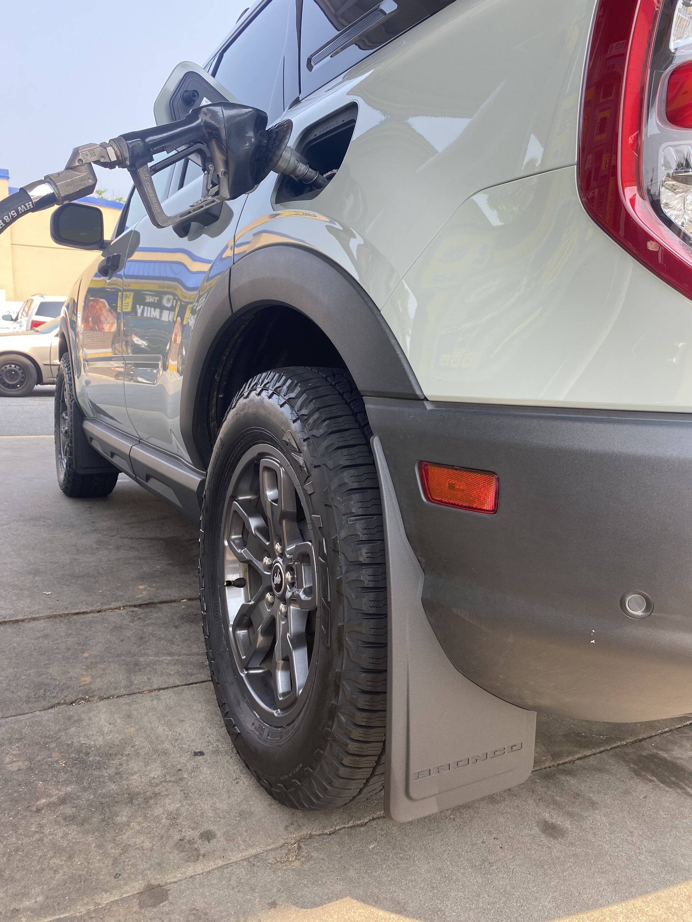

I was in the same boat as you and only got about 32k miles out of the stock tires (awful in my opinion) so I swapped out for the Falken Wildpeak A/T Trail tire in 235/65/R17. They are an awesome tire and not as aggressive as other A/T tires, especially their AT3W counterpart. I haven't had them more than a week but my mpg hasn't decreased much and the road noise is a little noisier but nothing noticeable. Also the warranty on the Wildpeaks is 65k miles, can't beat that. The ride is so much smoother than the stock tires and I feel completely planted on the road.
Overall Highly recommended.
Ford Bronco Sport Need new tires! IMG_5544
Did exactly same last week (same size as well, 235s). Very pleased with the ride quality, was worried that they would be louder and rougher than the Pirellis, and that hasn't been the case. Realistically the BS spends a lot more time as a commuter (all weather including the occasional snowstorm), but also needs to be acceptably capable for mild trail, as well as regular access to Rockies skiing (the Pirellis actually were fine in this regard). Last but not least they do look 100% better on the BS than the Pirellis!
