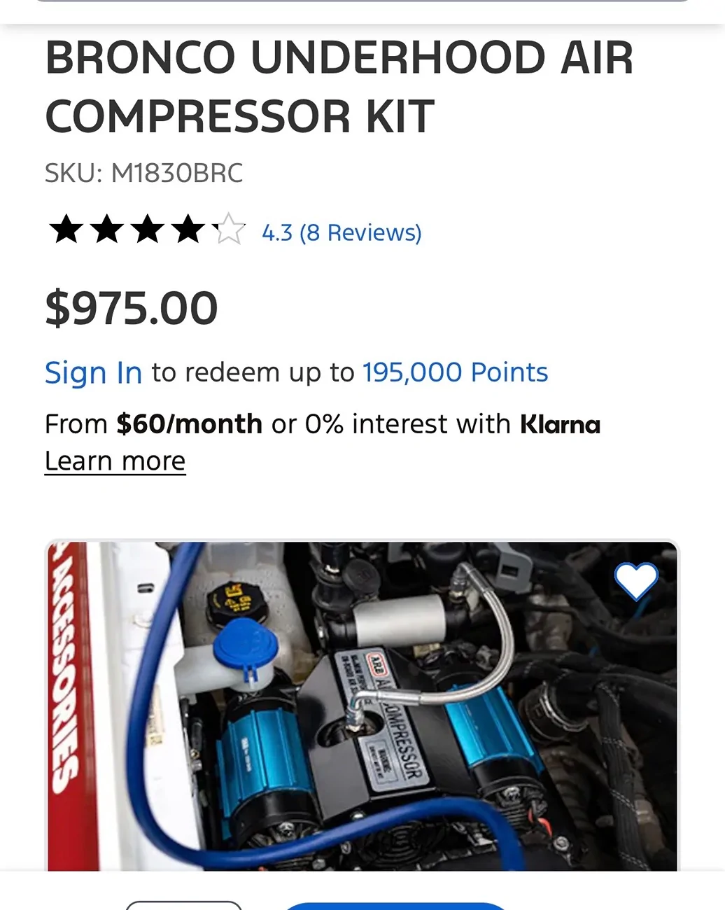

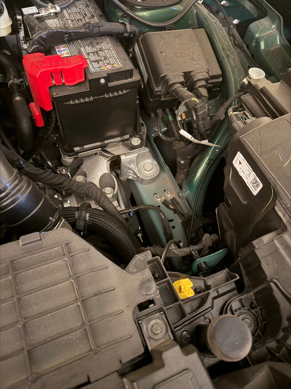

It looks like there is space around the battery on the 2025s
Perhaps not this high $$$ one shown for the Bronco but check out the ARB products

yeah i just went out and checked my bronco and yeah so much space, insane, i will check it out for sure, thank you for the information

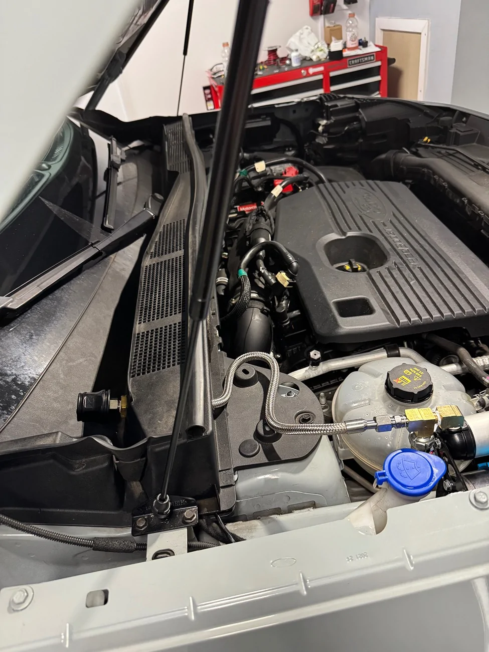

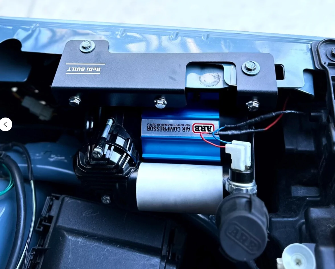

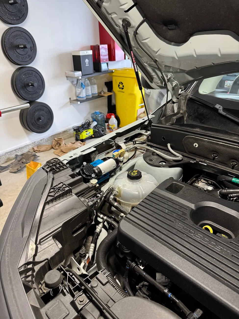

Doesn’t really help you with a 2025 but I stuck a compressor in my 21. Routed an air chuck tucked right under the windshield for easy access and I don’t have to open the hood. Hose coils nicely in the seatback pocket

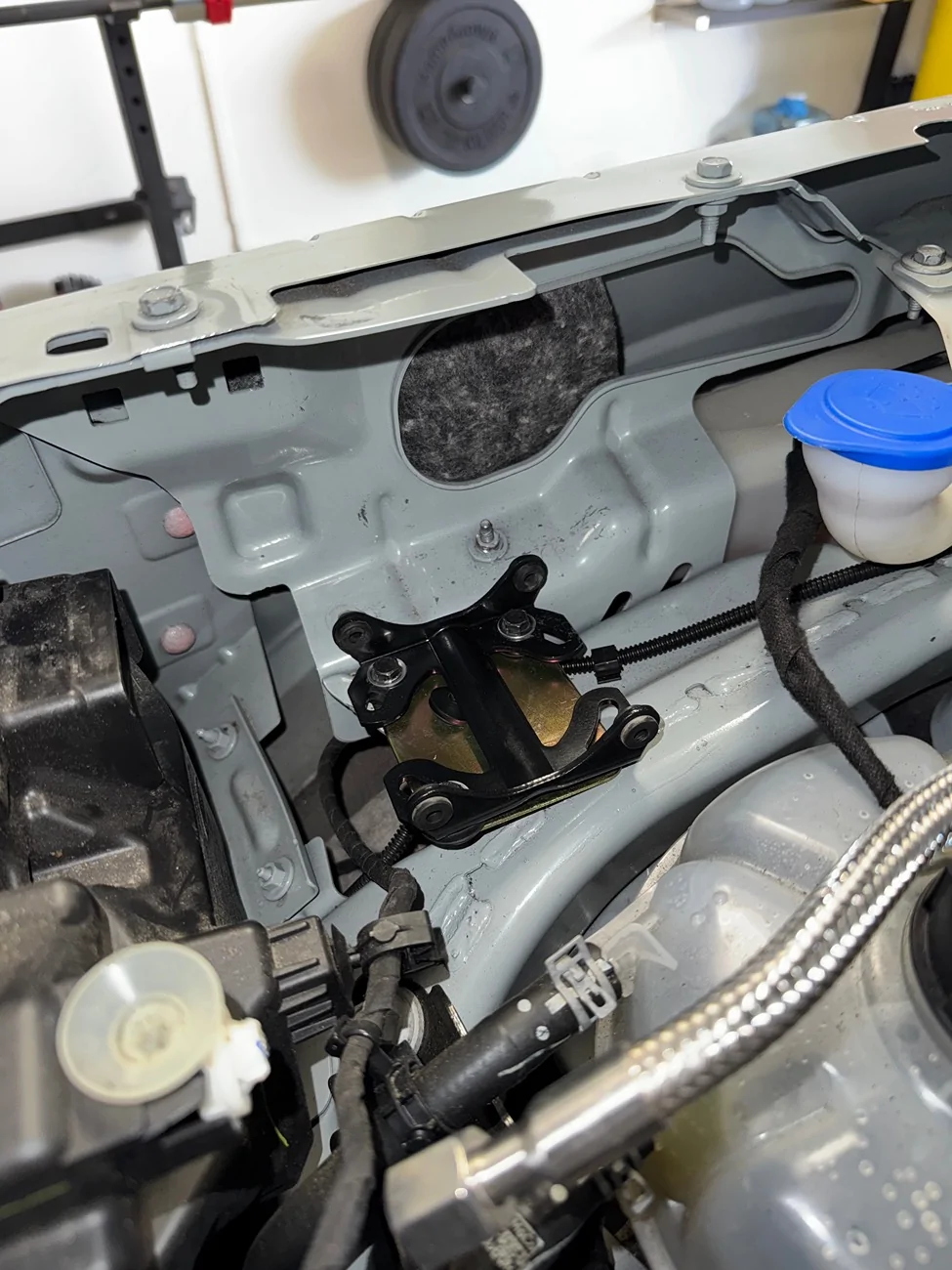

There was a bracket it just happened to bolt nicely to, had to get creative with the orientation. It’s tied into my existing switch system I made (look at my other posts)

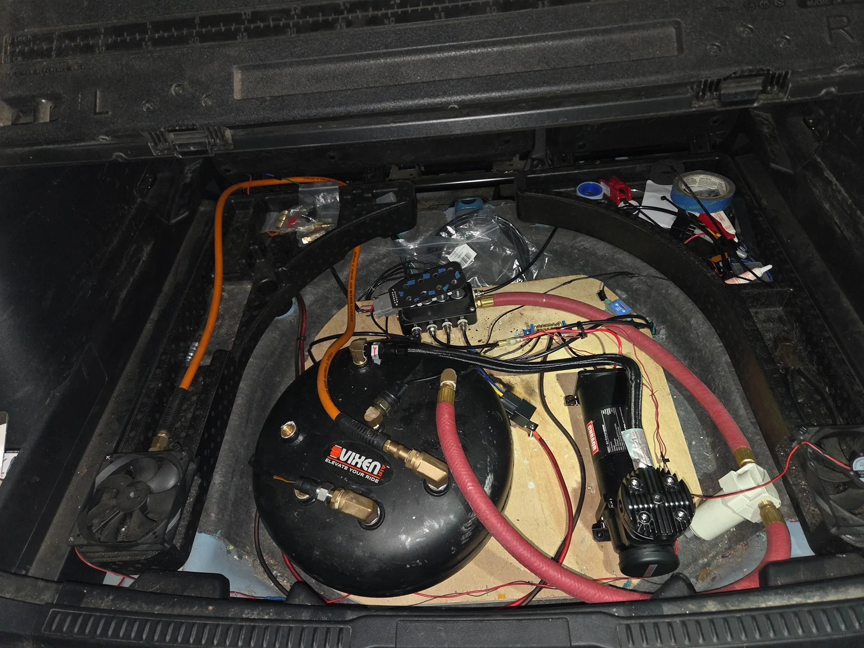

So I have onboard air, but it's from air suspension but I can say it's pretty easy to do.You just gotta find the room, however it looks like other people have found a spot under the hood. If you don't need a big tank, it shouldn't be that bad.I would get one of those all in one units though.Cuz, I'll upload a picture of my air setup for my air suspension, and it basically takes up the whole room where the spare tire was.But that's because I wanted bigger three gallon tank that was round and would fit in there good.
and I used a real air suspension compressor like a Viair although i'm using the cheap amazon brands and they've been working this whole time and haven't given me any issues but they're pretty big.
Also for my setup, at least you gotta make sure and get the proper size or gauge wire and you gotta get the proper relays and stuff.But it's not that hard.I had never done air suspension before.And I did it on my car, and I just put it all together myself.I didn't buy a kit, my kit just included the airbags. But that orange hose, that hooks up to the tank and i've run air tools off of it.I've aired up friends tires and it took just a couple seconds.So it works really good.But remember, the smaller the tank, the more often your compressor is going to have to run.But you can put your compressor and your tank in different spots and just you just have to run hoses between them.
Ford Bronco Sport Need idea for a Onboard Air 20251011_182649
