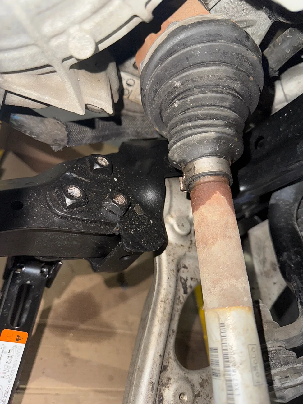

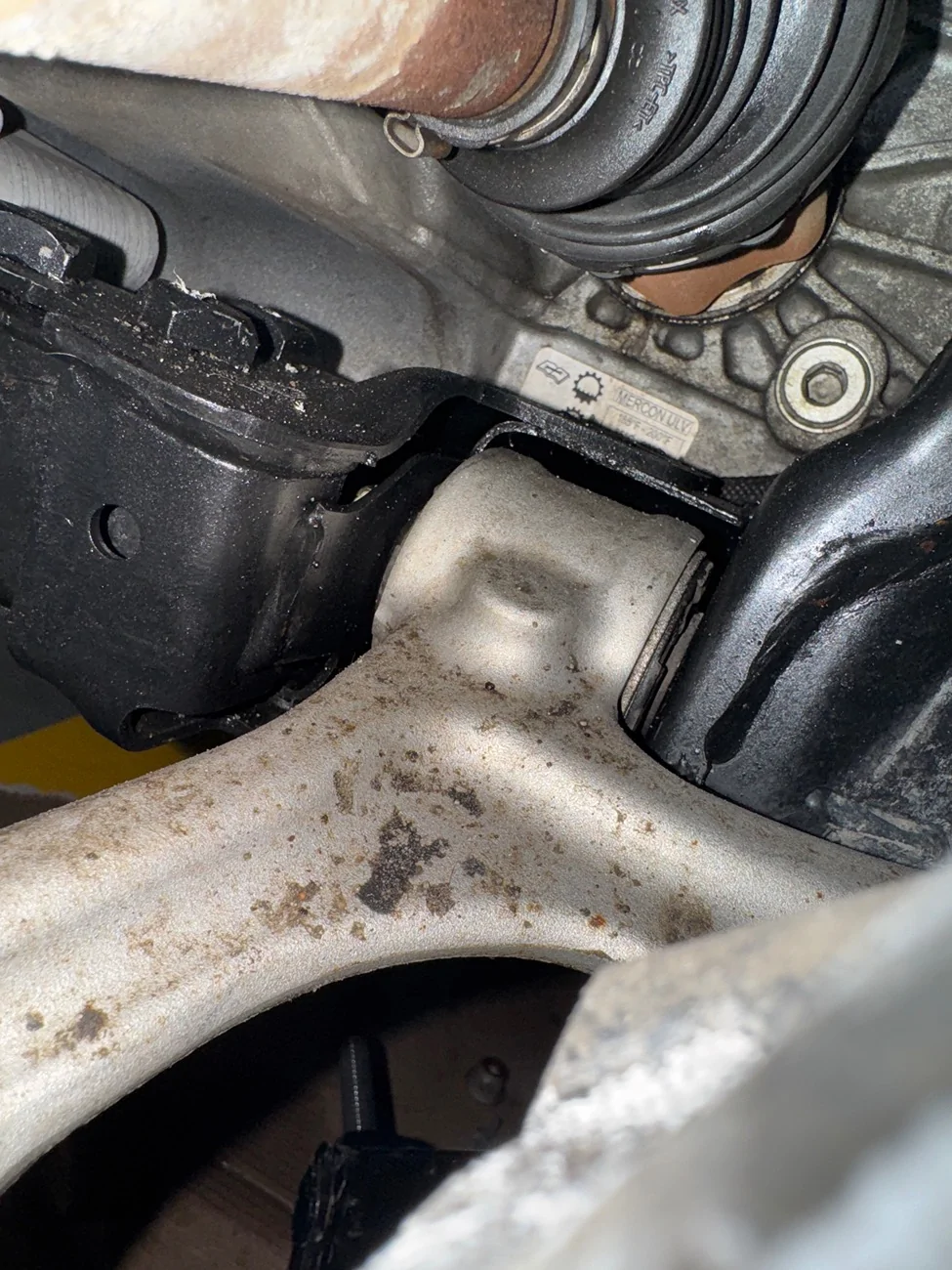

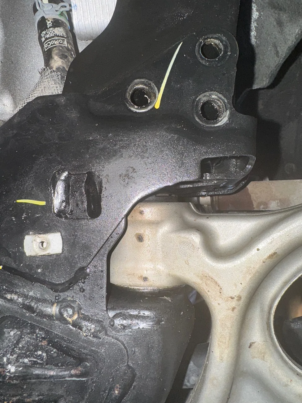

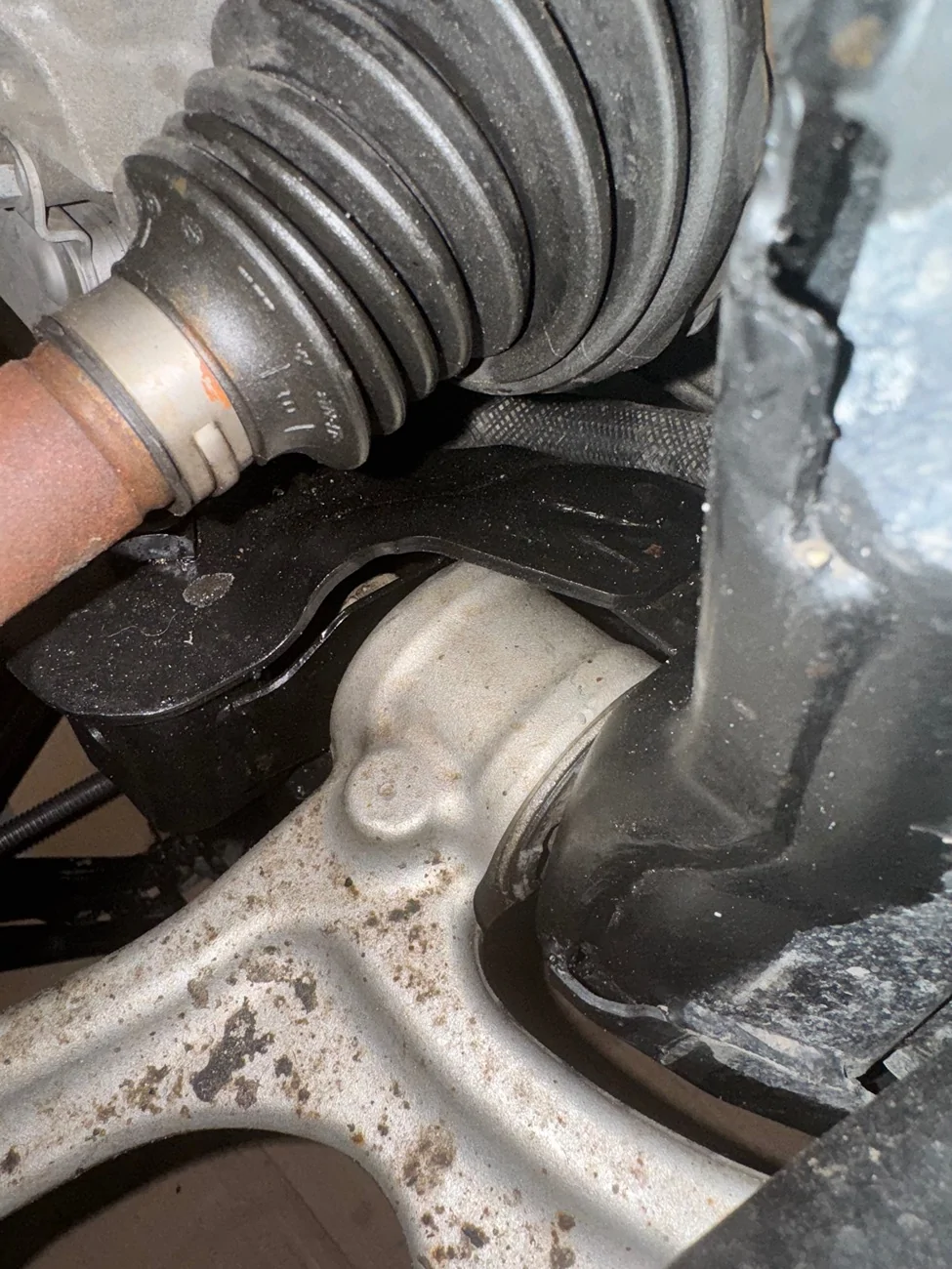

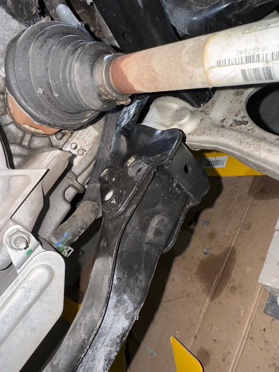

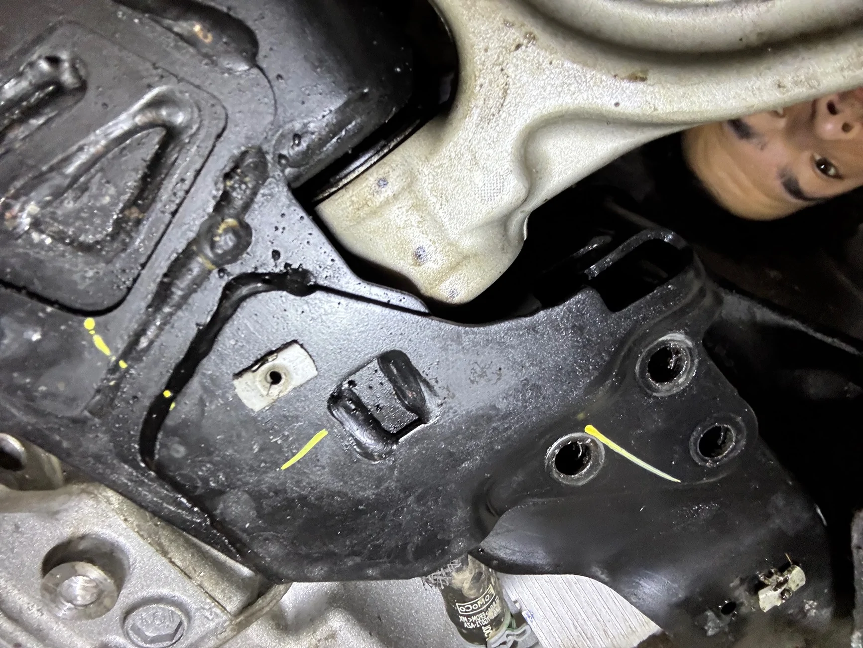

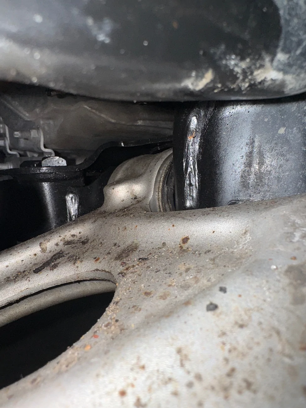

Howdy everyone,
First off want to say the bronco sport big bend is the best compact suv for light off roading and it being your first vehicle.
Anyways, I hit a curb and now the bearing in the rear lower control arm is destroyed. So I decide to be a responsible car owner and try to replace the entire control arm by myself. I have done a couple of mechanical works here and there and I always follow the manufactures or expert advice. and if given advice I ensure to learn more about it. Anyways as I removed the lower ball joint, and rear bearing I hit a wall and saw a subframe bracket shield covering the bolt head or nut I need to screw off. I then remover the outer tire rod end, and the sway bar to give me some more room.
really bummed out I was moving along so well and get stuck on something like this.
Does anybody by chance know how to take off the front bearing of the Lower control arm that is cover by the shield for the subframe brakes that cover the "ears" of the subframe where the front bearing is clamped in a bronco sport.
Ford Bronco Sport Need help figuring out how to get the front bearings off a front lower control arm on bronco sport big bend 2024 tempImagey01UDC

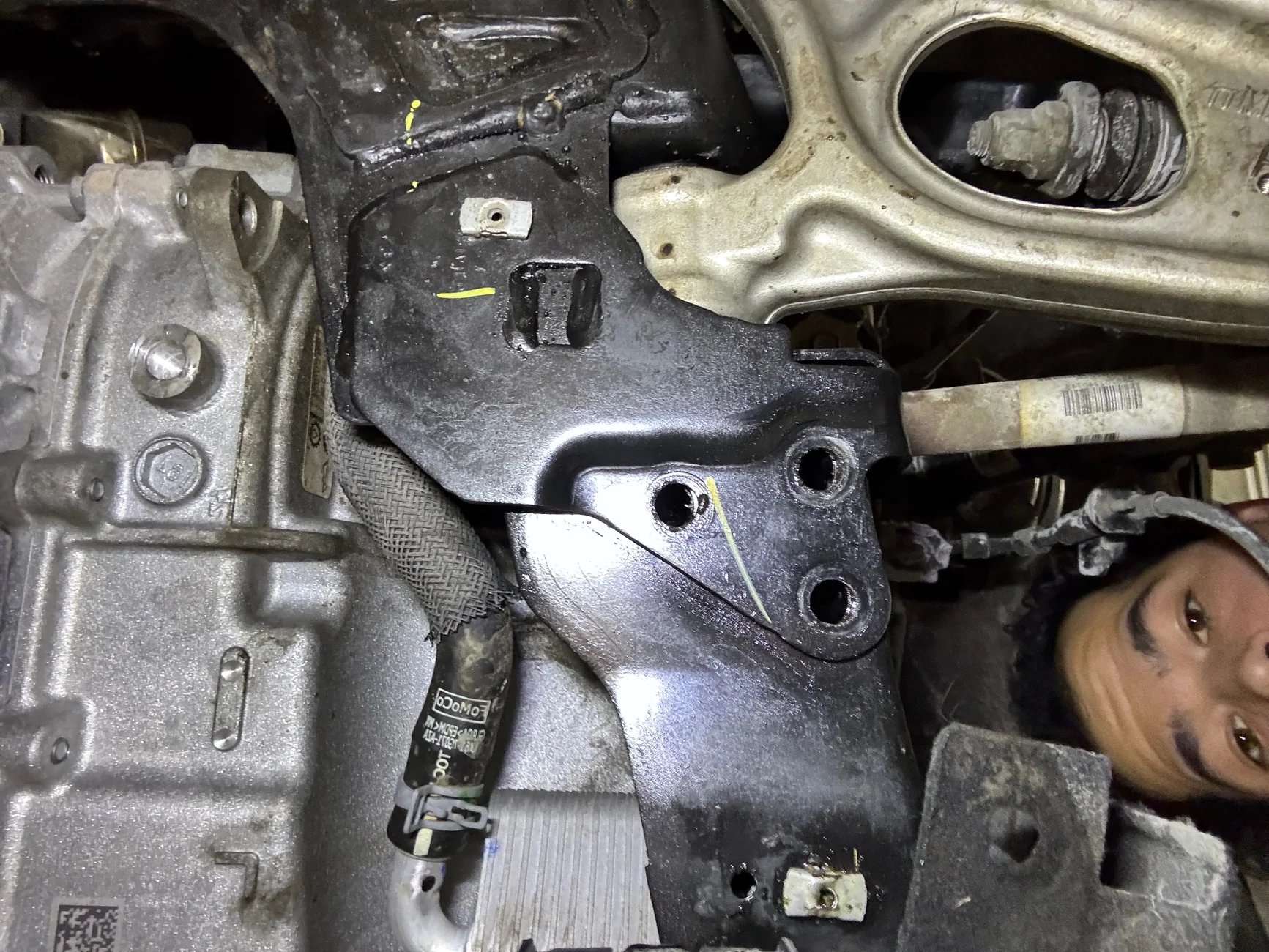

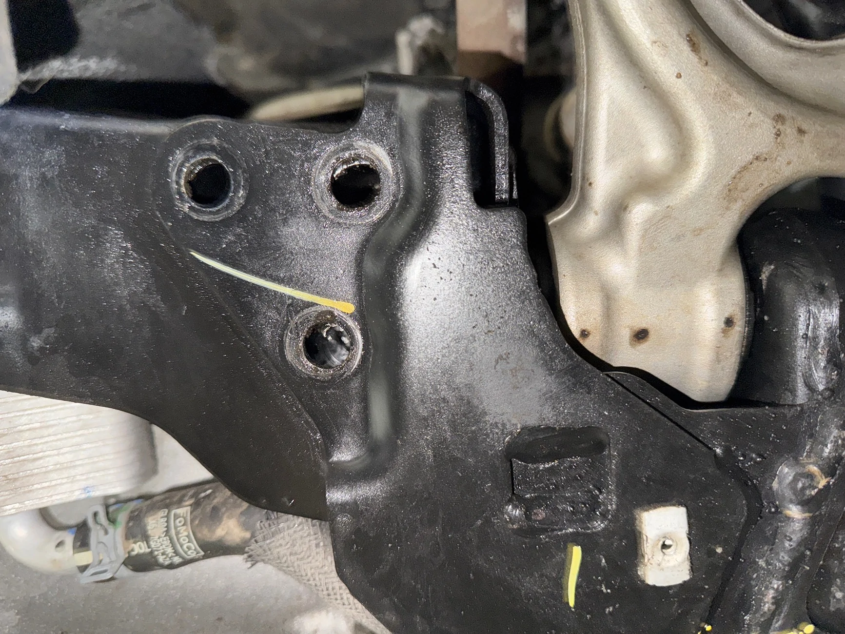

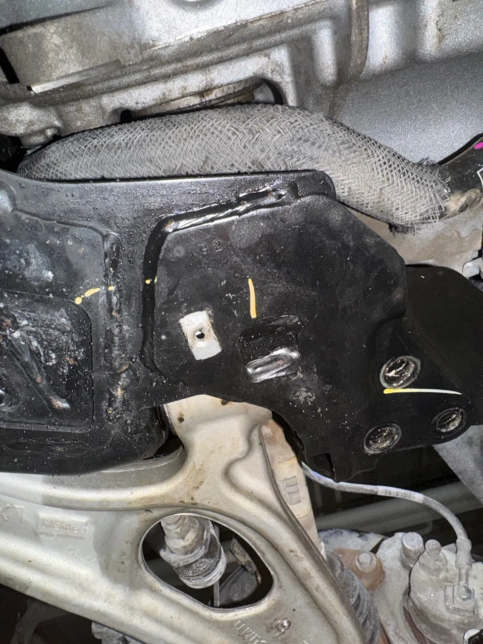

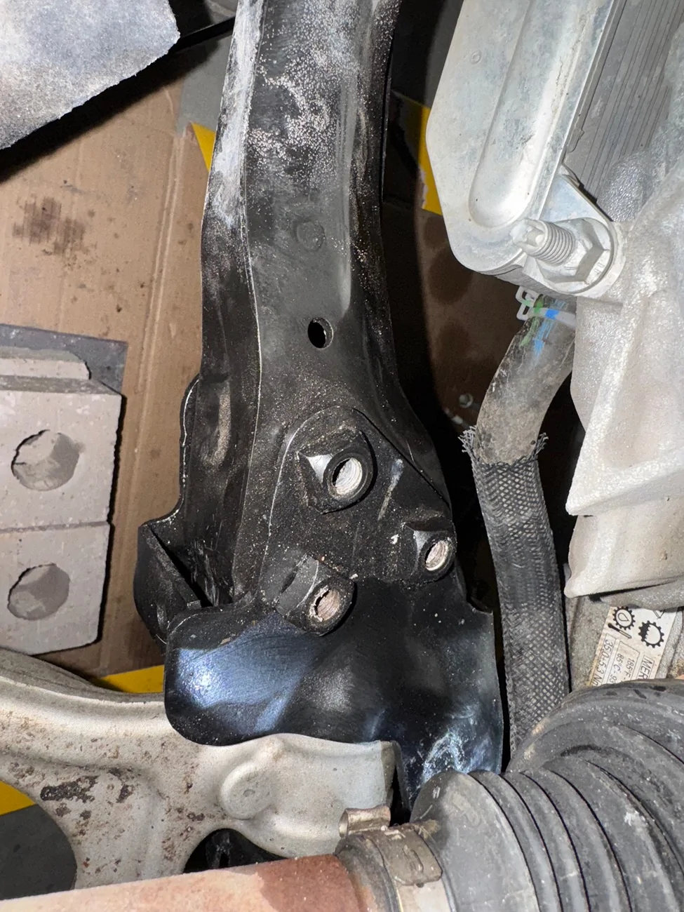

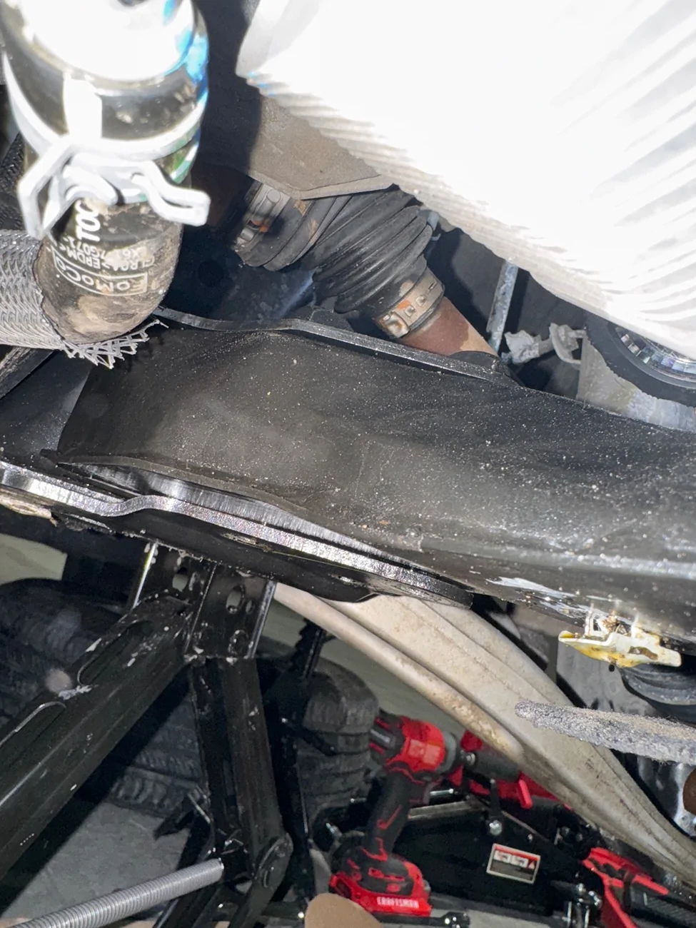

that looks very much captive, which is strange. i don't see how you can get to the through bolt that secures that LCA through that bushing. you would need to hold one end and loosen the other. looks like they put the LCA in and kept welding the sub frame around it.

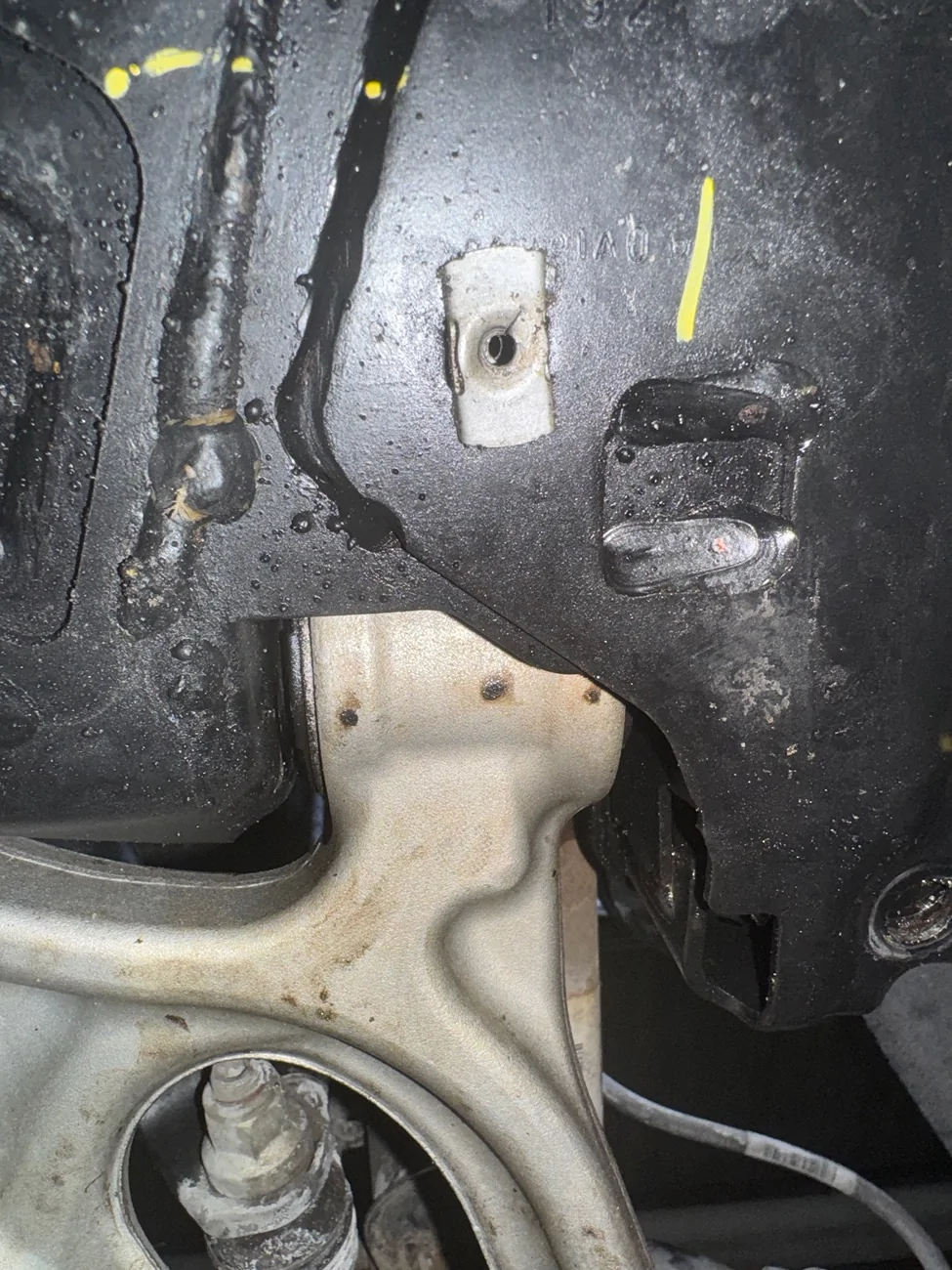

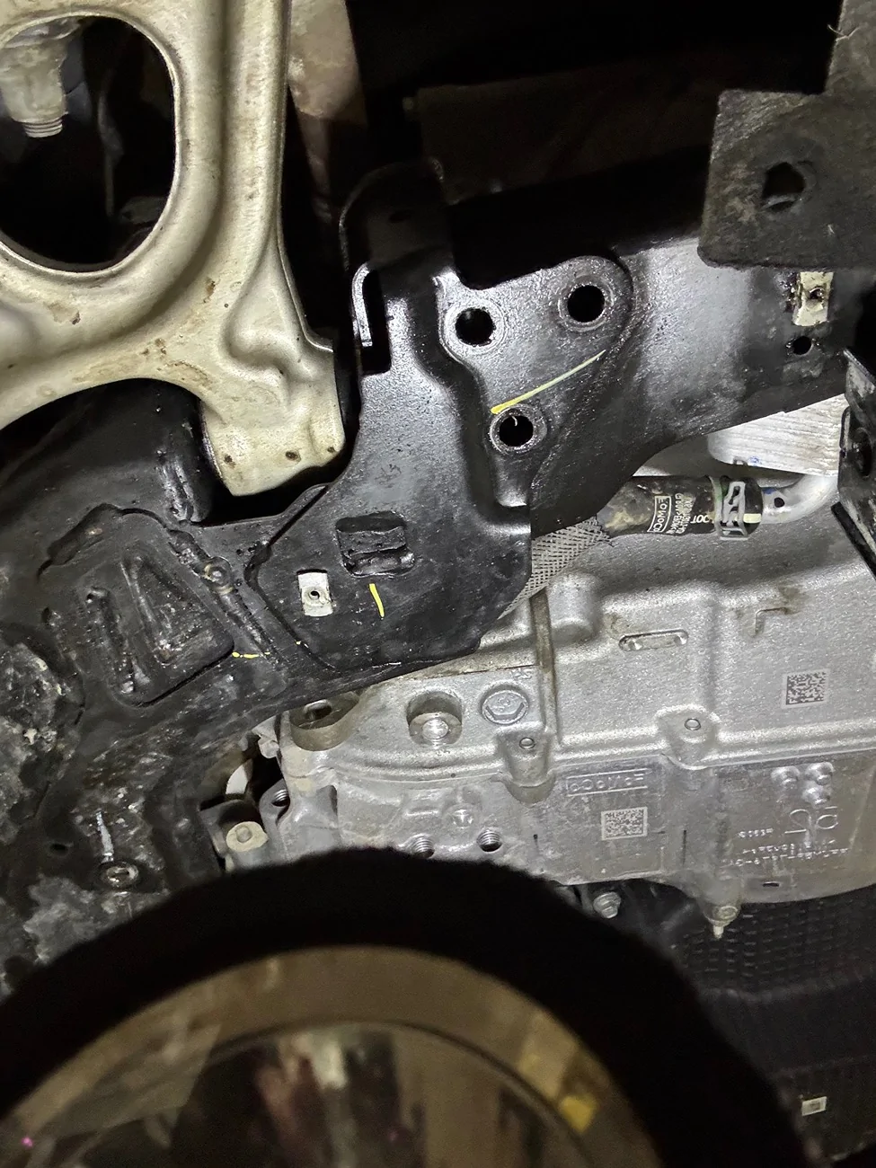

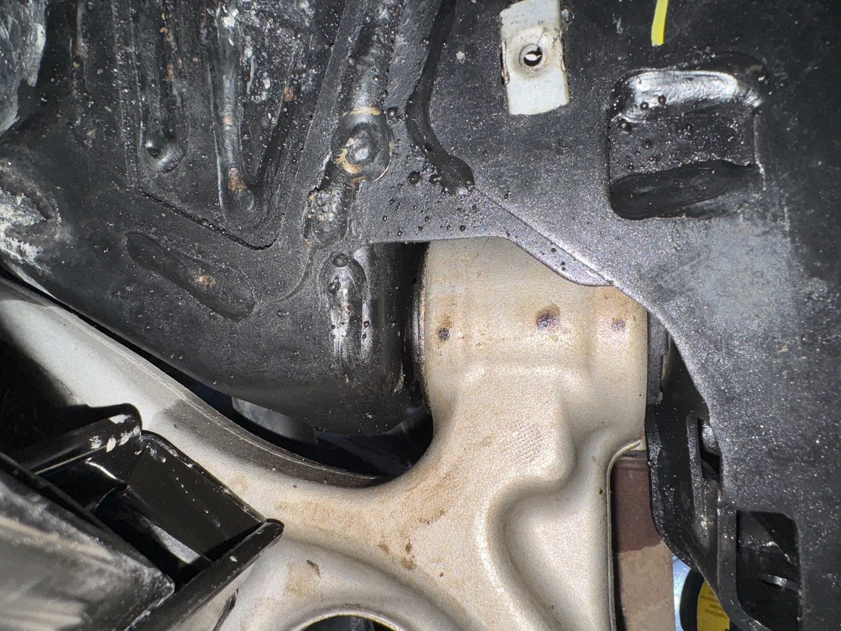

you are talking about a Bushing, not a berring ... right?
I had to do this in my fusion, but you are going to have to undo that end of the subfram so it drops a bit and gives you access

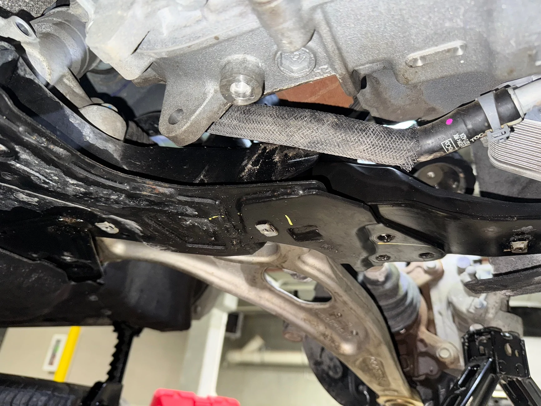

See if this helps (from 2022 Service Manual). Cheers!
wow, okay, that where I figured the direction I need to be going. The front

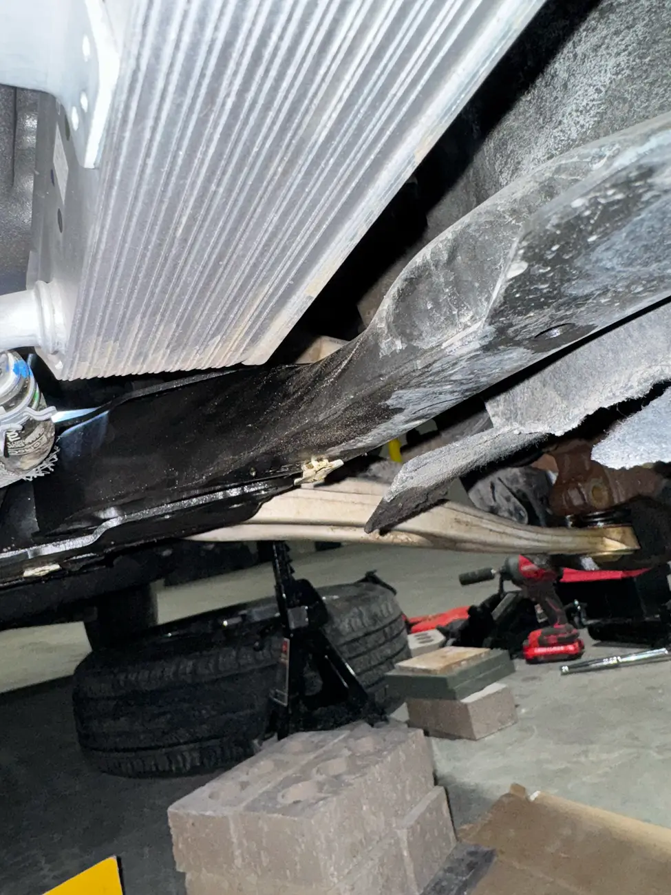

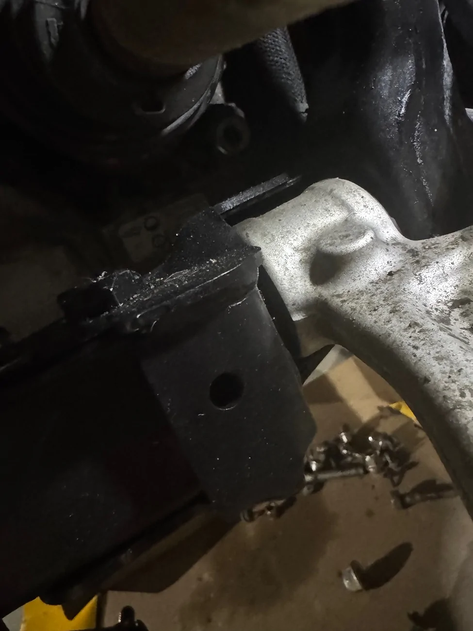

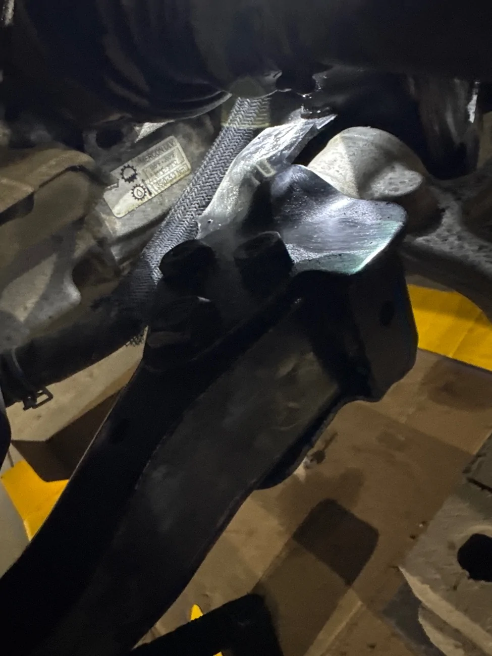

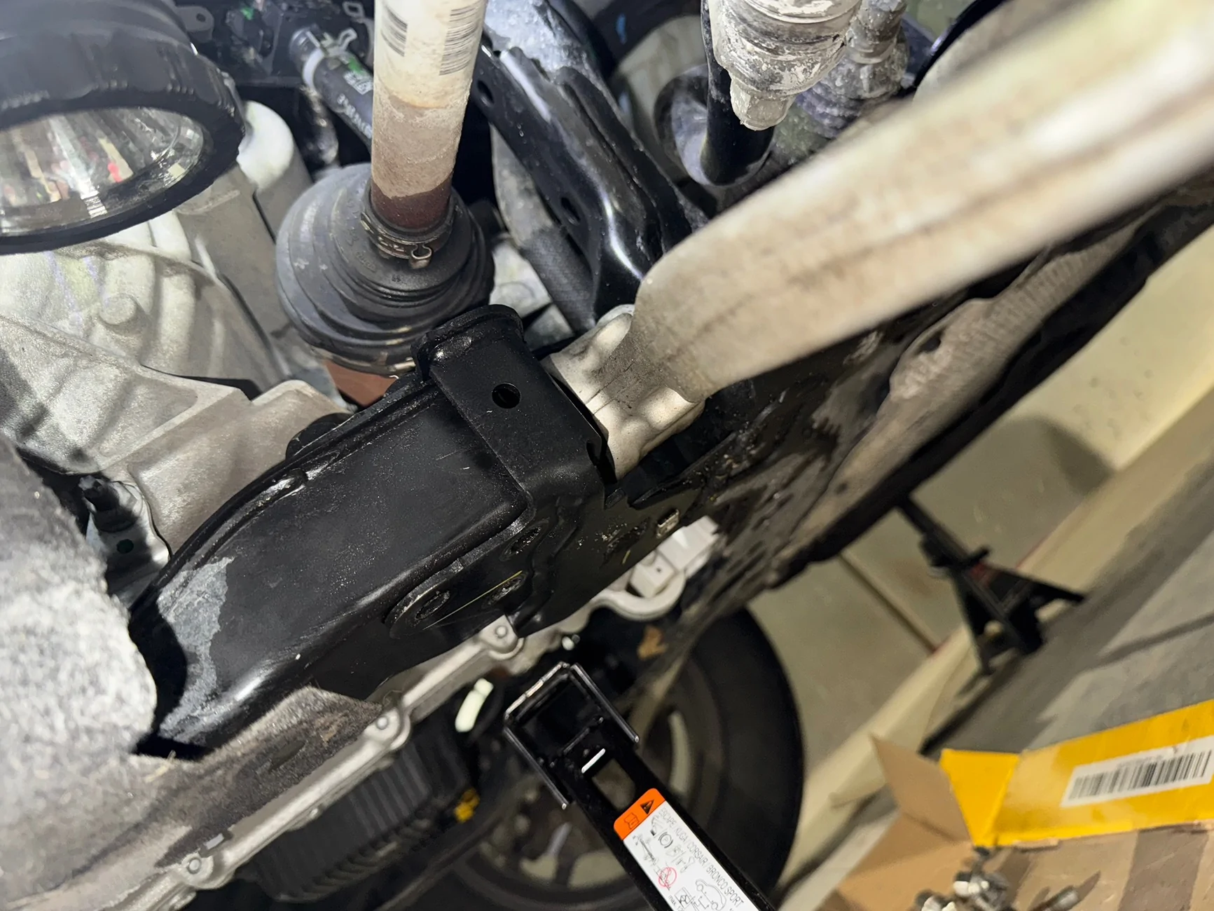

wow thank you so much for going this in depth with my situation. Appreciate it brother. I have the WSM and the section of removing/install front control arm. To keep It short. Im basically disassemble my front bumper and dropping the subframe. However, the bolts that are unthreaded will need to be discarded and replaced.
It's been a while since I posted this and during that I found a video on YouTube that shows HRG installing a lift kit on bronco sport. In this video they remove the cross member bar that connects to opposite end of the from lower subframe extension arm. I think by removing that I will have more room.

I am replacing the whole control arm. And no worries about the WSM I already own one. Im just very surprised that it takes an extensive dissaseble to replace that cruise part of suspension.
ya I had to stare at it like I was dumb for about 20 min when I replaced the front suspension in my fusion, in the end I had to pull the front subframe connector bar out which was 6 bolts for the rear of the subframe, then I marked the location at each of the 4 main mounting bolts, took the rear ones out and losened the front ones and that allowed the rear to drop about 2 to 3 inches which allowed me to take the lower control arms out and replace them. then I took it for an alignment after I put it all back togeather.
RSH
1,297
1,844
How do you know the control arm rear bushing is bad, did you take it in for an alignment after your curb incident and that was the diagnosis.
Unfortunately there is some extra disassembly compared to an Escape that needs to be done to get to the front bolts of the control arms on the Sport and if having to basically lay on the ground to perform this task adds to the frustration. Good luck with your endeavour, hope you get it fixed soon.
dirtygrunt
dirtygrunt
Smokywater24!
Dec 3, 2025
2024 Bronco Sport
yes, I went first to get a diagnosis and they concluded the tire rod (inner/outer), lower control arm, sway bar, sway bar link, and inner steering rod need to be replace.
I have the WSM for the Ford Bronco Sport and for suspension and alignment they recommend just replacing all these components. I won't go into depth why but I can see why they sent me invoice fro 2,000 dollars in parts alone. I checked those parts and they are charging me like way past MSRP.
RSH
1,297
1,844
Sounds like you need to rebuild one side of your Sports front suspension.
Even though you can buy Ford parts online at a decent discount, If getting your vehicle repaired at a Ford dealer they will charge full retail for parts as you have found out
Now you have a not much fun holiday project.
dirtygrunt
dirtygrunt
Smokywater24!
Dec 3, 2025
2024 Bronco Sport
you're telling me brother 😂. ugh it is what it is ! will update how it went down !
