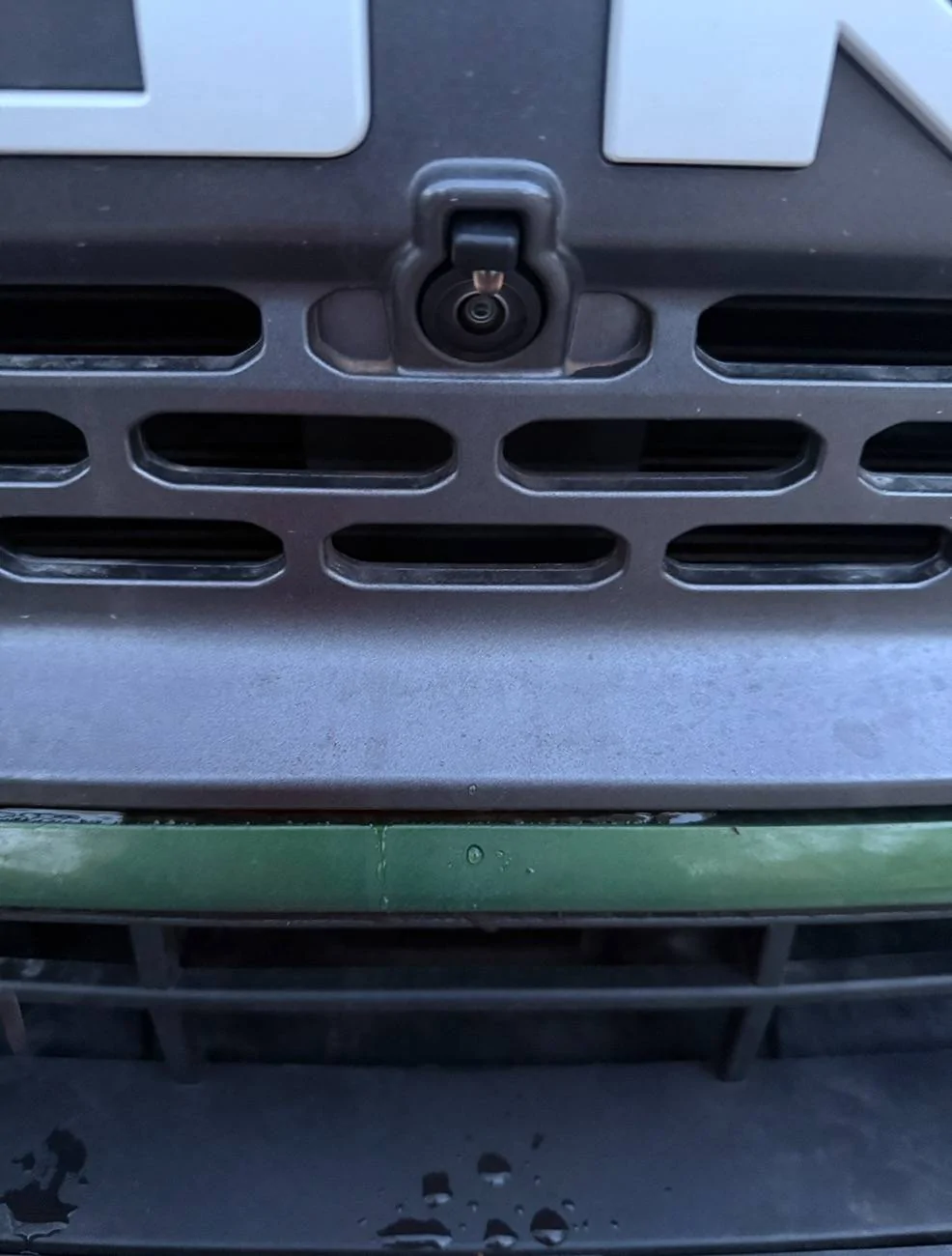

Took my Bronco in today since it is still well under warranty and the technician changed a washer. Had it home for mere minutes and it is leaking again. Went from leaking orange fluid before the repair and now blue fluid. Will be calling again tomorrow. Would hate to not have fluid when needed. This could definitely become a safety issue.

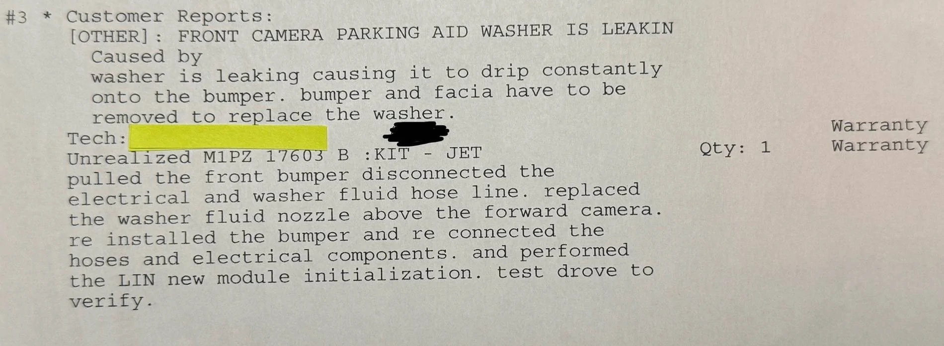

This was the report in case you want to know what might not work. The tech also mentioned the RainX fluid, which he thought was problematic. What does everyone else use? That just happened to be in our garage…
Ford Bronco Sport My 2021 Bronco sport leaks washer fluid from the front camera even when im not using the washer fluid IMG_0116
Yep, looks like just the camera assembly, that won’t solve it. I’m still heavily suspect there’s a check valve in the line and not the camera sprayer itself, given how the fix here works and remains to work. I’m sure the rainX fluid isn’t that big of a deal

Took it in again for fix #2 and what ever they did it had no effect on the problem. As soon as they dropped it off I parked in my normal spot and turned on the spray and it continued to drip until this morning. Again I parked front down on a 4 degree incline (driveway) since it is easier to back in to the driveway between my teens car and the garage. I would expect a potential off road vehicle to function while parked on a hill.
