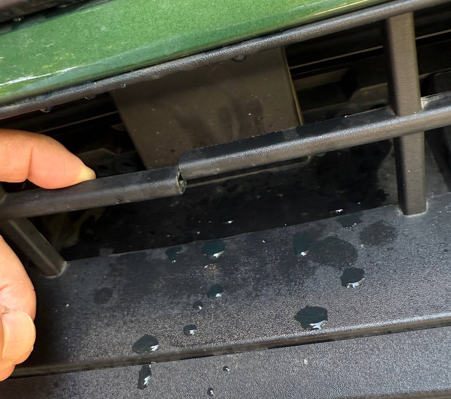

Final fix (cross your fingers). So far so good, tried it out and no leak so far.
Ford picked up my Bronco today and fixed it after I asked if there were technician notes on how to fix this problem. They got back to me and said their service technician got a fix from Ford. Here what was done this time. My car was returned with a broken grill. A nice slice straight through. Called immediately about this since I want to drive it without being blamed for the damage.
