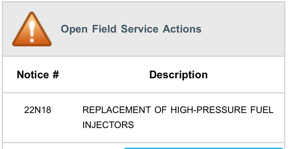

Really Ford. Fix the bad injectors. The band aid is the best you can do?
Ford says in documents filed with U.S. safety regulators that fuel injectors can crack, and gasoline or vapor can accumulate near ignition sources, possibly touching off fires.
Dealers will install a tube to let gasoline flow away from hot surfaces to the ground below the vehicle. They'll also update engine control software to detect a pressure drop in the fuel injection system. If that happens, the software will disable the high-pressure fuel pump, reduce engine power and cut temperatures in the engine compartment, according to documents posted Wednesday on the National Highway Traffic Safety Administration website.
After they put that drain tube on my BS, they are replacing the fuel injectors via a new fsa. Still waiting for parts.

Well I don’t have the statistics but it’s reported to be rare for a fuel injector to crack and it would *seem* like replacing all 3 injectors then having one of those replaced injectors crack and leak fuel would be even more rare? Again I have no data on this.
I agree but it happens due to a faulty part. Has Ford updated the part like they did with the water pump?

This is all covered on other posts … no one except Ford can answer your question. It’s a different part #, that’s all that is commonly known
So there's a chance the part is better. :)
johnardsg
johnard
May 10, 2021
317
302
Texas (previously from PNW)
2021 BS BigBend/2011 v6 Rav4
According to 22N18, you are correct
What?! Why not? That just means that the replacements are still below quality/expectation.
I remember my rav4 water pump getting replaced under recall and then 2years down the road i had to replace it again and pay for it. I was thinking maybe the replacement pump was from a recall category too. Dang
