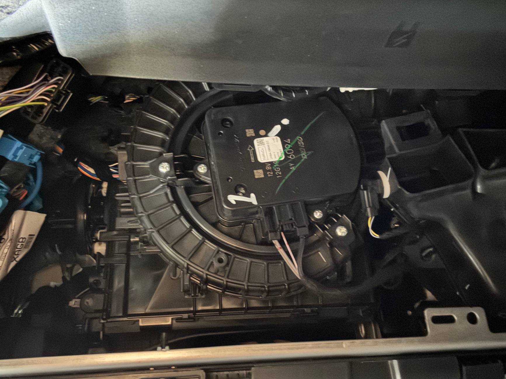

Itā€™s quite common to be missing and Ford put out a notice that itā€™s no longer replaced free under warranty
mine was replaced under warranty for ā€˜22 Badlands
hereā€™s the part #, itā€™s online but I didnā€™t check availability. Here is one of many links. The part # you posted is different than mine.
https://ford.oempartsonline.com/oem-parts/ford-lower-plate-m1pz78046a25aa
Fuse panel cover, interior, passenger side:
Instrument Panel Cover Passenger Side
M1PZ-78046A25-AA
Dash Panel Insulator, Part #: 78046A25
One piece component

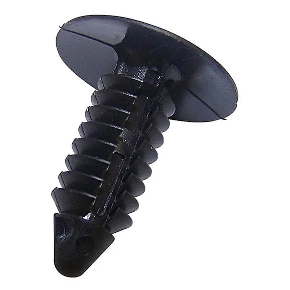

Two slide in tabs (closest to firewall)
One positioning pin (inboard side closest to passenger) Two push clips (inboard side closest to passenger)
Installation: slide in, position pin and press expansion clip upwards

That's a totally different part than the one on the floor, just above the edge of the floor liners, just ahead of the passengers feet.
