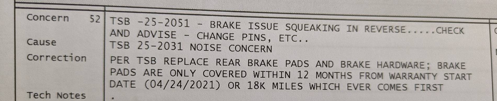

I tried to have TSB # 25-2051 done and the dealer said it wasn't covered. My sport is out of factory warranty but I have a valid ESP and a premium maintenance plan.
Has anyone else run into this?
Ford Bronco Sport Make it Make Sense - TSB for Brake Moan Noise in Reverse PXL_20250403_154329425
Several owners posted similar experience and Banjo Billy (see Post #19) said (prior) TSB 24-2348 states the Ford ESP covers that TSB:

I updated to ceramic pads and slotted rotors on the rear about a year ago. I also had the mechanic install the Ford Bushing Kit (1st interation) that was was supposed to eliminate the moan. The update worked for a couple of weeks but it returned slowly, as of yeaterday morning the moan was as bad as it was before I did the update. Yesterday afternoon I had my 3 year brake fluid flush done, I asked the mechanic to clean the rear assembly with brake cleaner to at least get a few days, hopefully weeks of quiet reversing first thing in the morning. It worked this morning but the moan will return for sure. The good thing is ceramic pads generate half the dust of the OEM pads and its easier to clean off the wheels but switching to ceramic pads did not eliminate the moan. If you find a permanent solution better than mine lets us know, that dreaded moan is the only thing I don not like about my BS, other than that it's been a great little SUV.
