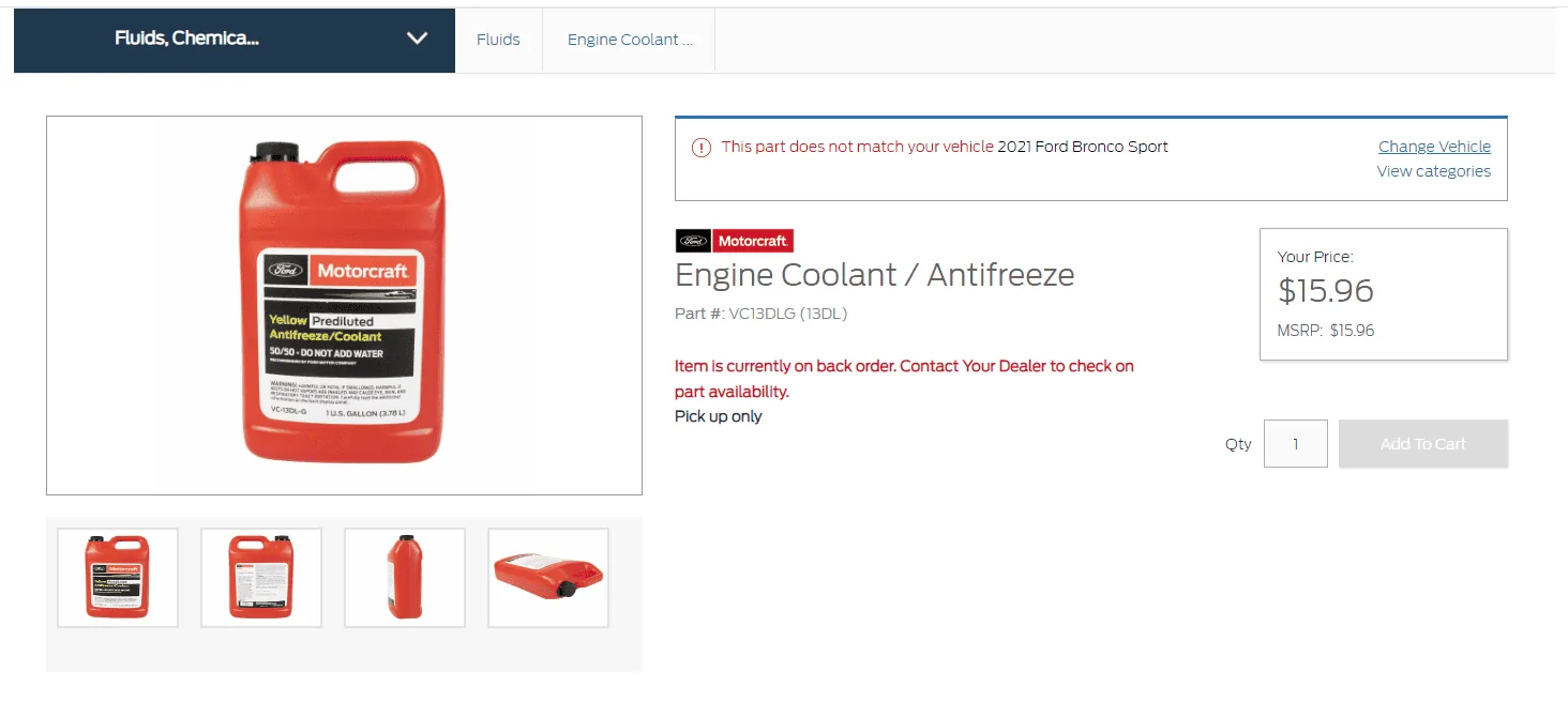

Well, I've come full circle on this one, getting the Sport ready for Fall. My overflow is down maybe 1/4" of coolant but still above the Min mark. I'll probably change the oil before the cold hits and want to top off everything else. So I'm back to trying to find the coolant for the vehicle. Ford's website is absolutely gaslighting me with this. I can't even find this page by going through the usual search. I had to find it on Google and then go to the page:
Ford Bronco Sport Losing Coolant Captur
The BOOK says VC-13DL-G is the coolant for the 2.0. This part right here ^ , which is backordered anyhow. The parts stores and the Big Rainforest want over $30 for a jug. No thank you! I'm about to take the distilled water that I have on hand and just top it off.
Ford Bronco Sport Losing Coolant 1663384493524

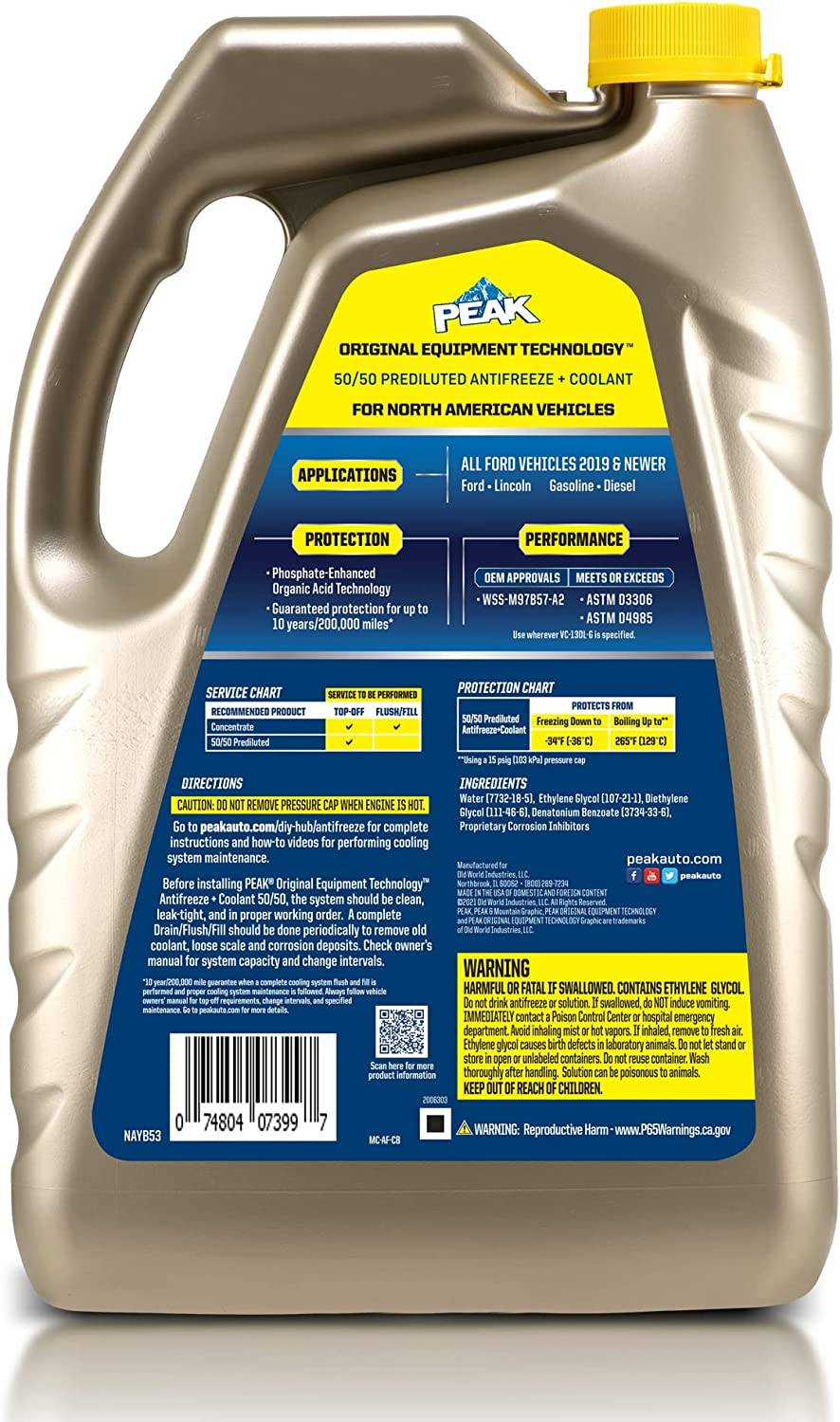

I would stick with the 50/50 mix like the owners manual says. You don't have to use Motorcraft VC-13DL-G, you just have to make sure whatever you use meets Ford's WSS-M97B57-A2 spec. Take a trip on over to your local Wally-world or auto parts store and find the 50/50 yellow stuff. Look at the back of the jug to find out what spec the product meets. For example, Peak's OET Extended Life Yellow is specifically marketed for newer Ford vehicles. Here's the label on the back:
Ford Bronco Sport Losing Coolant 81l67RgytQL._AC_SL1500_
