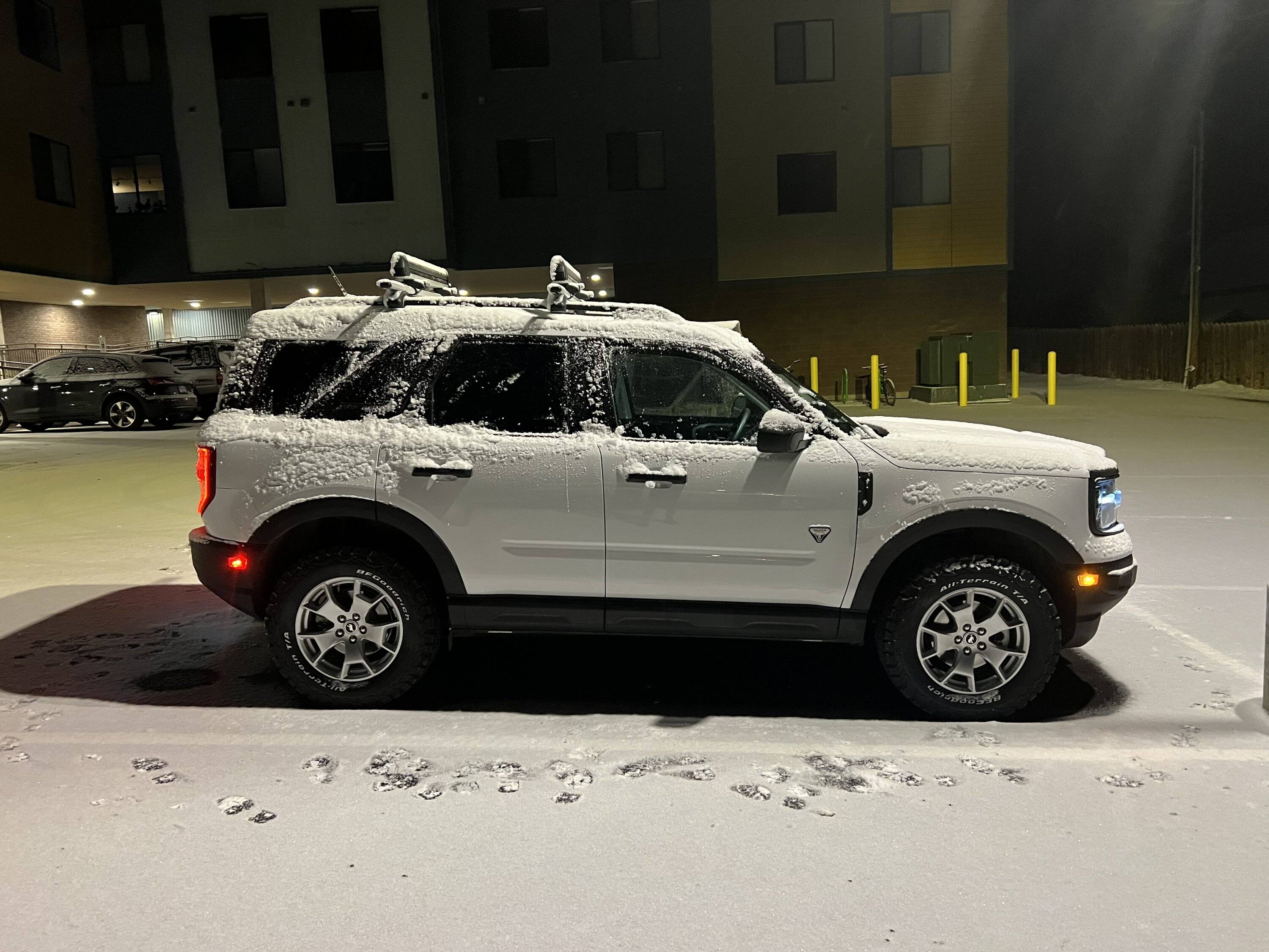

First post here—but I’ve been on the site since purchasing my Base sport back in 2021. I’ve been running the 1.5” HRG lift for about 6 months now with 245/65/17 BFGs, though the appearance is better than stock, it still doesn’t have the lifted look I was hoping for. Falling down multiple rabbit holes, and even reached out to HRG and got news that a 2.5” kit is in the works for the lower trim levels. As much as I’d love to buy the Flatout Suspension kit, I cannot justify spending that kind of money for a soft-roader. Does anyone know, or has anyone replaced the struts or springs on their Bronco with a spacer lift? Are any of the strut/spring kits compatible with spacers?
Here’s my rig—many more mods to come this spring!
