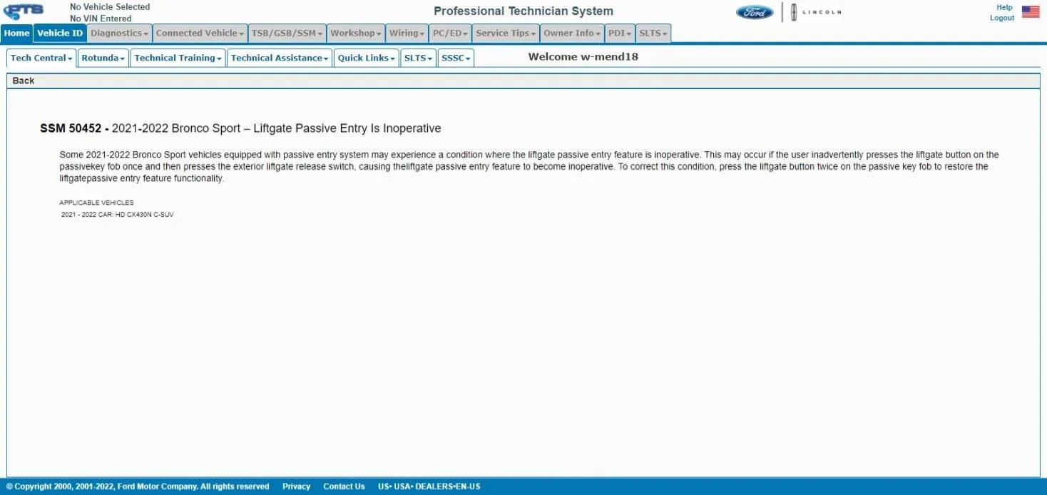

I developed this condition recently and of course, the double liftgate tap immediately fixed it.
I also think I know what causes it. I very, very rarely use remote start. But I did attempt to recently, and when I did, I double tapped the liftgate button instead of the remote start button since they are right next to each other. That's when my IA stopped working. I don't know of a good reason you'd want the IA disabled on the liftgate, but it seems like you can intentionally cause the condition if you wanted to.
