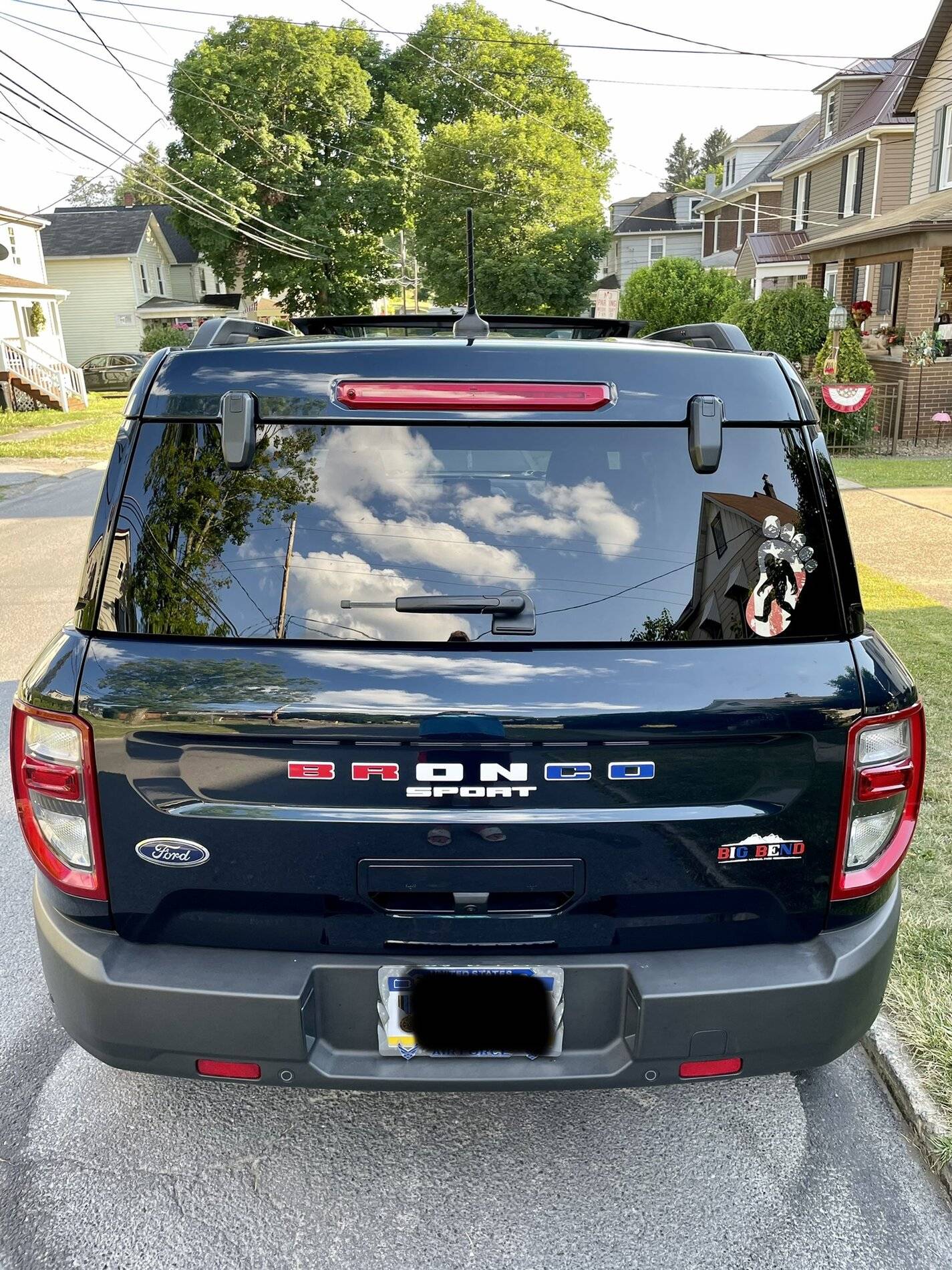

Ah, I'm sad I'm late to this party. I've had the same ideas from the beginning and completed it over last weekend. Any questions feel free. It's really easy. And I used Hyperdip for the letters and emblem and a carbon fiber inlay.

Ah, I'm sad I'm late to this party. I've had the same ideas from the beginning and completed it over last weekend. Any questions feel free. It's really easy. And I used Hyperdip for the letters and emblem and a carbon fiber inlay for the Ford badge. Sport delete takes about 15-30 mins depending on your experience level.

It's really easy. Pick a hot day, (hotter the better) take 3 pieces of dental floss, braid them together, wear gloves cause it'll cut into your skin, wrapped them up into your hands so you have a good grip, insert floss into just, the edge of the letter, and in sawing motion cut through the adhesive foam on the back and just keep going until the letter is dangling and then pull it away from the paint. You will never come close to your paint since you're sawing as close to the edge of the letters as possible. Not that the floss would hurt it anyway. I discovered halfway through that I could cut down the amount of time it took for me to peel away the excess adhesive foam if I saw 90% the way through and then just gently pull off MOST from the vehicle. Remember, if it's hot out the adhesive will WANT to come off so it'll take very little effort. After your done picking off the majority of the foam adhesive with your fingers, simply apply your favorite anti-adhesion product like goo gone on a microfiber towel, (I used rubbing alcohol then rinsed with water after) and gently wipe away any little glue pieces left and then buff dry with microfiber and you're done! No damage whatsoever and much cleaner look. Probably took me about 15 mins? Maybe 30? I can't remember. It was quick and easy. Just watched people do it on YouTube till I was comfortable.
