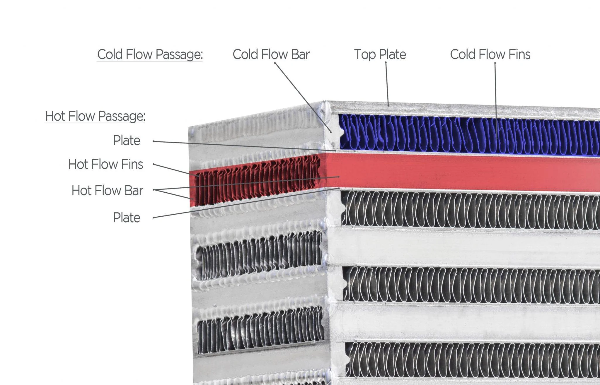

An intercooler core isn't an empty pipe, it's filled with cooling fins. In the pic below hot, pressurized air coming from the compressor flows through the red area while cooling air flows through the blue area. It's not just empty space the hot air flows through.

When you increase the size of an intercooler you are not just making the air passages bigger--that would not increase cooling capacity. The whole point of a larger intercooler is to increase the amount of internal surface area exposed to hot, compressed air, because that's how you increase heat transfer. Every surface inside the intercooler the air must flow around has it's own boundary layer, that is a layer of air that is NOT moving. The more internal surface area the more volume of air that is not moving. This is why all other things being equal, a larger intercooler with have greater pressure drop. Google "intercooler size vs pressure drop" for more information.
There ARE different internal arrangements for intercoolers, and some are better than others--depending on how you define "better." Some provide for better flow (less internal surface area), while others provide for more efficient heat transfer (more internal surface area). If you have a massive turbo putting out gobs of boost and you're nowhere near the limits of the turbine output, then you can afford to lose pressure in the intercooler. The more boost the more heat, and at a certain point heat management must be prioritized over pressure loss, so you slap on the biggest, most efficient (heat transfer-wise) intercooler possible, pressure-loss be damned. But if you have an appropriately sized turbo running close to its limits producing light to moderate boost, you're better off using an intercooler that provides the necessary heat management with the LEAST pressure loss.

Because of boundary layer effects, you can’t just compare the cross sectional area of the openings. Even if you change the shape of a round pipe, you will increase the pressure drop. So, if you were to take a round pipe and make it an oval (all while maintaining the cross sectional area) the oval would have more pressure drop. In the intercooler, there are lots of small passages. The cross sectional area of all those passages summed together would be much higher than the charge pipe cross sectional area. The larger intercooler would have even more cross sectional flow area.

Okay, so maybe my description of the intercooler as “bigger” needs some qualifiers. To me, bigger would mean more internal cross sectional area. However, it would be possible to produce an intercooler that had the same internal cross sectional area but longer flow paths. This would technically be a larger intercooler that has more pressure drop than the stock intercooler. I don’t think I have ever seen an upgraded intercooler that wasn’t thicker than the stock unit but it could be done if there is room for a wider intercooler. The increase in thickness leads to an increase in internal cross sectional area.
