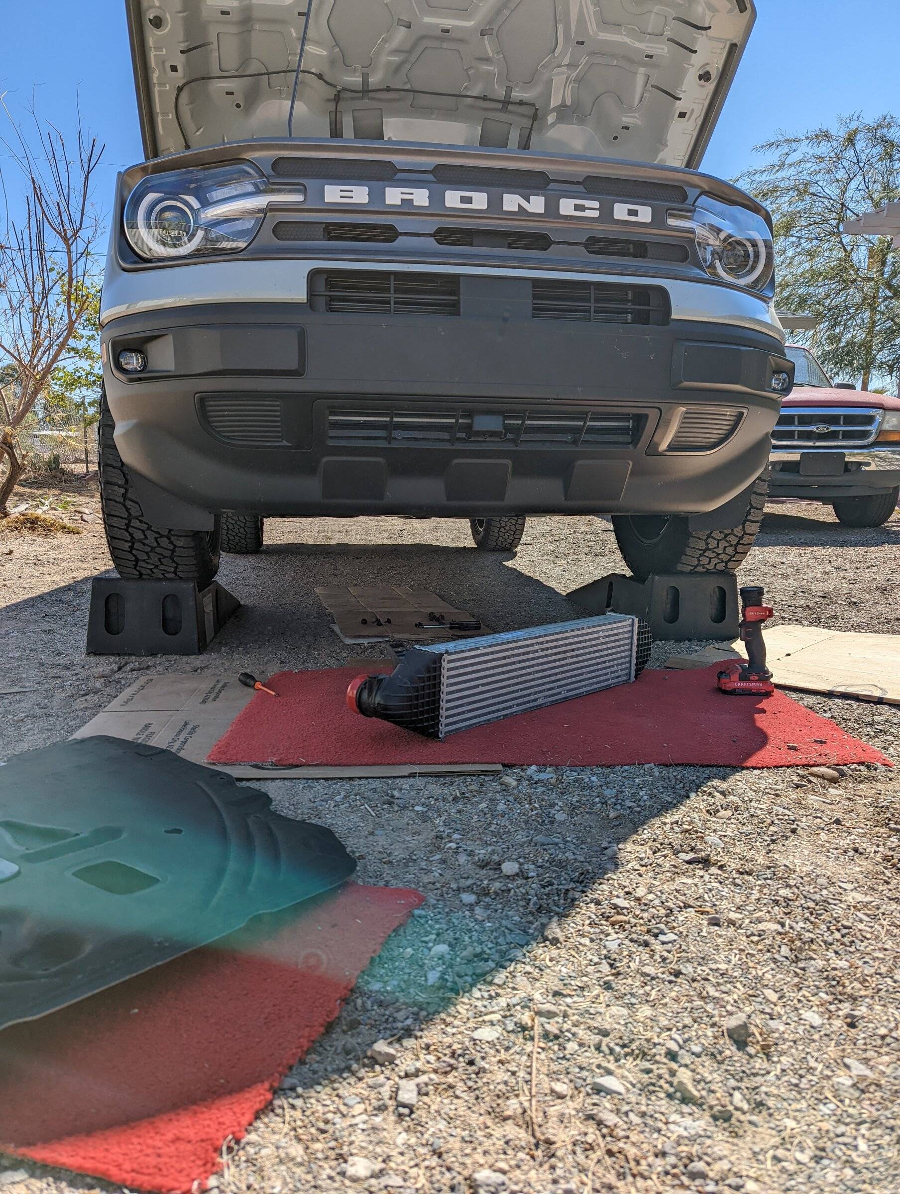

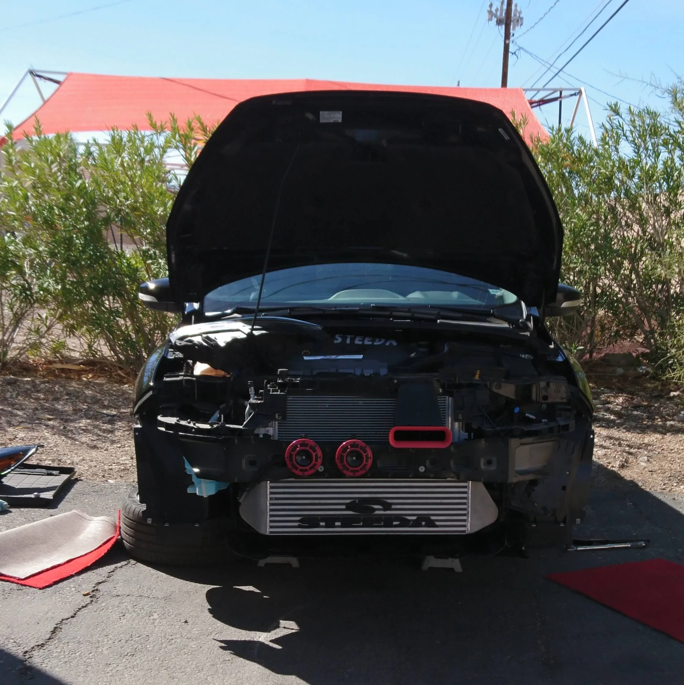

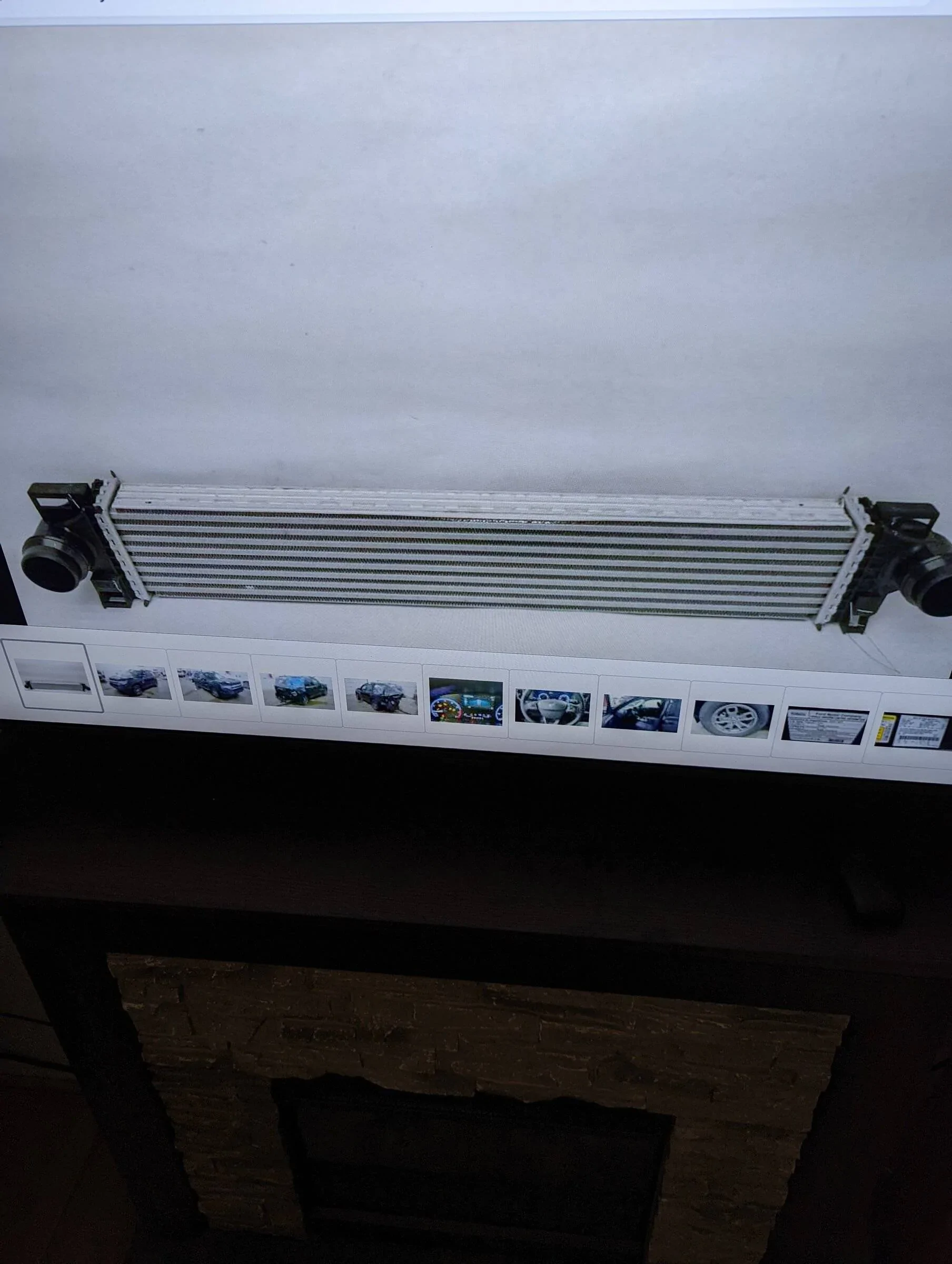

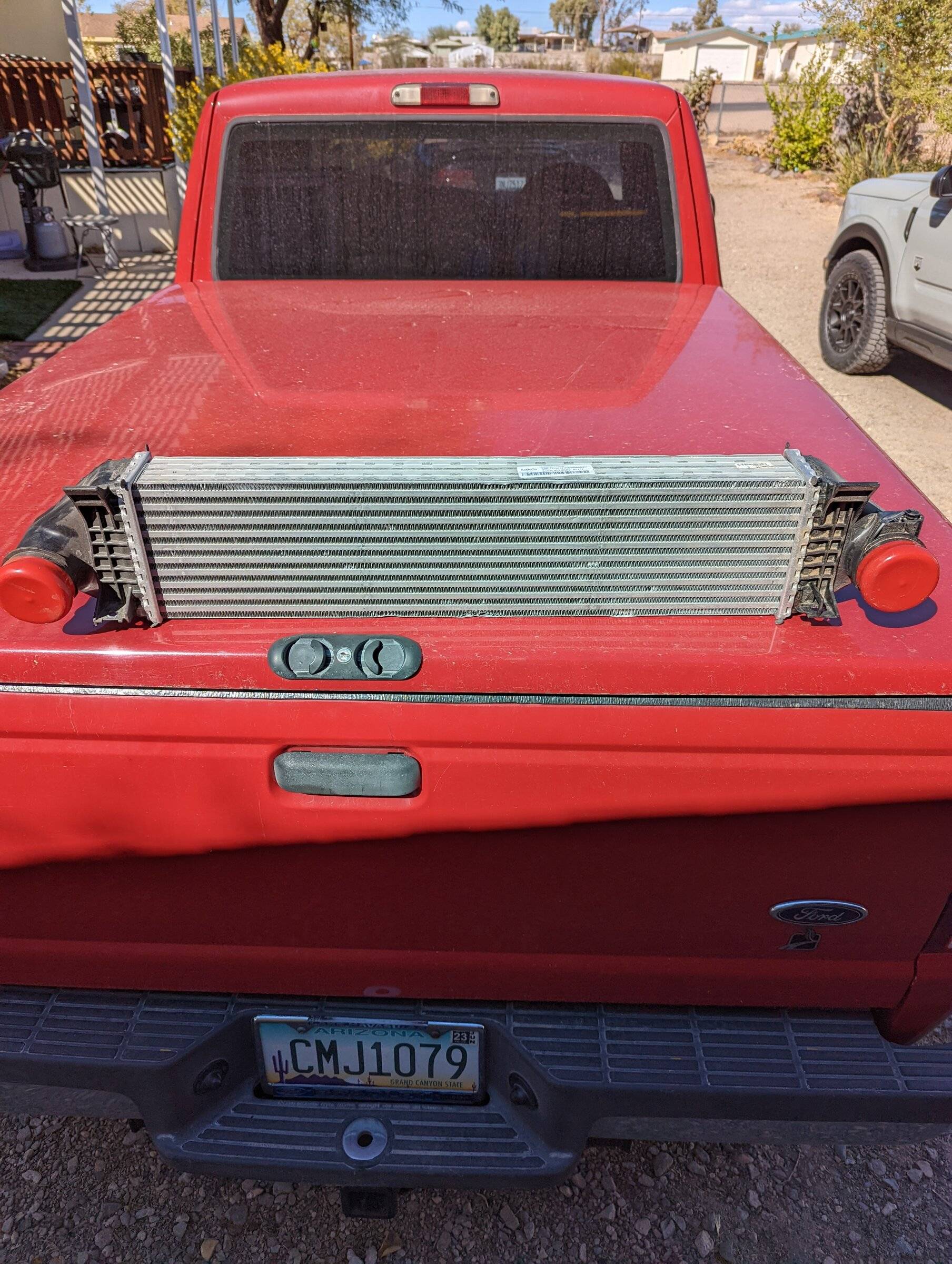

I put my BS on ramps to look underneath for future maintenance. While grabbing my ramps I ran across my ic out of my ST which really grabbed my attention. It had barely 4k on it when replaced with a steeda. After dropping the felt pan I still couldn't see the ic. I could get some measurements. The inlet and outlet are the same width. I looked up a pic of the oem ic. The end tanks are a little different. The mounting looks very close, a little bracket for the top mount. The st one is taller and appears a little thicker. Next weekend maybe I'll take off the bumper cover and see if I can make it work and if it is bigger.
