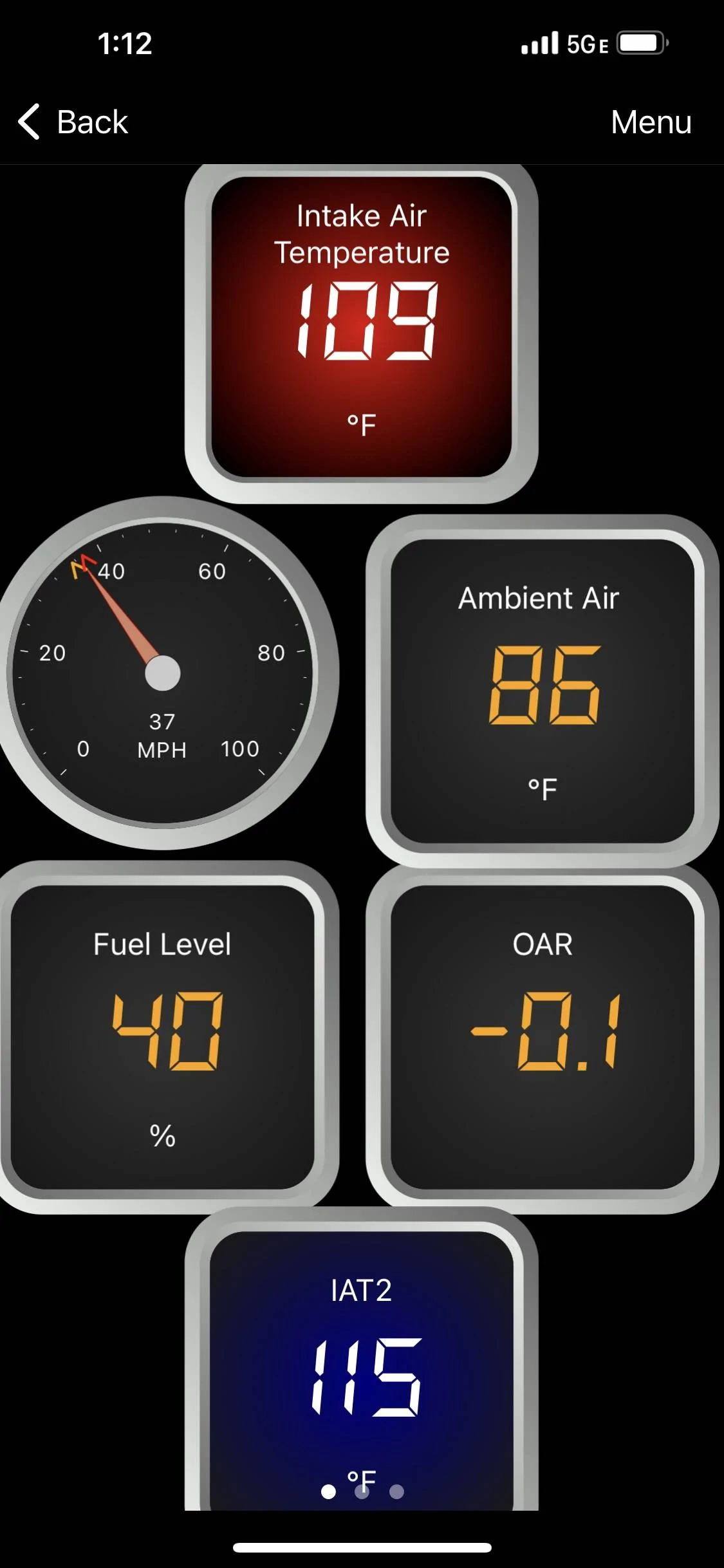

Have been taking various datalog trips in the mid day heat. At this point, its simply to collect other data for my possible catchcan install. I didn't bother snapping my phone for the screenshot, but the charge temp was ONE DEGREE over IAT as I pulled back into my house.
ONE. DEGREE. ....over the temperature of the air being read at the nose of the intake.

Someone else on the board was going to upgrade the intercooler, this was for a 1.5. I didn't really follow the thread to see what the outcome was.
https://www.broncosportforum.com/forum/threads/intercooler-project.5252/#post-103048
There are a handful of custom intercoolers for the 1.5. This thread was about an intercooler upgrade for the 2.0.
The deduction is: NOT NEEDED.
The IAT2 characteristics may be different on the 1.5, much like I found them to be on the 2.3.
I may have miss it in your data but what was the temperature of the air at the nose of the intake ?
It’s the IAT reading. It corresponds to the sensor that clips into the air intake right where the airbox meets the tube. The “nose of the car” might be a loose description.
