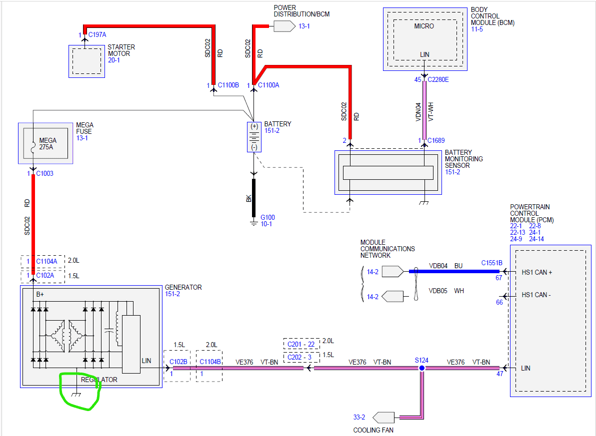

So it’s 12:21pm. The temp outside is 70degrees. The Bronco has not been driven for 2 days. I walk out to get in it, and the LED lights fans are on. WTF? A few weeks ago I got a brand new battery from my local dealer because the old battery could not keep a charge, and I would have to jump start it. They said the charging system had a “bad ground”. So that ruined the battery? I don’t think so. I suspect parasitic drain.
There's no way to know of course, but it could have been a bad ground. There have been several reports of the ground/neg(-) cable connection on the fender being loose.
Or, perhaps more likely, they may have meant the alternator (what they call the generator). See lower left, circled in GREEN:
Ford Bronco Sport Interesting fact about the Bronco Sports LED Headlights if you didn't know already!! 1709670493292
The battery and its ground cable are shown above as well, labeled "G100 -- 10-1"
It is shown here, in this photo:
Ford Bronco Sport Interesting fact about the Bronco Sports LED Headlights if you didn't know already!! 1709670742434
I'm not saying that it was not the headlight cooling fans or some other load that killed the battery -- it may have been -- just that a bad ground is a possible culprit.
Parasitic loads are definitely a problem with the BS -- in fact, I have a Battery Tender (BT) connected to our BS BL as I type this. It's going on 2 years old, and the battery (FLA not AGM) is doing OK, but that's not saying much.
The battery in our '97 RAV4 is eight (8) years old and still holding a decent charge (it settles at about 12.3V or 70% SOC). I use a BT on it (and all of our vehicles).
Thanks for the info. The “bad battery” not being charged properly, and causing it to fail, is what I was suspicious of. I failed to mention that, after leaving the dealer service with the the new battery installed, the car had a charging error not 10 minutes after leaving. I immediately took it back. After diagnosing the problem, that’s when they told me the problem was a “grounding” issue. Regardless, I think I’ll keep a trickle charger on it, like you. I’m already used to packing a digital Jump Starter. Cheers!
