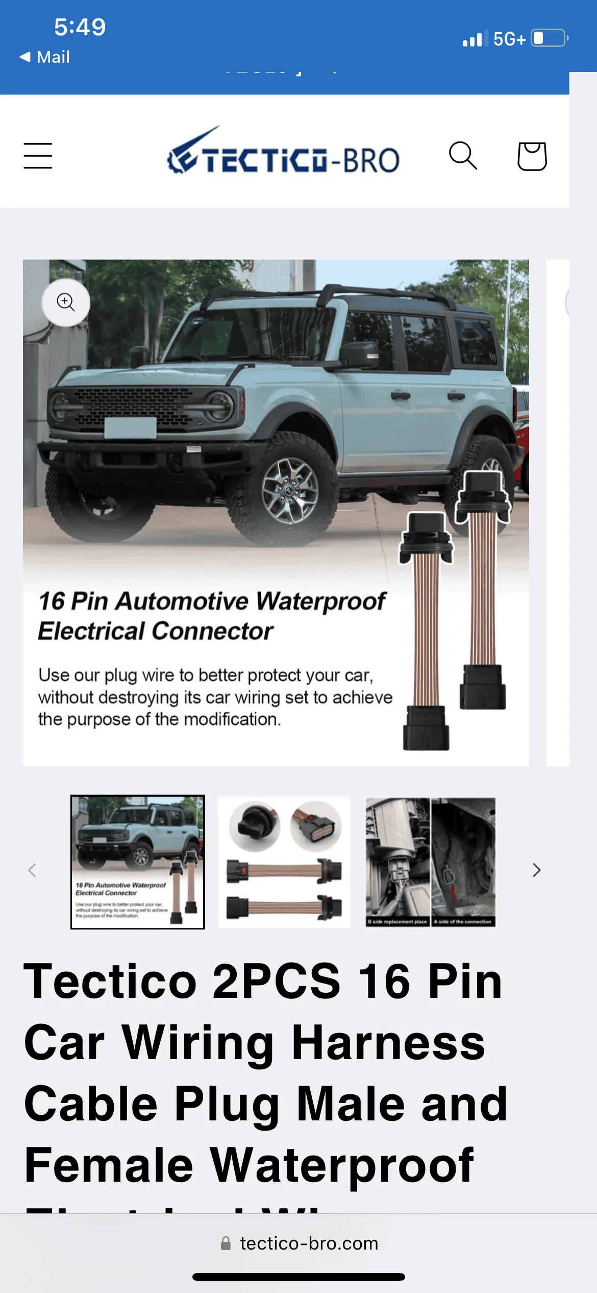

For those contemplating installing the side marker lights and do not want to splice stock wiring, I came across this product now available. Hopefully it does the trick. I’ll keep everyone posted. I did confirm it works for both Bronco and Bronco Sport as the stock pic shows a full bronco.

Ah. Thank you. I see that. Very helpful
2,493
3,710
As was your post. The more this gets out, the better the installs of this side marker become more professional. Some on the other thread are bad; wires dangling around the engine compartment, and poor wire splices. This can lead to electrical issues (shorts).

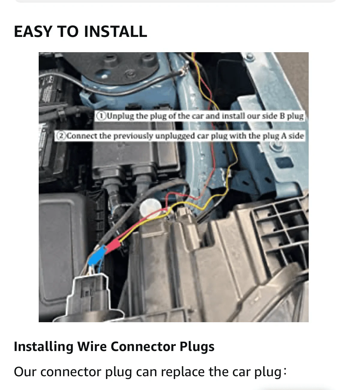

Wires dangling? Bad install? Lol the directions to do exactly that are right there on the Tectico product page (this pic is from their Amazon product). Probably could use a better pic.
Their turn signal product could have been specifically tailored as a turn signal only product with an added connector already installed for the turn signal and ground wires making for a reliable connection. That would make it so no wiring needs to be spliced.
